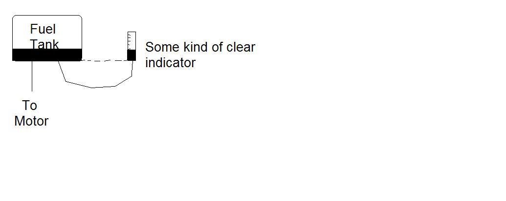

Is there a fuel gauge that I could put on the tractor? What about some type of gauge like the drawing attached?? (Sorry just a quick drawing in paint.)
Sorry if it doesn't make sense.
Anyway, thanks for the help!

A fuel gauge 'Cap' style is available...believe I've seen them at LMTC and Hoye tractors.
