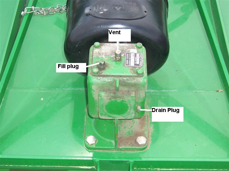

My LX6 sits outside (uncovered) and has no sign of water in the oil.
If the picture attached properly, you can see my cutter is slightly over-filled and blows a little oil out the vent when running. But it'd be tough for water to infiltrate the gearbox when everything is properly installed/sealed.

Well isn't that a cute little gear box.
Here's a thought for a water cover you could install. Go to the local 5 and dime store and buy a little 1/4 cup cooking measuring cup with a handle. Drill a hole in the handle, remove one of the top mounting bolts and reinstall it through the hole you drilled in the handle. You now have a rain cap for the breather. You could also run a good bead of silicone around the top access plate to ensure it is sealed good.
   / Milky gear oil in JD LX6 #10
It is surely getting water in it by what you describe. First, you must figure out how to drain it completely. Tilt the mower, hoist it up, remove the gearbox, whatever you have to do. Get it all out. Then find the water entrance. From the photo, I would suspect the flat plate cover has a gasket under it. Replace it and RTV it in place. RTV or pipe dope all plugs and any other entrances. Check the shaft seals. They can't cost much. Then refill it with gear oil , run it an hour, and drain it again COMPLETLY. There may still be traces of water in it. Repeat again untill it is only oil. Next, find a lean-to to store it under, or throw a pail over it with a big rock to hold the pail down. Even a canvas could help a lot. If you don't deal with it, the water will cause rust and then the wear will accelerate wildly. Soon it will be REAL noisey when it runs. Good luck.
