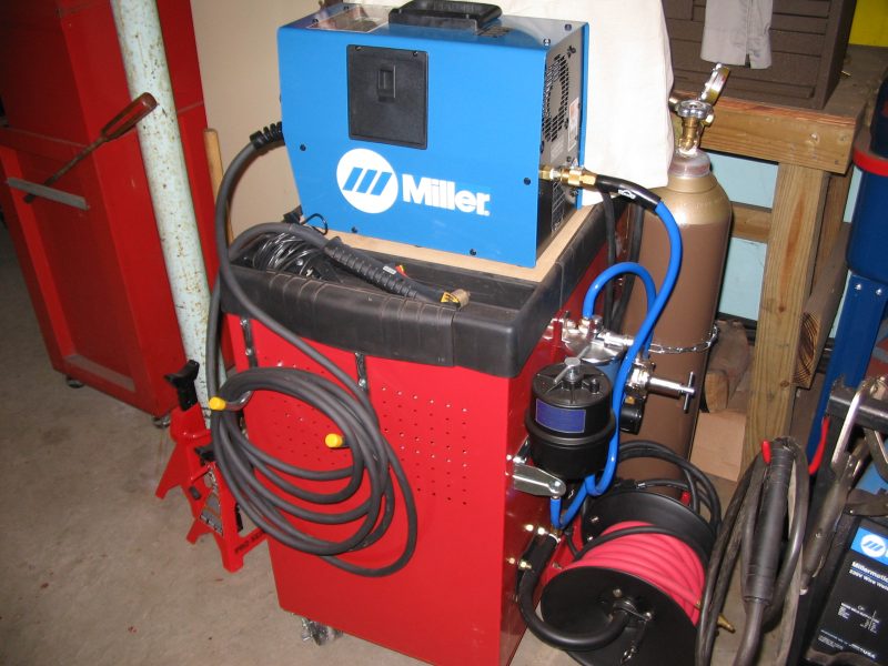

On the subject of "clean,dry air" get yourself a Motor Guard air filter and put it inline between your plasma cutter and your male or female fitting you connect your air line to.
Motor Guard filters use a dessicant cartridge to remove air borne moisture and oil. When the dessicant cartridge gets used up, a roll of common toilet paper does the job just as well much, much cheaper. /forums/images/graemlins/grin.gif /forums/images/graemlins/grin.gif
I have the filter mounted right on the back of my plasma cutter.
   / Miller 210 MIG or Miller PLASMA 625 #6
Yep, I have a MotorGuard connected right to the plasma cutter, then back to another filter/regulator, then back to the main line filter/regulator/water seperator and then back to the compressor. Some people also have a stand alone dryer in there too but for the occasional use the MotorGuard should work just fine.

I never knew what a MotorGuard filter was until the fellow at the auto parts store uptown told me he used one when he painted his antique cars. Maybe they aren't as good as a refrigerated air dryer but for point of use application they can't be beat. Besides, every household has a few rolls of toilet paper always laying around.
I don't think, however, that I'd want to return the roll to my wife for household use after it came out of the cannister. /forums/images/graemlins/smirk.gif /forums/images/graemlins/smirk.gif
