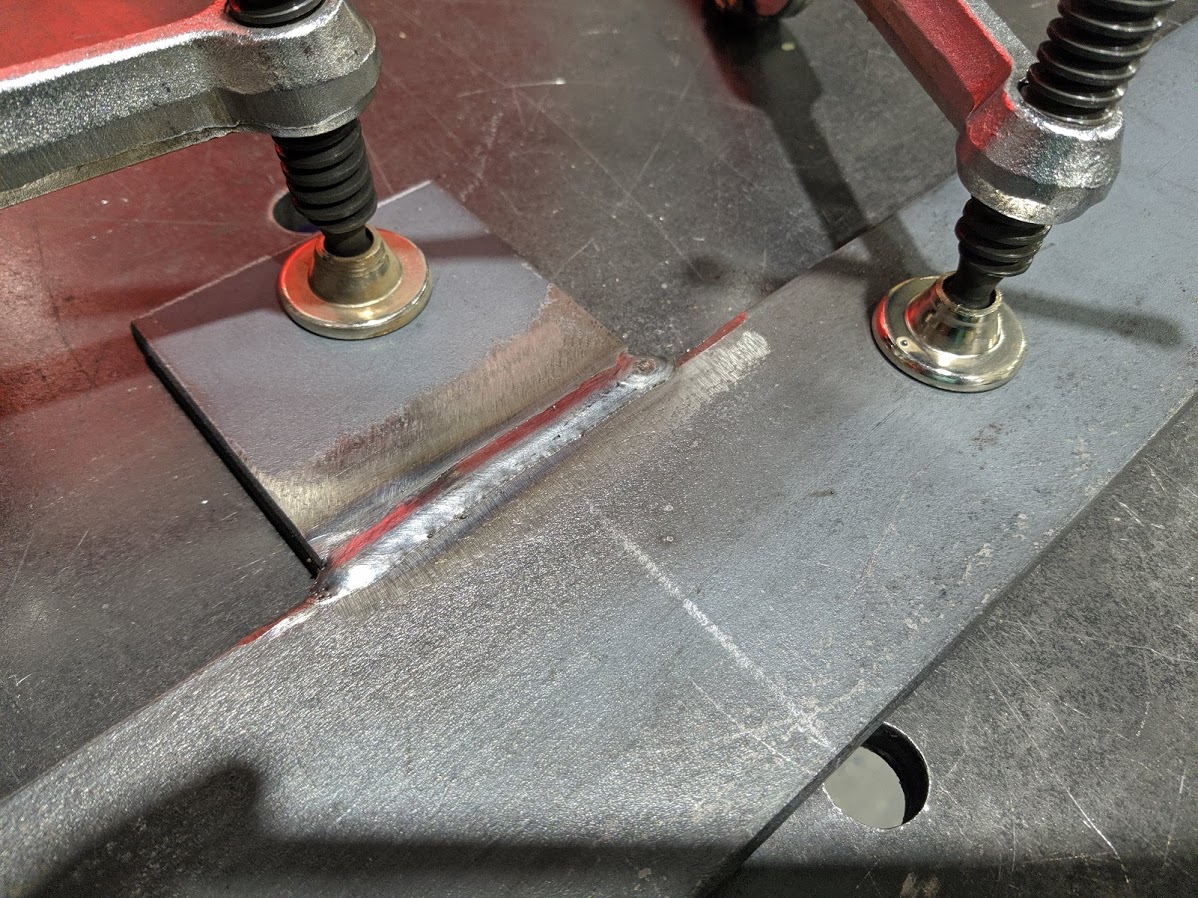

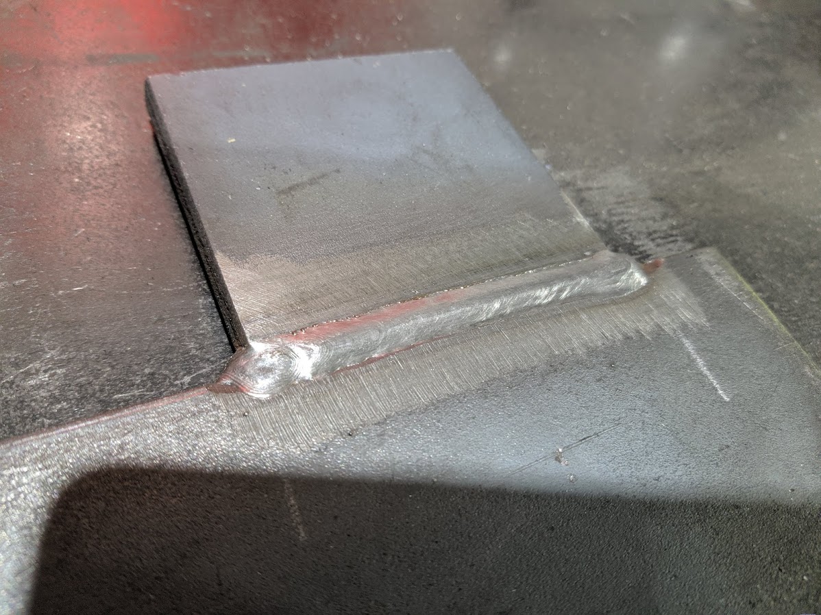

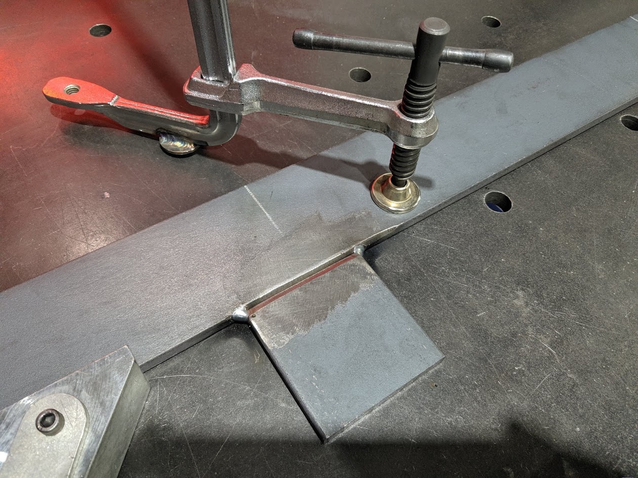

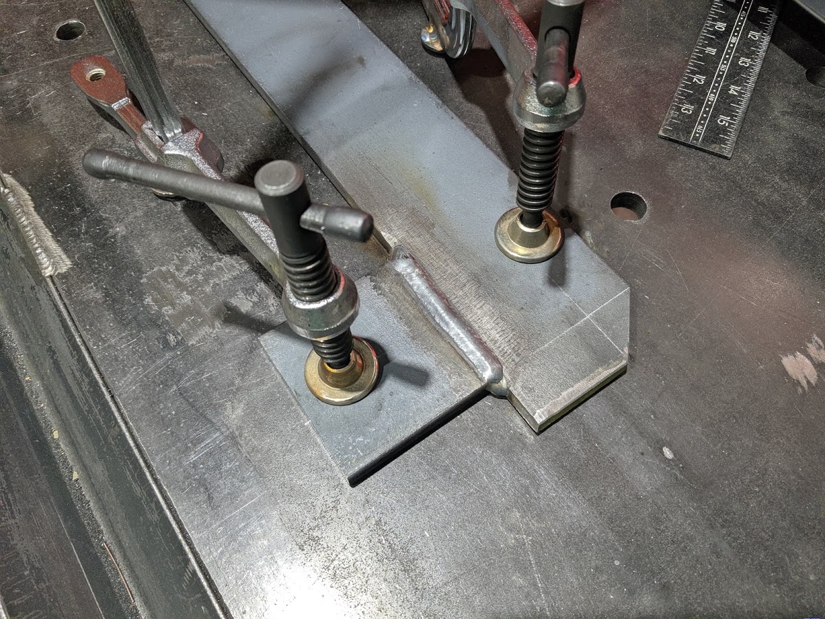

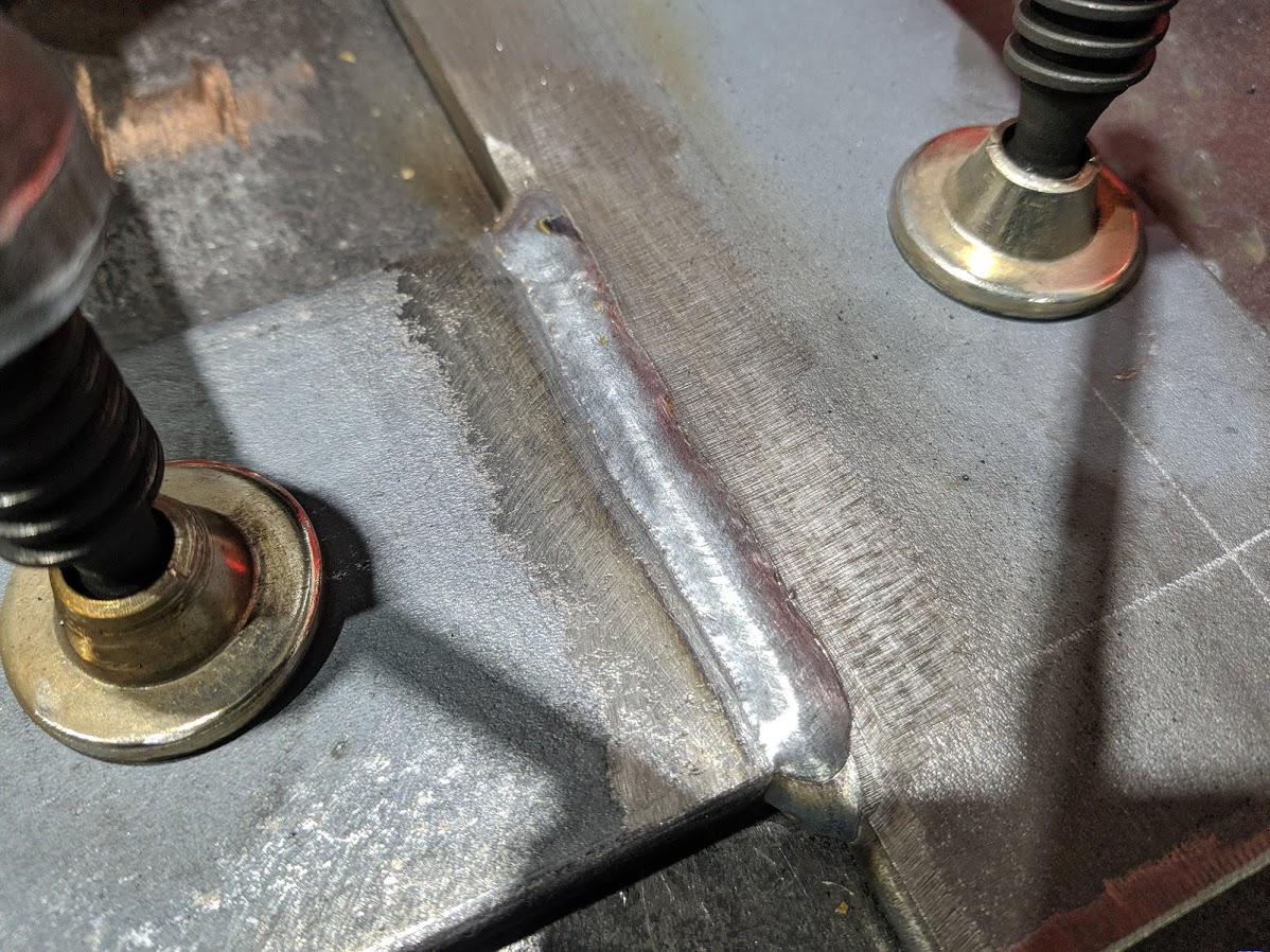

Below are some pictures of welds made with the Miller 255 pulse MIG (Grader Scraper build)
I have had the machine for about 3 weeks and it is amazing.
Starting to get the feel for the pulse settings. The noise is quite different but I am getting used to it.
These are just flat welds, and they are amazingly clean in an as welded condition.
030" ER70-S6 C10 gas (90 Agon/10 CO2)

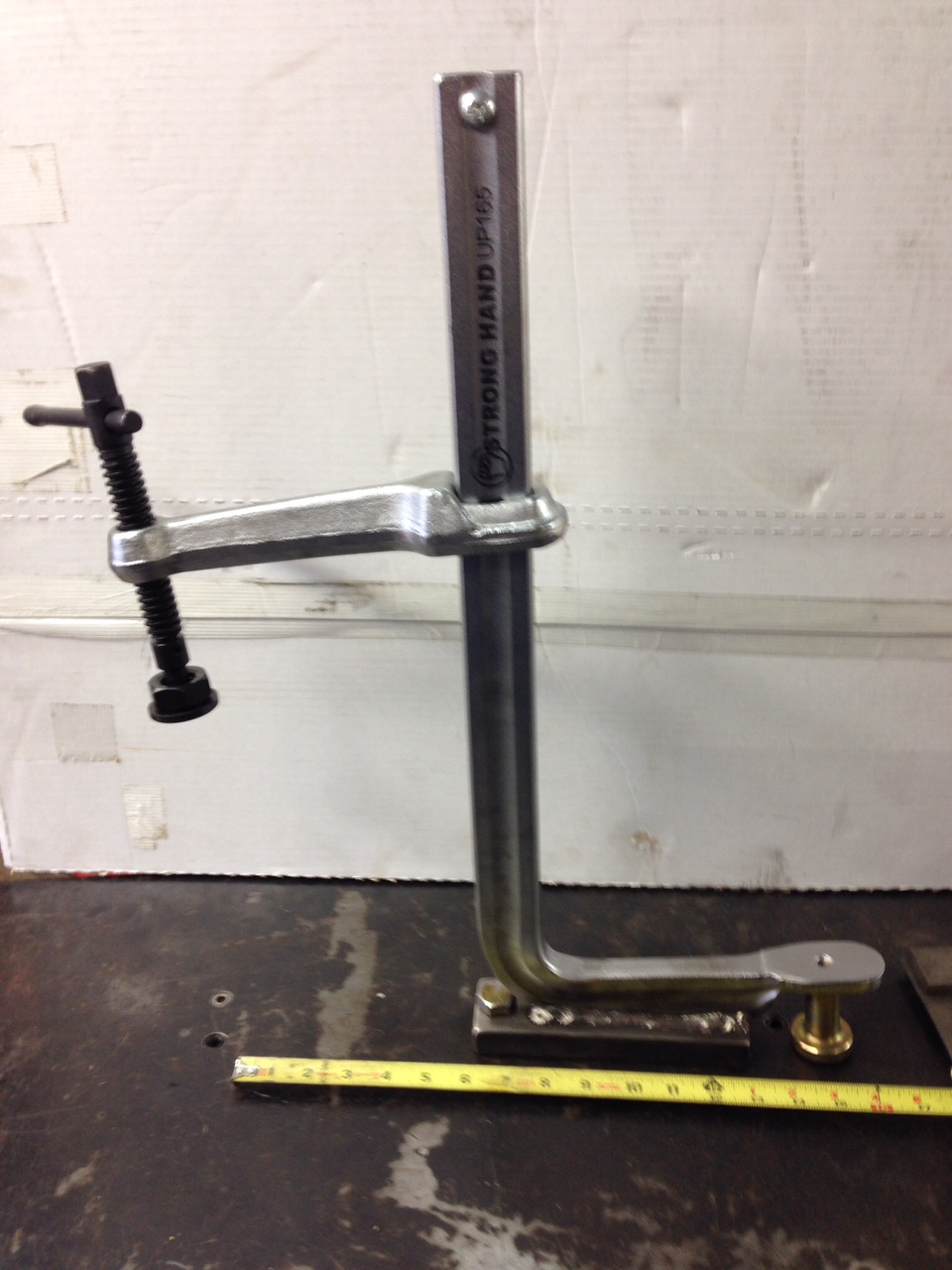

And good idea on the clamps.
I chopped mine
   / Miller 255 Pulse MIG
I chopped mine

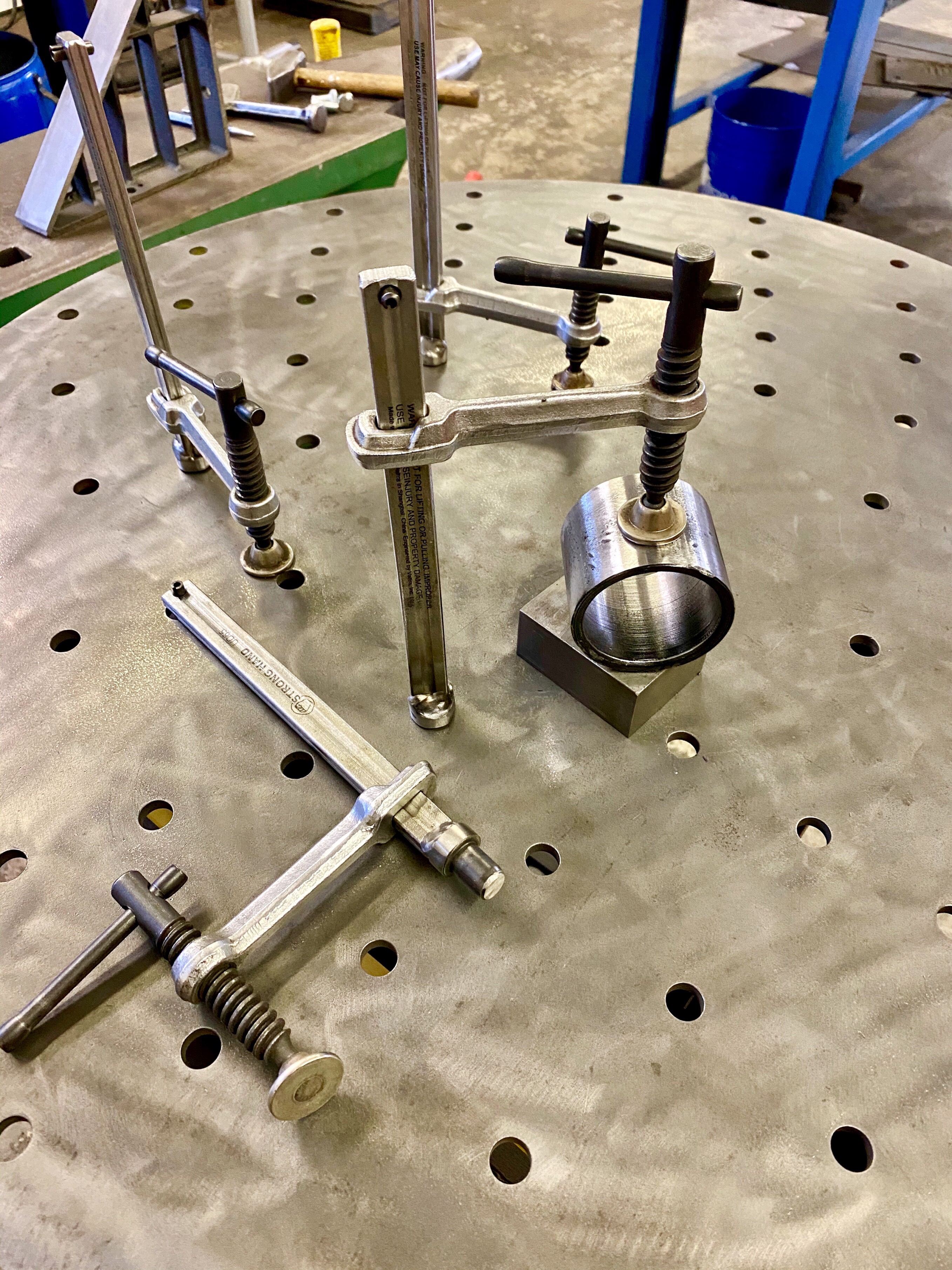

Some styles of the Stronghand clamps have reversible hand screws so you can flip them around.
I thought about chopping mine but did not want to prevent the functionality of using them somewhere other than the welding table.
So far they have worked out good, had them for about a year now.
Is that a round welding table? That is cool! :thumbsup:
   / Miller 255 Pulse MIG #7

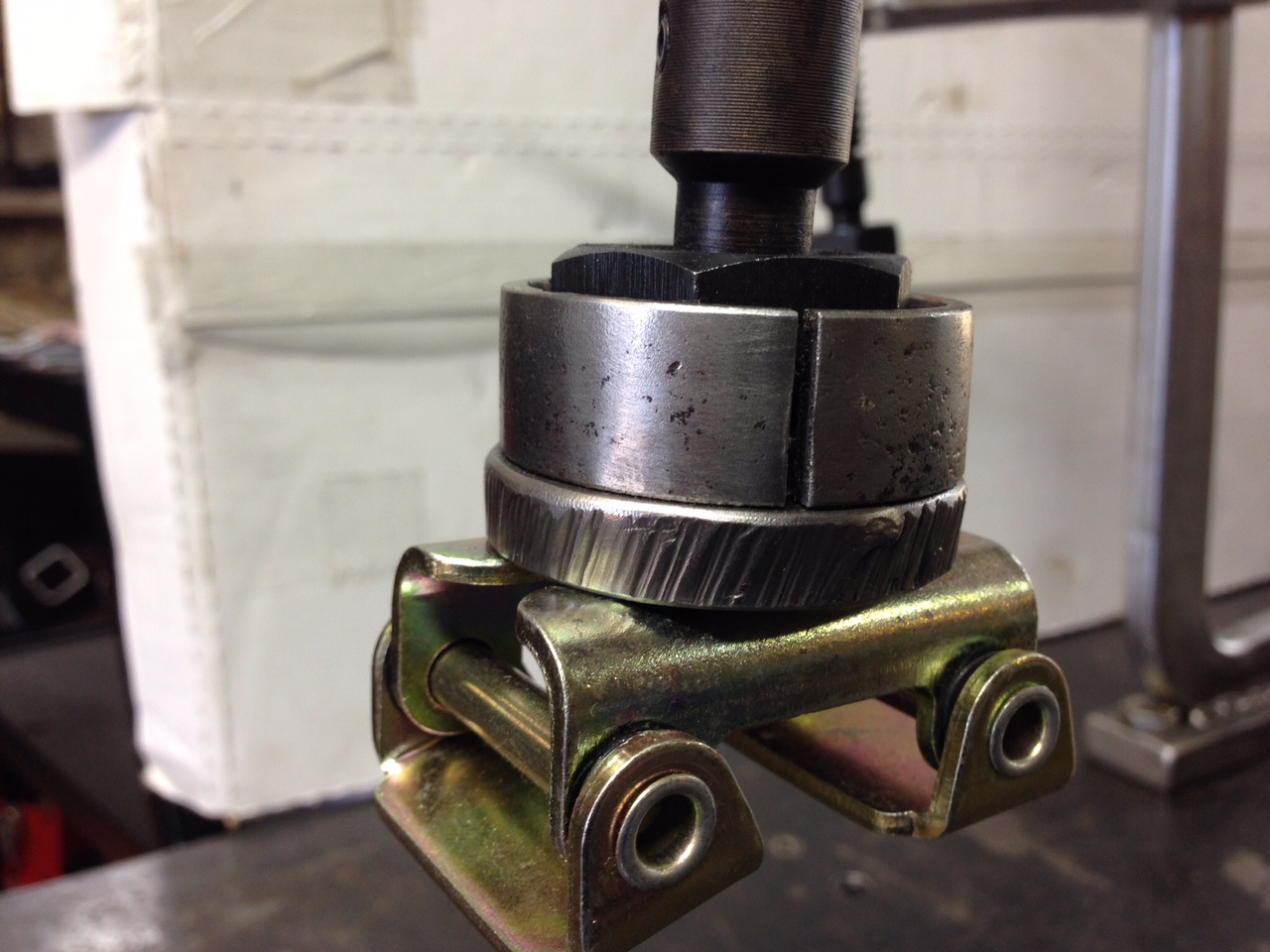

Modifying clamps to hold down have been handy. This design can take full clamp pressure.

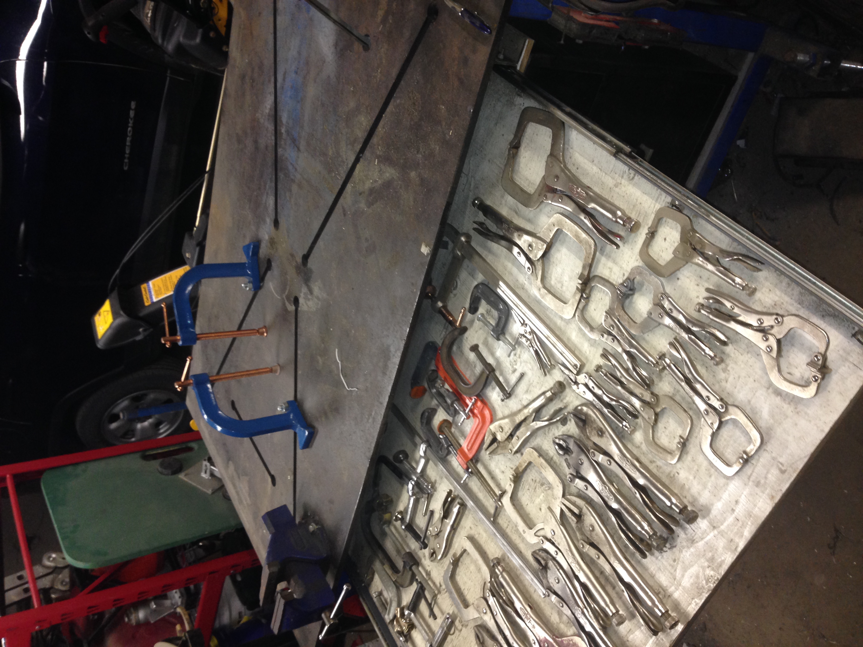

Just a litrle off topic. Love to see clamping solutions. My table is laser cut for accurate corners and slots like the Miller table. Really like the Miller clamps, though others also work well. The frame is set in three inches all around for edge clamping. Lots of clamp options.IMG_0577.JPG
