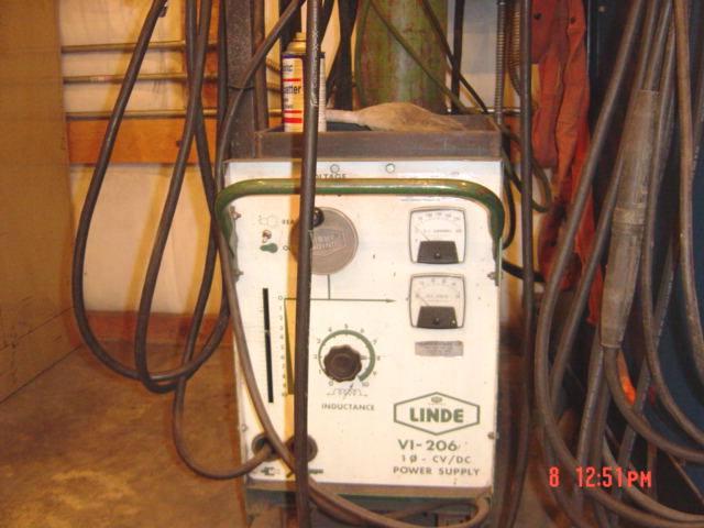

I went to Lincoln's site, and took a look at the 256. I didn't see where Lincoln offers the pinch option with this machine. Also looked at Miller's site, the 252 doesn't offer a similar option? Up until a year or so ago I had a Linde VI-206 with Mig 21 feeder. The VI stands for variable induction. My Lincoln V350-Pro has pinch, which is basically the same thing as variable induction. Not sure if ESAB still offers variable induction in any of their machines or not. If you guys ever get the chance to run a Mig machine with this option jump on it! It is amazing how much control you have over the puddle with this:thumbsup:. When welding flat, you can wet out the puddle for a real wet flowing puddle. But when doing vertical up, you can dry out the puddle, less chance of loosing the puddle and getting one of those big grapes hanging.:eek:
