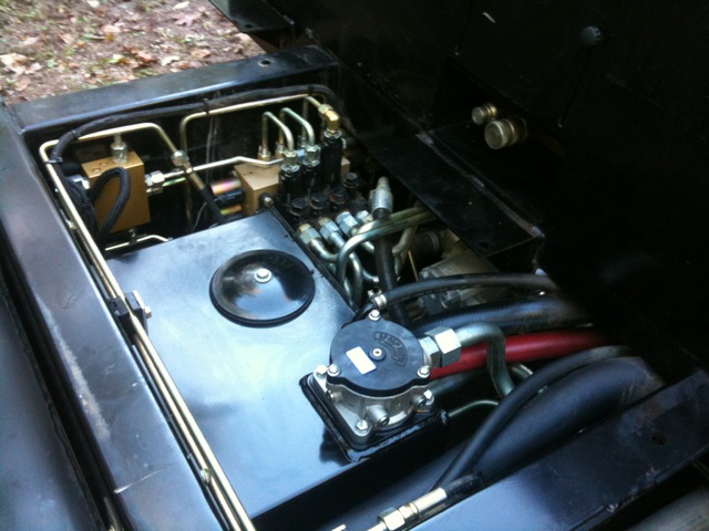

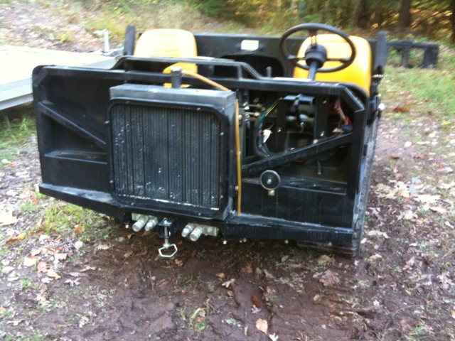

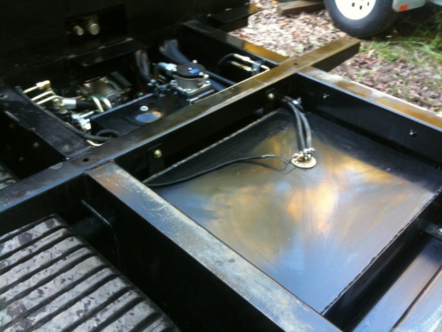

Here are some Scout photos. The cladding and ROPS has been removed temporarily but you can see what's underneath. This is an ST-50. I believe the "ST" has a different radiator and undercarriage to the SC-50. Probably parallels the differences between the RC and PT series of CTL's.
