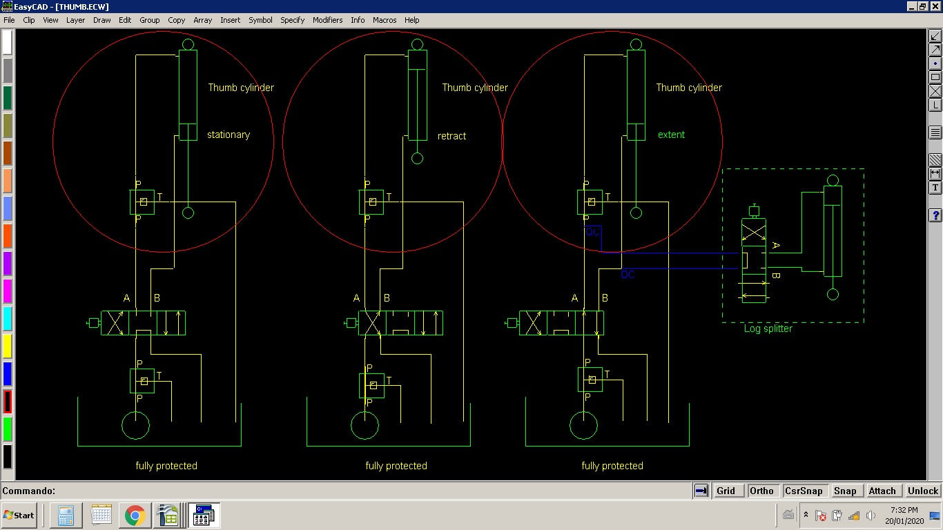

I think you need only one. Click on the picture to enlarge.
The parts added for the thumb are shown in the red circle. In the third circuit are the Quick Connects for the log splitter.
If the pressure comes from the pump (pushing), then there is the main and/or bucket relief valve plus the thumb relief valve. If the pressure comes from the bucket pushing the thumb ( being pushed), the thumb relief valve will act. The thumb relief valve is adjusted to a lower pressure than the main relief valve, but high enough to hold the load.
Without the added relief valve you rely on the main and/or bucket relief valve only.

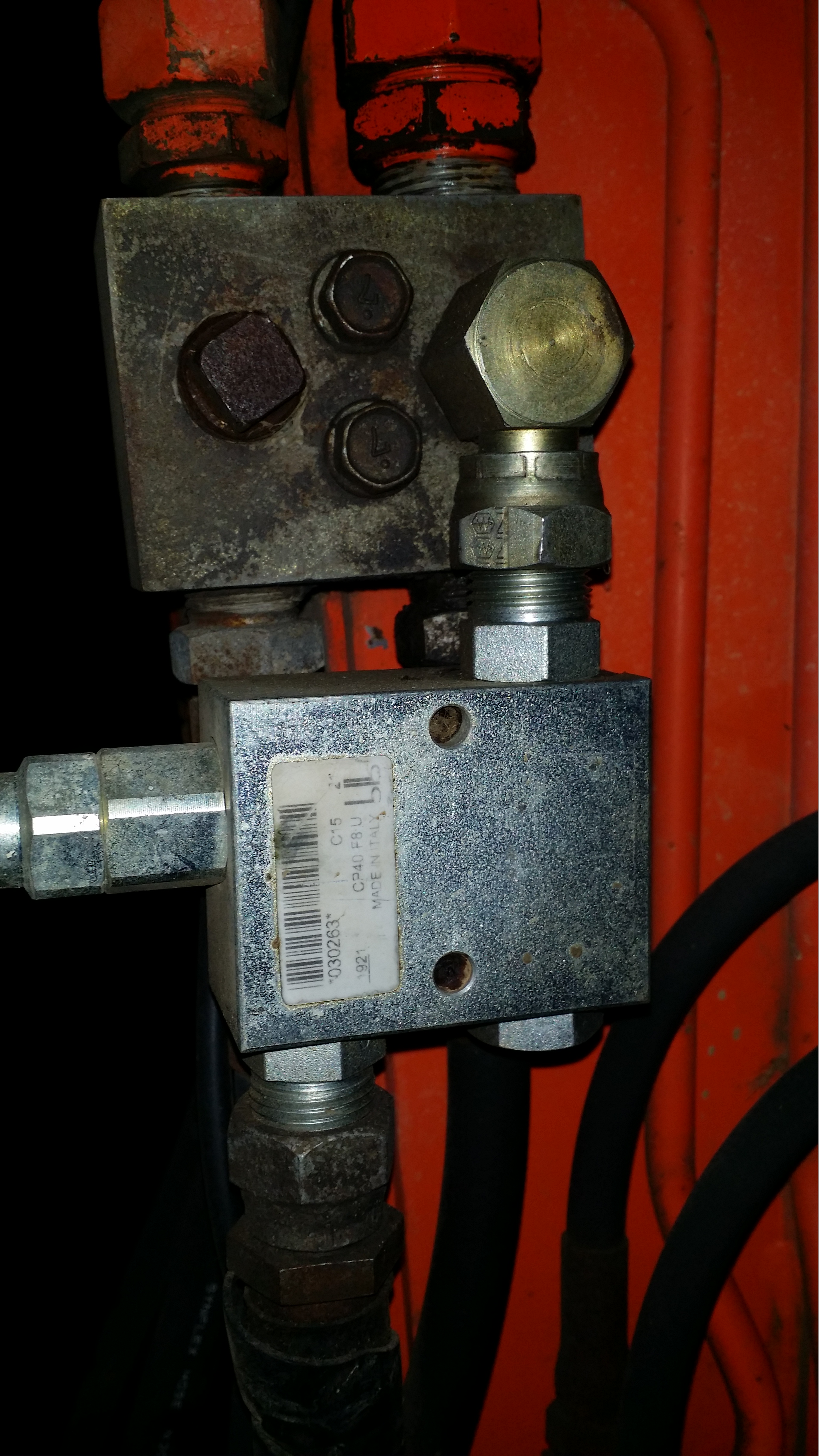

Here is how I have the relief valve plumbed in.
If the pressure comes from the pump (pushing), then there is the main relief valve plus the thumb relief valve. If the pressure comes from the bucket pushing the thumb ( being pushed), the thumb relief valve will act. The thumb relief valve is adjusted to a lower pressure than the main relief valve, but high enough to hold the load.

Good question! I have never checked. The other reason for me to put this adjustable relief valve in is that I want the pressure on the bushings to be as low as possible. Bushings are very expensive!
I have used the "hammer port" for the thumb. The "hammer port" is also usable for a thumb by taking out the return hose and put a plug in. I basically put the thumb relief valve in the plug hole and used the return hose on the pressure relief valve. ( As the picture in my previous reply shows )
