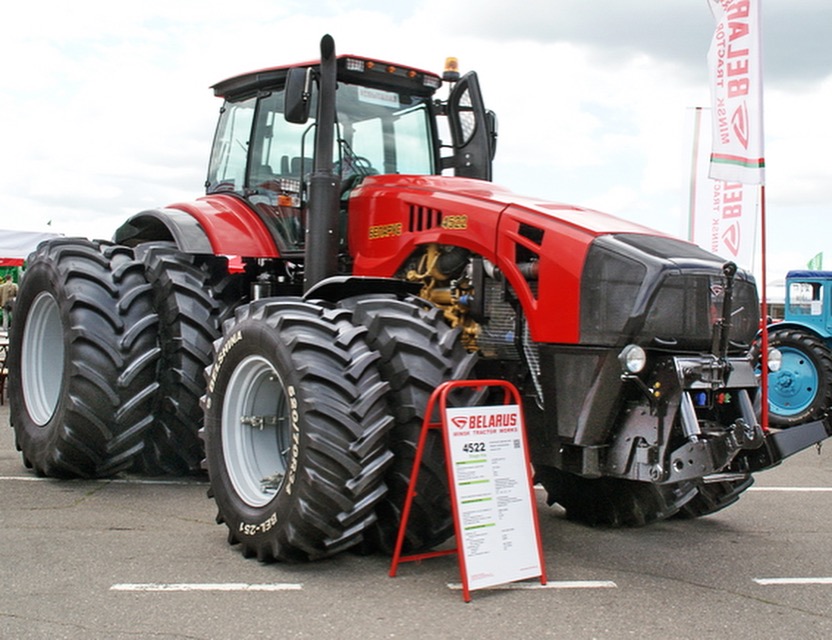

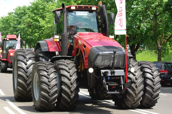

MTZ BELARUS 4522 is one of world痴 largest fixed frame tractors.
It痴 a general purpose tractor, drawbar category 8 with 4x4 wheel formula.
Designed to perform energy-intensive agricultural operations in towing and trailer driving modes.
Maximum output: 466hp, 342,7 kW
Engine: CATERPILLAR C13 Tier 3; 6-Cylinder, turbocharged and charge air cooling
Torque capacity, Нキm2: 2048
Transmission: Power Shift; FWD/BWD-16/8 (3,4km/h ... 38km/h / 2,9km/h ... 16km/h);
Front PTO: 1000 rpm,
Rear PTO : 1000/1450 rpm
Hydraulics:
Load-carrying capacity - Front 5,500 kg (12,100 lb) / Back 11,500 (25,300 lb);
Full scale pressure 21,5 MPa;
Pump capacity at nominal speed of diesel crankshaft, l/min, minimum 200 L/min (53 gpm);
Hydraulics tank capacity 175 L (46 gpm)
General:
Length/Width/Height mm - 7100/3020/3630 mm
Maximum weight 20,000 kg (44,000 lb)
Tyres: front - 600/70R34 back - 710/75R42
Fuel tank capacity 650 L (171 gal)
