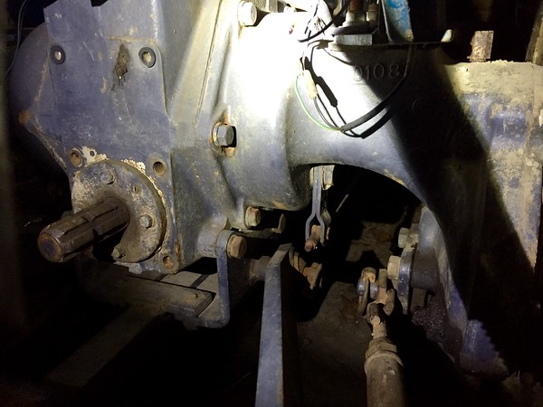

I just Bought a Mitsubishi D1650FD 4x4
Runs, drives, shifts great. Just need a little help with the brakes.

I can probably help, what questions do you have? You can take the brake rod loose and remove the bolts that hold the cover on. Pull the cover off and you will see two brake shoes inside.

i see the rods that go back to either side of the rear... but, theres no cover. The rod connects to the lever, and bolted directly to the cast of the rear.
(sorry, weird sentance)
Is that nuts that i would have to split the rear to service the brakes??
I hope I'm looking at that wrong.
   / Mitsubishi D1650fd Brakes??
This is what I'm looking at.

Wow. Thanks for the info.
I'll check it out.
