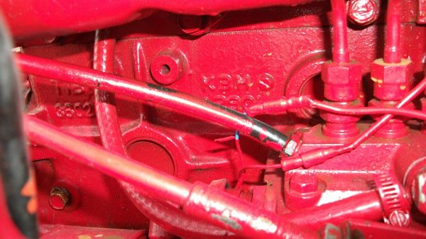

Hello, I have a Mitsubishi K3H 3 cylinder diesel running the sawmill. A great wee motor however when starting up it revs to valve bounce and when idling will rev up and down before settling down to normal idle speed again. Under load it will also rev up and down but not to valve bounce. There is no air in the fuel and all the fuel lines are good so according to me its either the pump or most likely the governors of which I hold little desire to tear apart, it a diesel mechanics job. We want it to run at 2400 rpm. Any clues most welcome.

Hello, we fixed it this afternoon with some online help. It has been the fuel filter housing that was leaking air, it was faulty and the only way we could find it (after trying just about everything else) was to take it off, block both hoses and hand pump it in a bucket of diesel, there were the smallest of air bubbles appearing under the plunger so it was thrown out and replaced with a new set up. So far so good but it will need running for an hour or so to get the last of the air out of the whole system. I think I have attached the old anew set up.

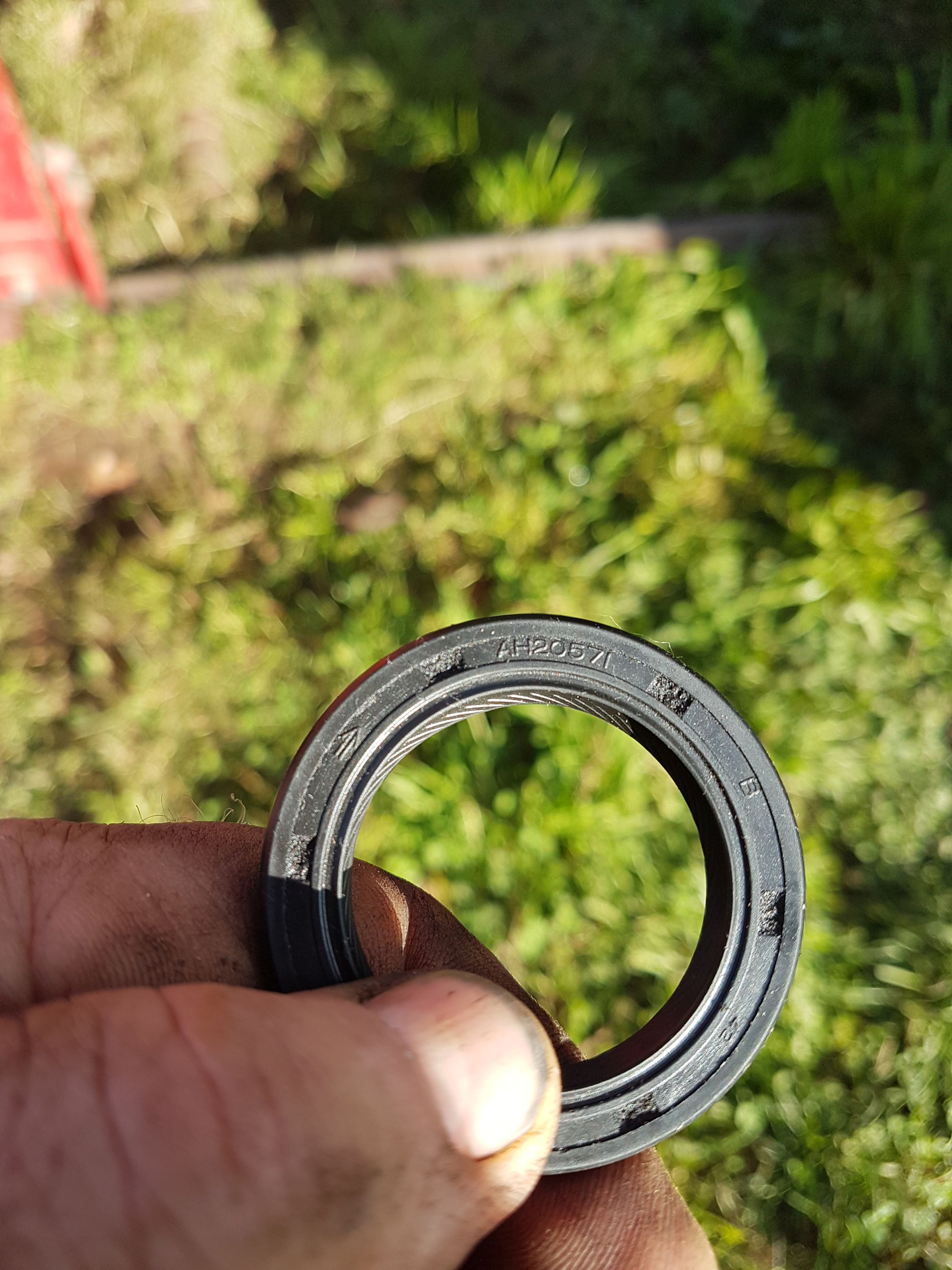

Here is the old end seal, NOK AH20571, the new one had a U after it. How many hours does everyone reckon this one has done, to the nearest say 1,000 hours, its still in good order. 20180619_140057[1].jpg
