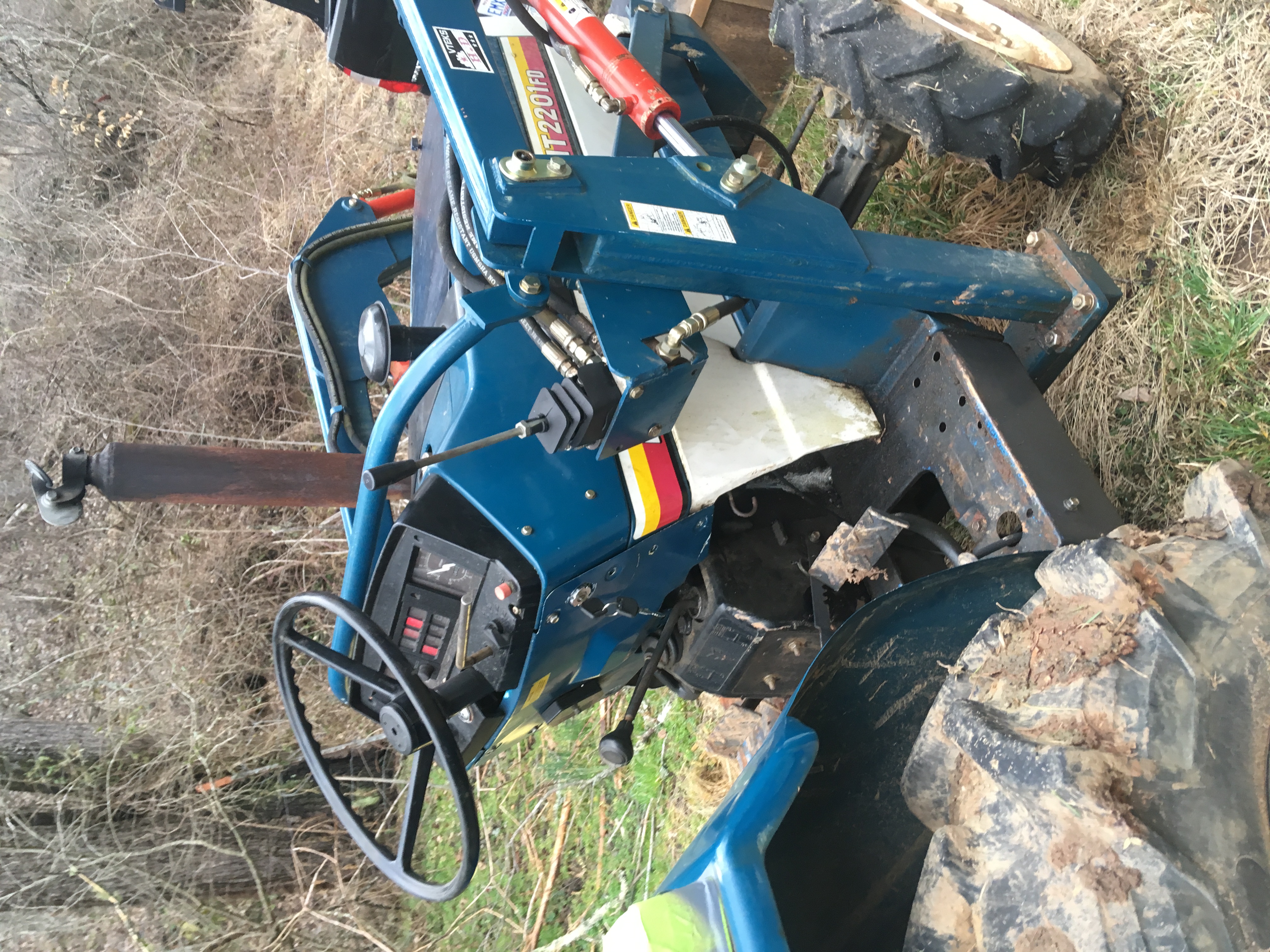

Hi there,
I just put some money down on a tractor that checks out excellently on all fronts as far as I can tell except for a frothy trans or hydraulic fluid out of ports on both sides of the steering column. I tried to see if I could I could make it worse by steering hard left and right on the wheel, it didnt seem to make a difference. But on running it for awhile, there was enough fluid coming out to stay on the pedal deck and drip on the ground. The points it is coming out of are 2 ports, one on each side. I am kicking myself for not snapping an image of it for a more accurate description. ( I will update the pics next I get out there)
My best guess so far, is that it would be a steering box gasket, and would probably need to be replaced, or rebuilt if there is a kit for it.
I tried finding this topic to no avail, apologies if this is a repeat post.
If any of y'all have any information that might shed some light, that would be appreciated. :2cents:

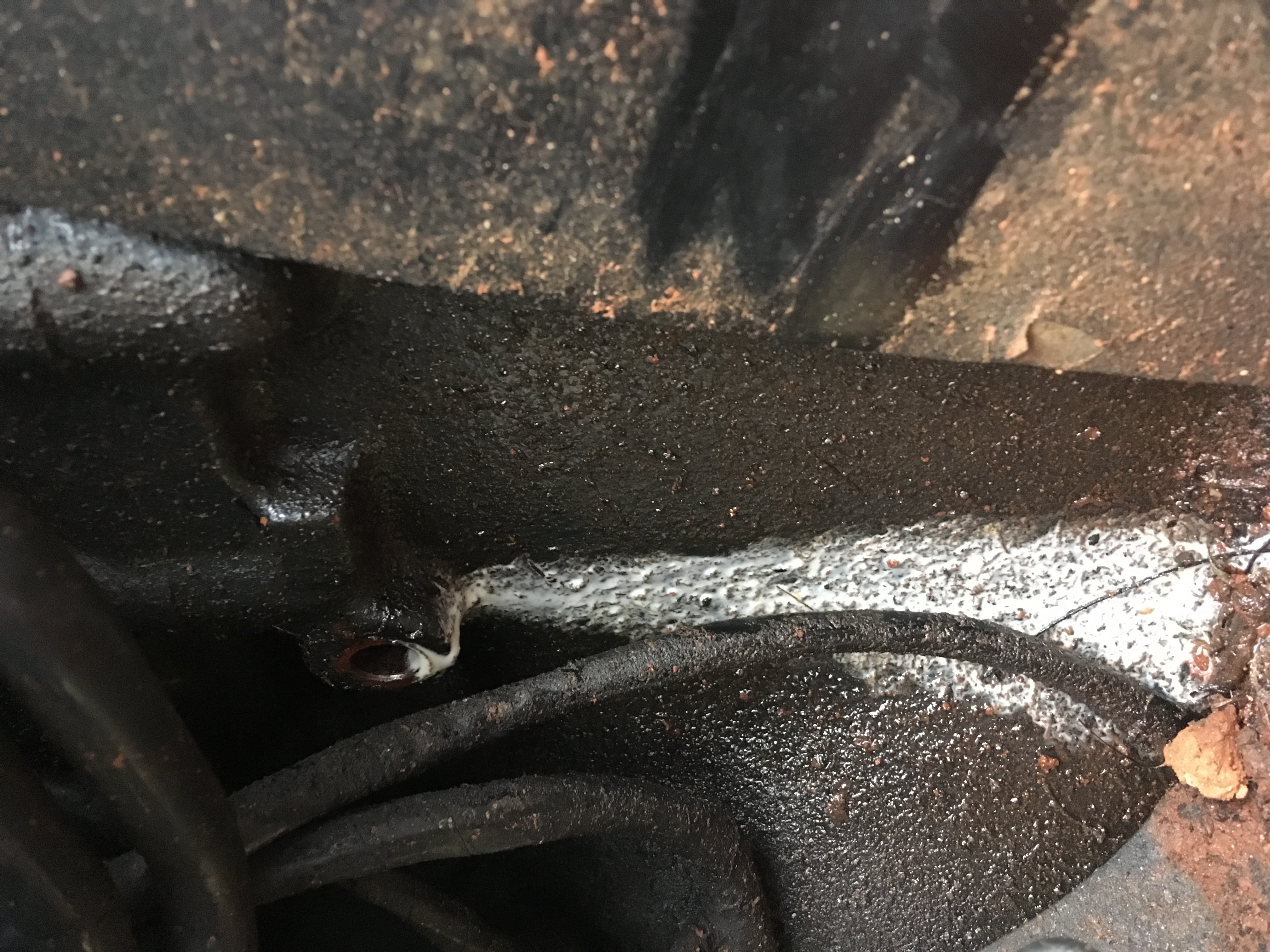

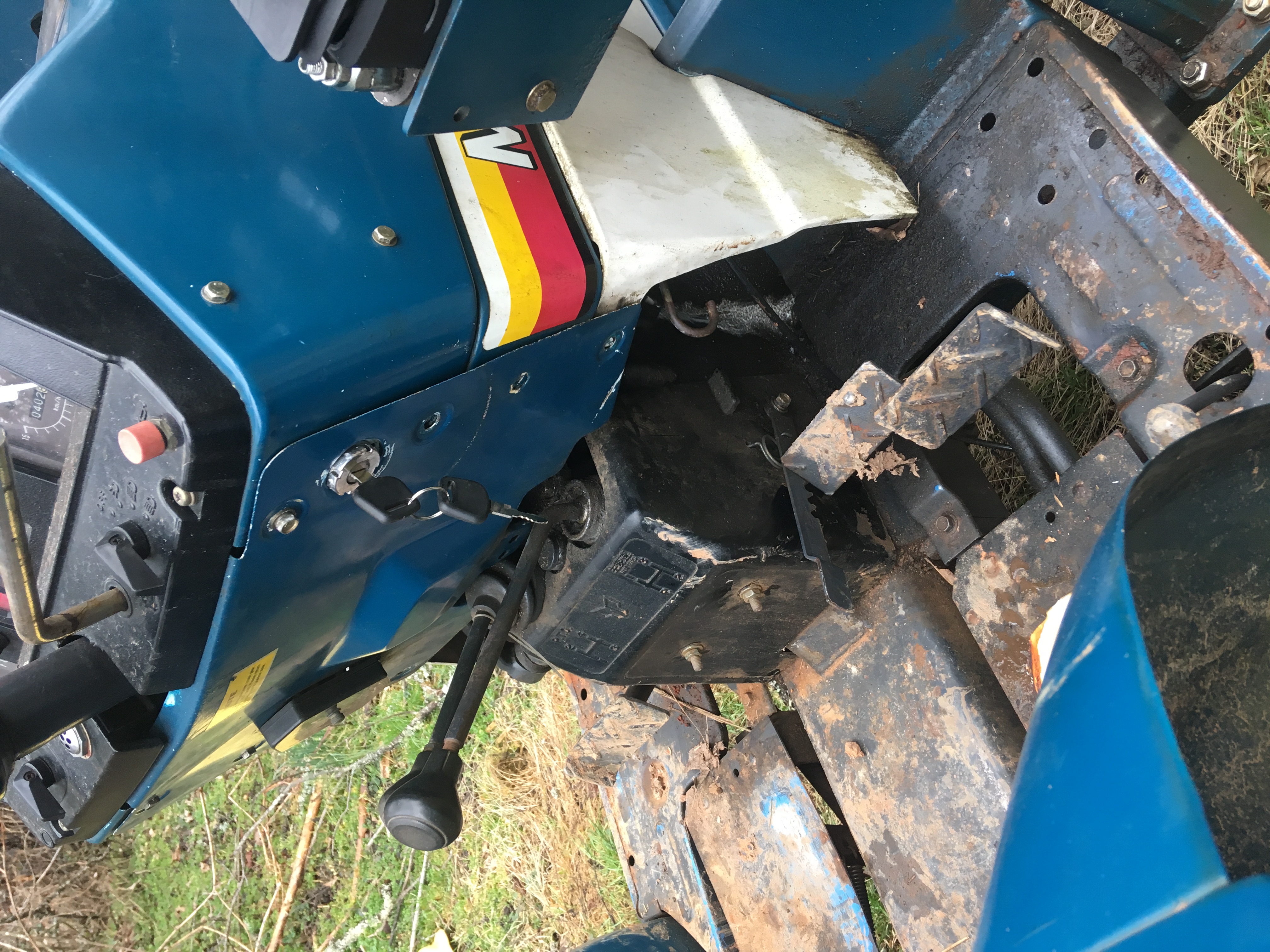

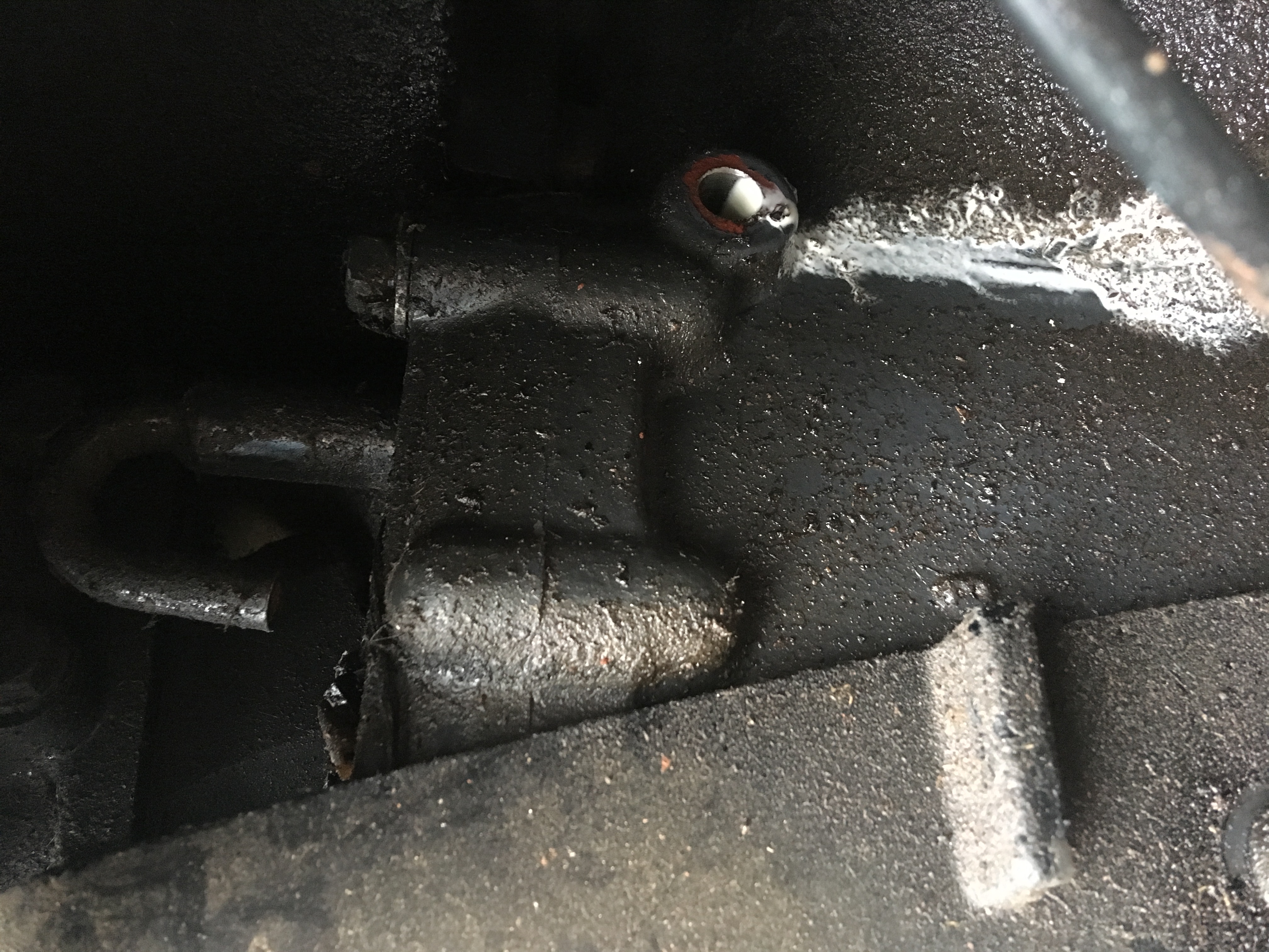

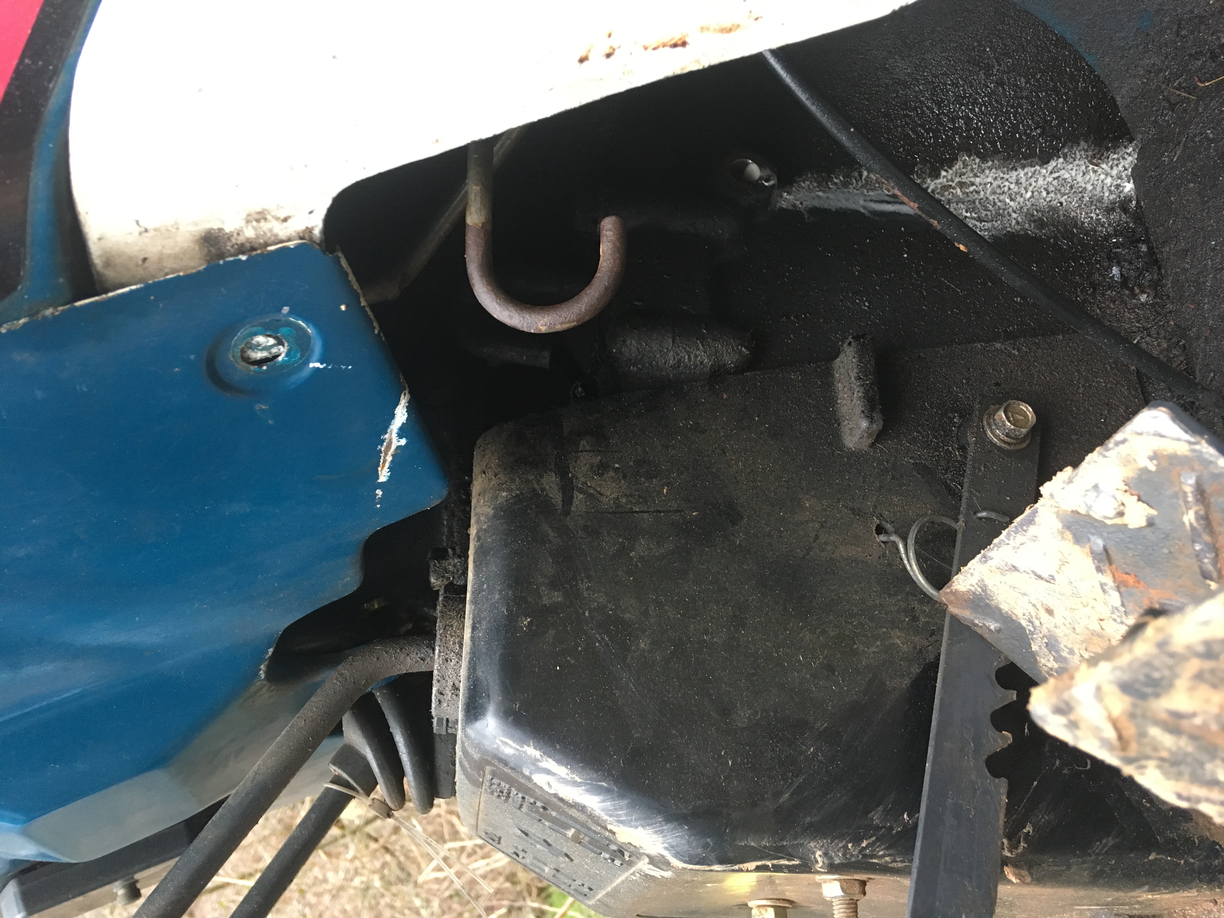

IMG_6320.JPGIMG_6323.JPGIMG_6325.JPGIMG_6326.JPGIMG_6327.JPG Attached are some images ( if I have used the attachment function correctly) of the aforementioned leaks. I did get a small clue yesterday on it, I think I saw a spurt come out when I shifted from 1st to 2nd drive gear on a hill and maybe it is an overflow on the transmission of the drive speed gearbox. the weep holes are not threaded, and I wonder if a small plastic cap fell out of each side? I am kind of shooting in the dark with it, and maybe barking up the wrong tree? hah.
   / Mitsubishi MT 2201 FD Leaks on both sides of steering column #7
Hard to tell from pics but it kind of looks like the leak is below any steering hydraulics and forward of the trans case. That would mean the leak is in the clutch housing though.....which shouldn't have oil in it ( I'm guessing the 2201 is a dry clutch like all the other small Mit's tractors I've had). I think seeing it spurt while shifting may be the giveaway that it's a leak from the trans case. It does look like a bolt or plug is missing in the pics. Your cases appear a little different than mine but my MTE2000D does have two bolts in the top, front corners of the side portion of the trans case ( looks something like what yours is missing). I would fish deeper in the ports and see if there are threads deeper in the casting that would suggest it is simply a bolt missing.

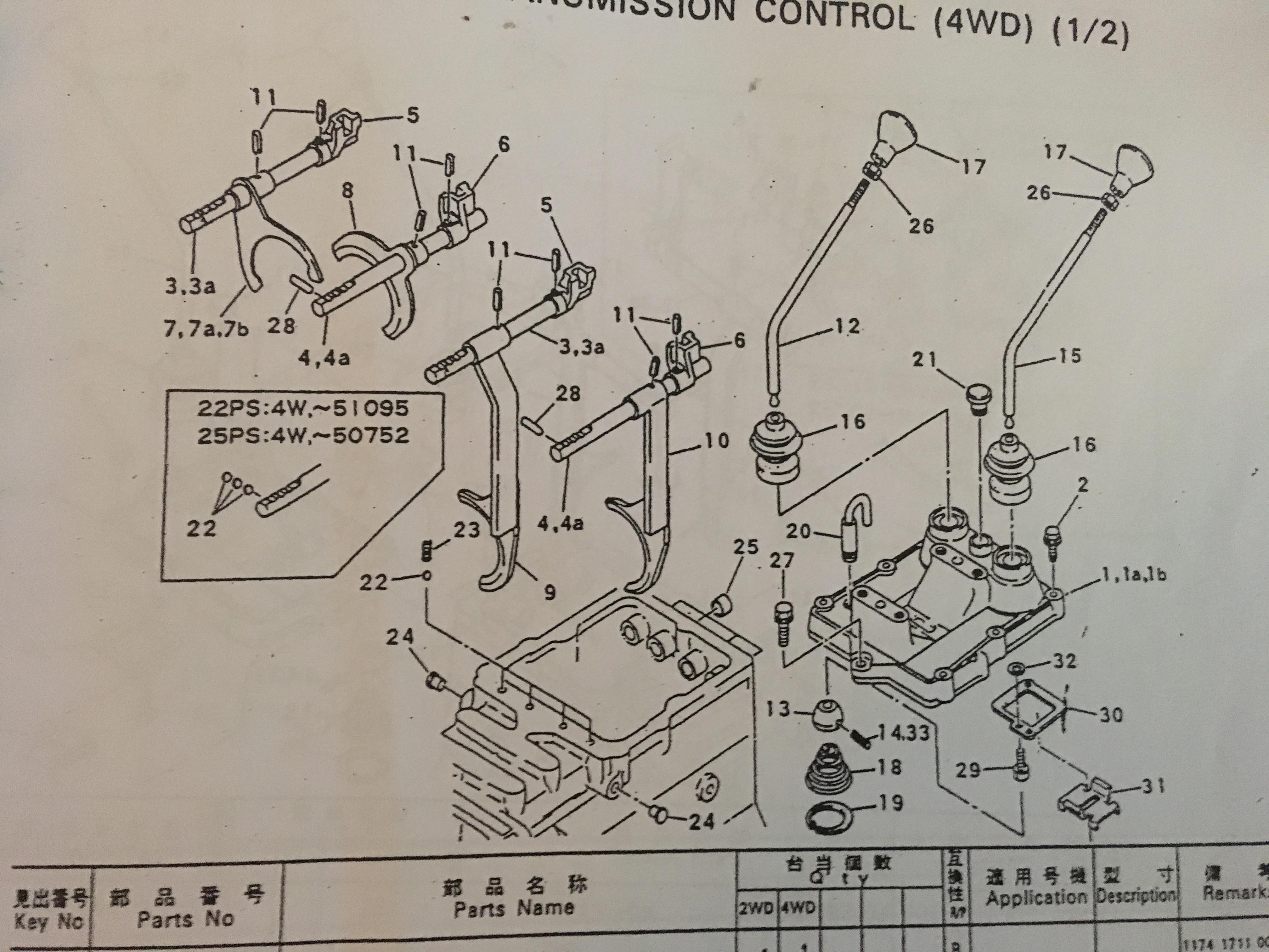

Well I sprung for a manual, figured this wouldn't be the first quandary I would have. Turns out part #24 in the diagram is just a plug. I sure appreciate y'all chiming in.
