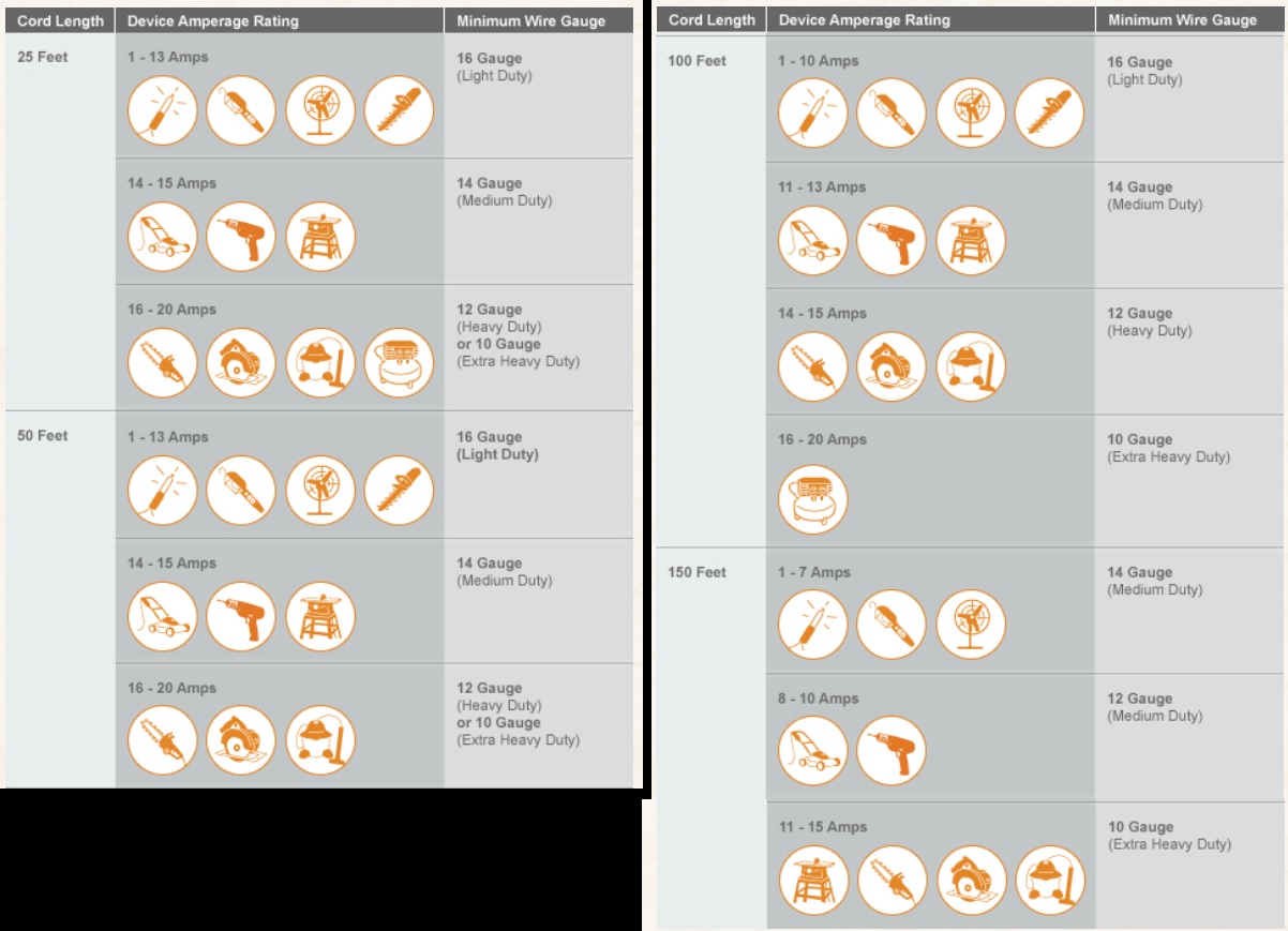

   / Mixed sizes---extension cords and air hoses. #5
Most power cords have an amp rating. Don't put more of a load than the smallest one will handle.
Recommendations from Home Depot.
