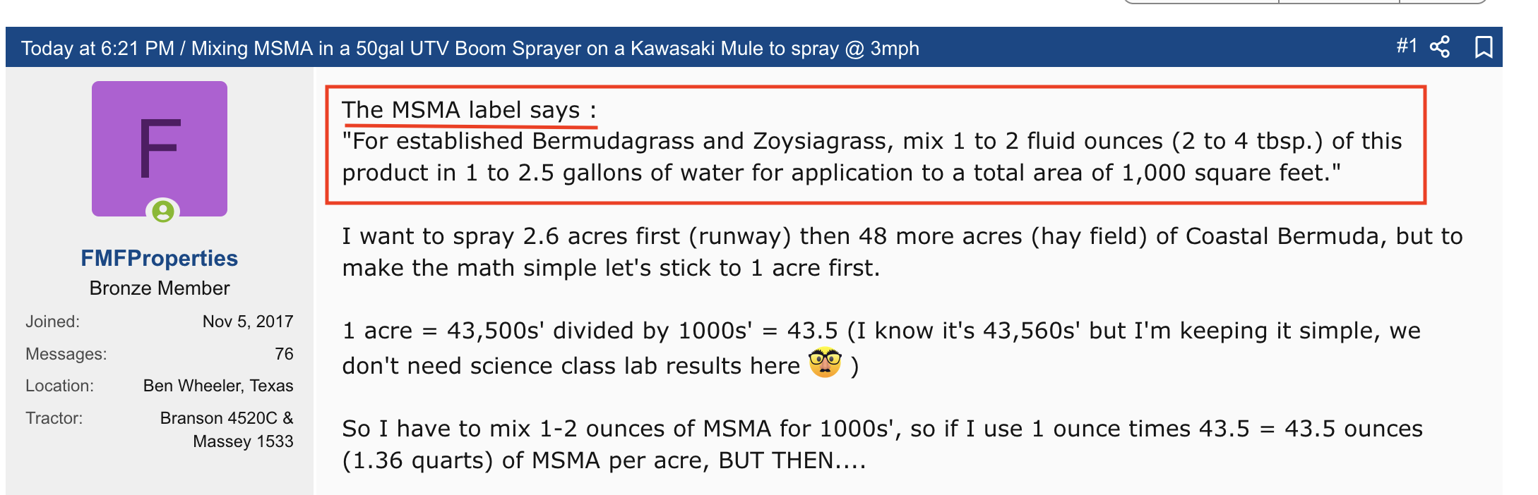

The MSMA label says :
"For established Bermudagrass and Zoysiagrass, mix 1 to 2 fluid ounces (2 to 4 tbsp.) of this
product in 1 to 2.5 gallons of water for application to a total area of 1,000 square feet."

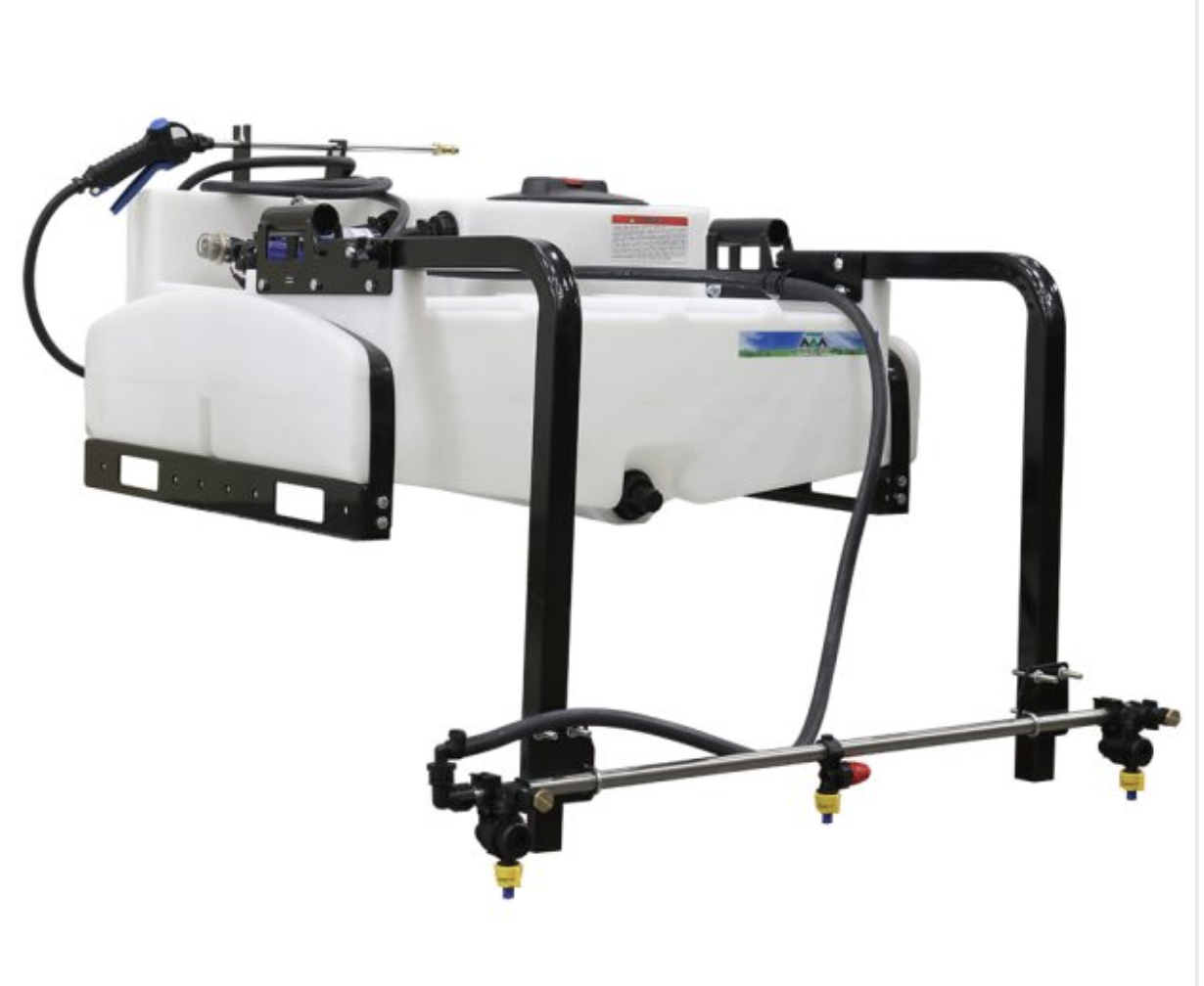

I want to spray a 2.6 acre runway of Coastal Bermuda, but to make the math simple let's stick to 1 acre first.
1 acre = 43,500s' divided by 1000s' = 43.5 (I know it's 43,560s' but I'm keeping it simple, we don't need science class lab results here 🥸 )
So I have to mix 1-2 ounces of MSMA for 1000s', so if I use 1 ounce times 43.5 = 43.5 ounces (1.36 quarts) of MSMA per acre, BUT THEN....
what about where it says to mix it into 1 - 2.5 gallons of water for those 1000s'? If i multiply 1 gallon of water (for 1000s') x 43.5 = 43.5 gallons of water for 1 acre.
My sprayer at 3mph spreads 13 gallons per acre. How many ounces of MSMA do I need for 1 acre spreading 13 gallons of water per acre, OR should I go slower to use more water per acre?
If I go slower, maybe @ 1mph (I haven't tested this speed yet), I might be able to spread at 43 gallons of water per acre, but that doesn't seem logical and the grass would get more water but it would be a more diluted MSMA per acre.
I've called 2 ag stores but they don't seem to know math and give me wild answers, one of them just told me 1.5 to 2 gallons of MSMA for 50 gallons of water !!
HELP !!!!
PS:I know someone will ask so let me get this out now 😊.
I arrived at 13 gallons per acre by actually driving at 3 mph spraying plain water (did 5 passes with a 9' wide spray) over the measured 2.6 acres (46' x 2480'), and it took me 33 gallons of water to do it, so I use a rounded up 13 gallons per acre.

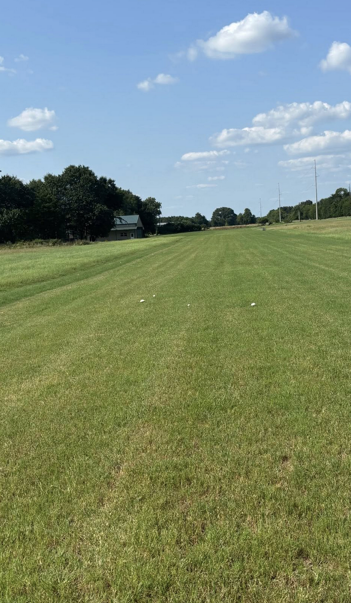

Pictures of the sprayer and first 1000' of the 2500' runway.
You have answered your question. Your sprayer puts out 13 gallons per acre and you need 43 oz. of MSMA per acre. So for every acre, or for every 13 gallons, add 43 oz. of MSMA. With MSMA, the gallons of water per acre is not critical.
I've used MSMA in the past and 43 oz. is a good rate. Not too high, but not too low.

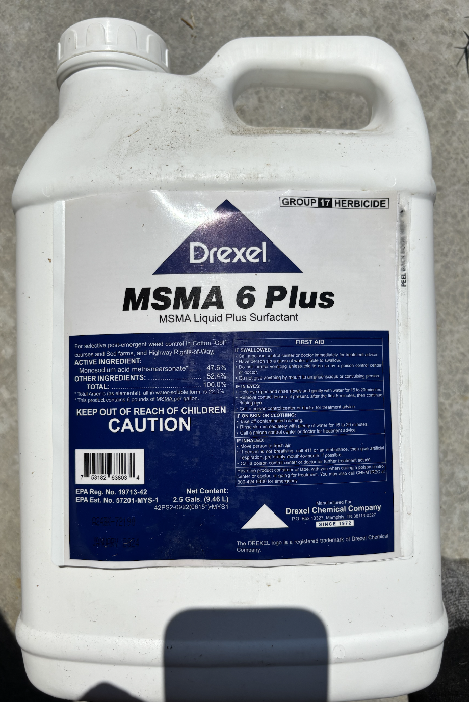

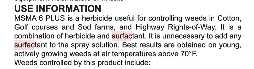

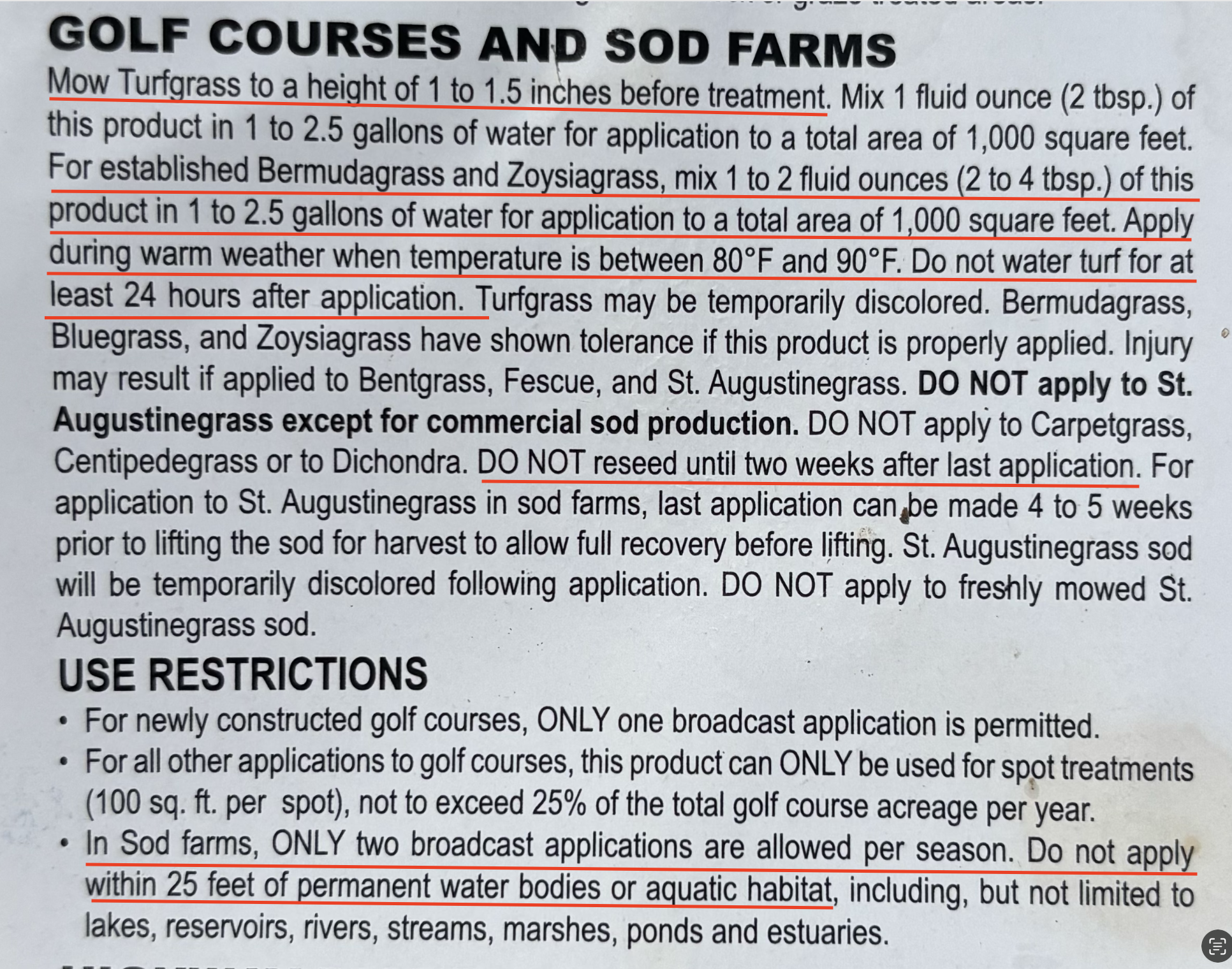

Thank you for the first part.
For the 2nd part, I copy and pasted it directly from the label. Here's my post and here's a picture of the label on my 2.5 gallon jug.
The way I read that label, it can ONLY be used on 25% of the total area of a golf course, or on a sod farm. I don't see where it says it can be used on lawns, sports fields, pastures, hay fields, industrial sites, or anywhere else.
I used it on many sites in the past, but the label changed about 10-12 years ago, and now I don't use it at all. I have been a licensed commercial applicator since 1982. I read labels almost every time I spray.
I'm sure you would be fine if you do spray your pasture, but I just want you to be aware of the label and the law.
   / Mixing MSMA in a 50gal UTV Boom Sprayer on a Kawasaki Mule to spray @ 3mph #6
I just went read the label again, and it does have a use on cotton fields, and highway right-of-way.

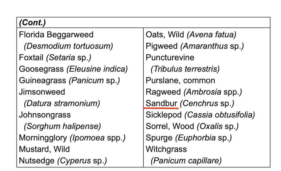

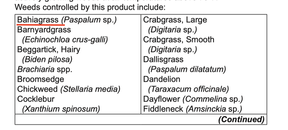

Thank you. I'm controlling sandburs and bahia, and it's working good. The one I have is already mixed with surfactant.
