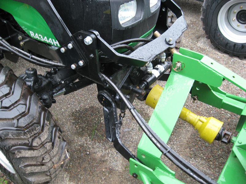

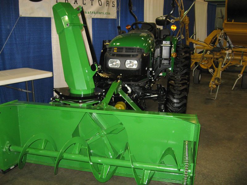

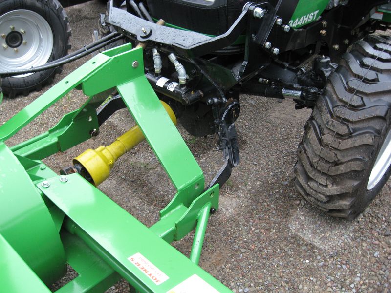

I don't have it on my tractor but my dealer has one setup on a Montana R4344HST with a snowblower.

Thank You!! :) By the sounds of it, if I buy this, we can then use our Farm King blower on the front.
