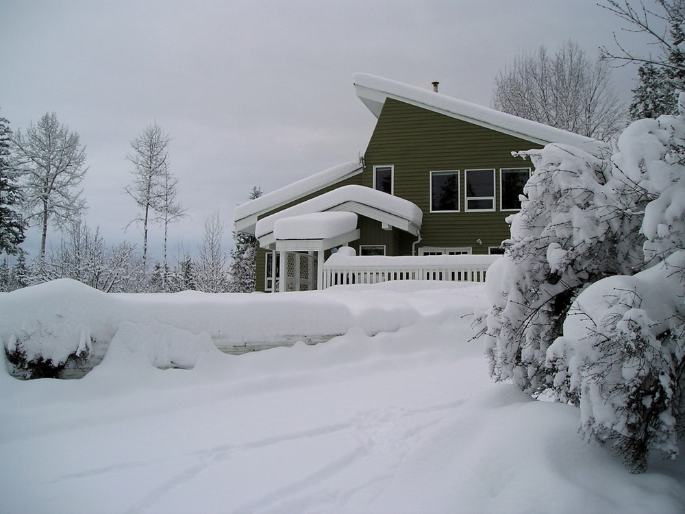

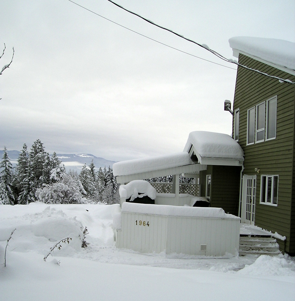

I've decided on a pull-type blower because (for me) not having to continually look behind outweighs clearing-capacity limitations. The snow up here arrives in gentle dumps of up to 12". We get 4 to 6 of the 12" snowfalls per year with many more of 6" or less. We get virtually NO drifting--there is normally no wind during snowfalls and we are in a densely treed area. Winter is 90% overcast so snowpack depth and density increases through the winter, but it is easily manageable as long as one keeps up with it.
I'm confident the DK35 (14" clearance) will have no trouble. Until now I managed the approximately 800' driveway with a smaller Kubota L275DT and 6' rear blade. It had no problem driving through the snow with the blade angled to throw the snow to the edge. The driveway is gently sloped and if the tractor could not handle uphill runs for the deeper snowfalls I simply did all the clearing in the downward direction.
Such a method just gets the snow to the edge of the driveway and I then need to push it into the ditch by offsetting the rear blade and driving in reverse. That's getting very hard on my old back:(--thus the change to a pull-type snowblower.
I've attached a few photos of our place after a typical heavy snowfall. The snow on the deck rail gives an idea of a typical heavy snowfall and the snow on the roof and idea of how it accumulates.

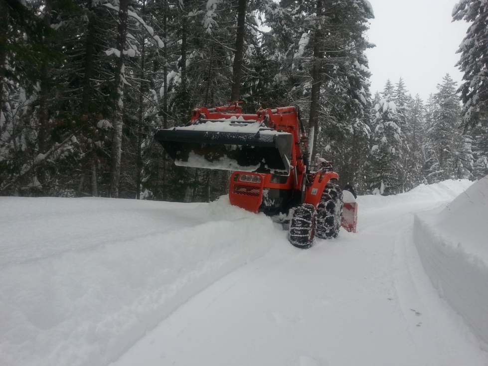

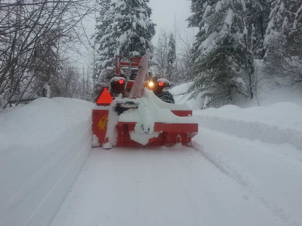

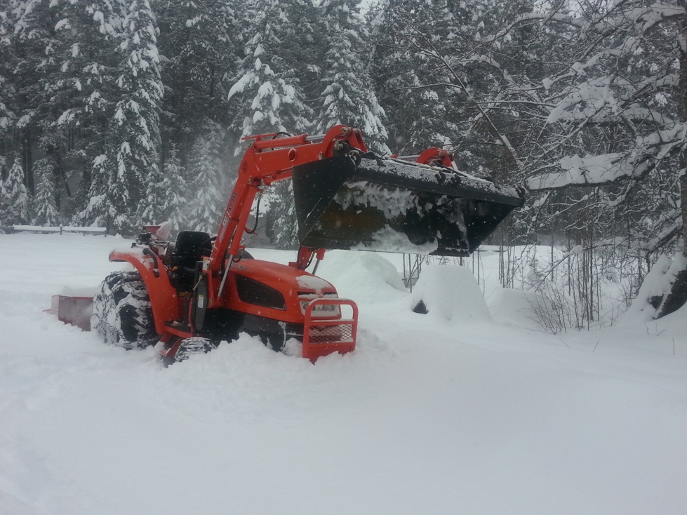

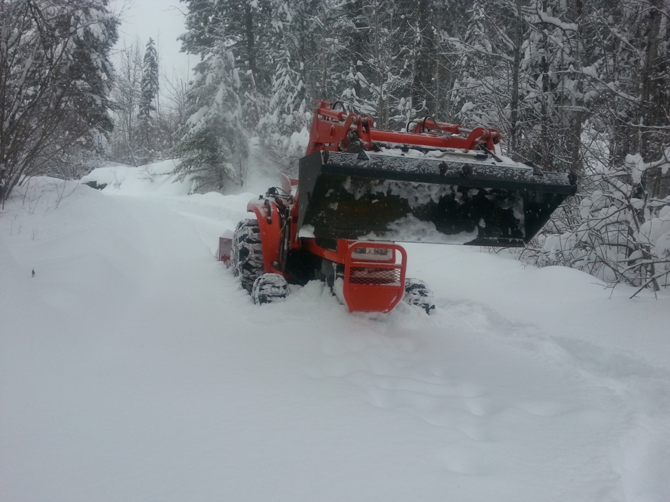

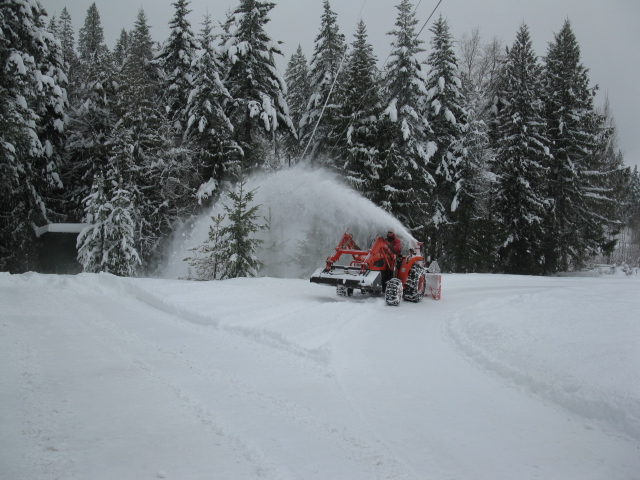

I got the 75" MK Martin Meteor pull-type with a hydraulic chute rotator. I could not be happier with it. My concern was the 27.5 PTO hp of my DK35SE HST, but my dealer assured me it would handle it. It has done that easily. It handles our normal, heavy snows of 12" or less easily:
We had a record single-dump of fairly dense snow this year which it also handled fine, but I did have to slow down occasionally, mainly while clearing uphill:
20150105_SnowClear_0.jpg 20150105_SnowClear_1.jpg 20150105_SnowClear_2.jpg 20150105_SnowClear_3.jpg 20150105_SnowClear_4.jpg
It will handle heavy, "wet-cement-like" snow without plugging as long as you keep the blower busy with lots of snow by regulating the ground speed. The HST makes that easy. I have front and rear chains and recommend at least rear chains, even though the DK35 is fairly heavy.
I am happy with the blower and recommend it, especially the pull-type, if you have significant distances to clear. I imagine I would have been just as happy with the Lucknow.

That was about the limit for the tractor heading forward. The grill guard was pushing snow the whole time and I cleared most of the neighbours' places on our road. However, one new neighbour moved here in the fall and had no means to clear his 1/2 mile driveway. The day after this storm he asked me to do his driveway, and by that time we had an additional 8" of heavy wet snow, plus he had about 12" of consolidated snow from prior storms. The depth was not much deeper than snow in my photos, but it was much denser and gentle uphill most of the way. I gave up going forward and did the whole 1/2 mile by backing in about 30' at a time and blowing forward and downhill. It took a couple of hours to reach the house.
Once it had blown one path it again easily handled it going forward by keeping one side on the cleared path and knocking the top of the deep snow down by keeping the bucket a foot or so from the ground.
