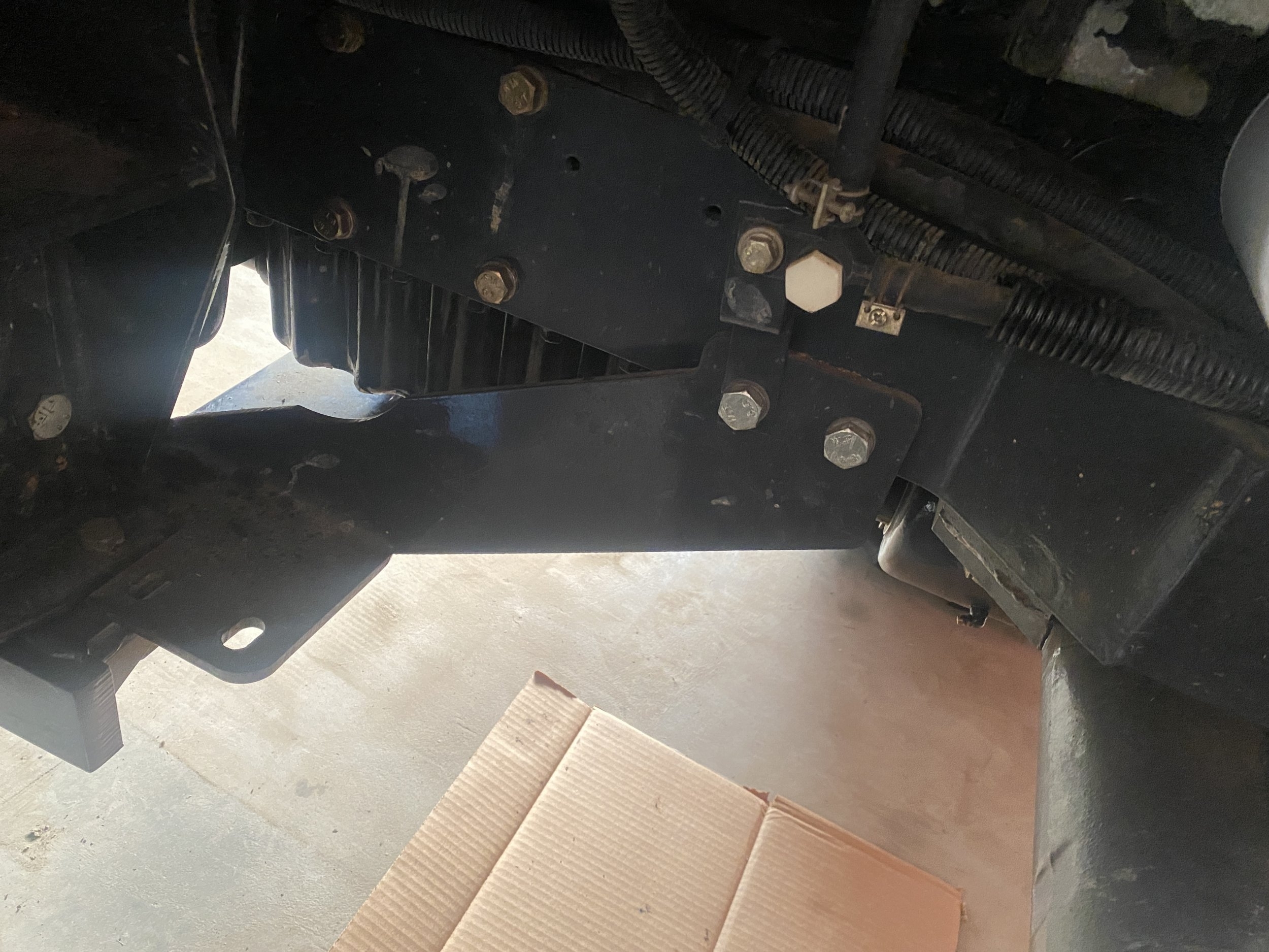

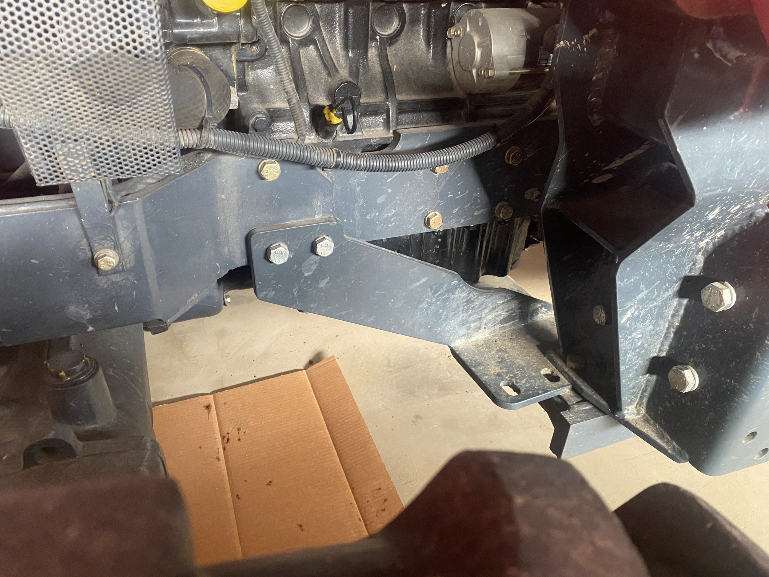

I'm looking for the braces that were added to the newer model ML112 (2003+). I've reached out to my Mahindra dealer and KMW to no avail. Even tried a couple tractor salvage places. Any help locating some would be awesome. I'm trying to avoid having to have them fabricated locally.
I got a early 3510 with 1100 hours on it this year. Great tractor, runs good and everything works well. I noticed some flex in the frame, most noticeable between the dash and hood hinge weather stripping when lowering the FEL. Pretty sure the bottom engine bolts have loosened some. After a lot of reading on here I see a big part of it is the braces where never added. It's not affecting the capability yet. I plan on splitting the tractor to check everything, but would like to locate some braces first.
The Mahindra part #s are KMW12082019 and KMW12082018. They show for ml112 bracket with S/N 03058028-CURRENT(04010233).
   / ML112 subframe braces Needed. #2
Its a shame KMW can’t help you out, as you can tell by my photos the brackets are not too complicated.
If you take some detailed measurements between mounting points and make a drawing up, a local welding shop should be able to fabricate
I think it is 1/2” plate stock but i can check that
If you need more photos let me know

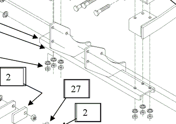

Your part number is KMW12092012. Yours should have the braces built in.
If I end up fabbing a brace I was thinking of doing it like that. It's a much simpler design with the diagonal braces welded directly to the bottom plate.. The braces for the ML112 were after thoughts so they aren't as integral as the one for your loader.

I was wrong on the thickness, it is 3/8 not 1/2 like I thought
The ml112 brackets are bent not butt welded (see photos)
The part that bolts to the sub frame has multiple holes for adjustment
That’s may be the best way to go in your situation,
I had no idea the ml114 braces were attached directly to the cross member, seems to be a more solid attachment
The 112 braces must have been an afterthought by Mahindra
That's good to know, I was expecting it to be 1/2" steel like the frame rails.
