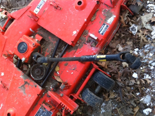

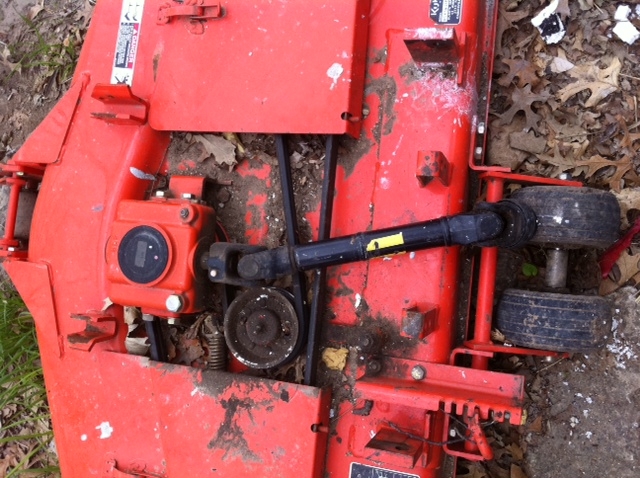

This certainly is a newb question.. I disconnected my MMM from my B7610 Kubota to get to work with the FEL on a large project. Now that is done and I want to begin mowing, i'm having difficulty getting it back connected, and believe I made a stupid mistake pulling the spline shaft out and now cannot get it back in. There appears to be a keyway in the shaft I removed, but there is not a corresponding one where it came out of that i can see. When I go to put it back on, it goes in about an 1/8" and stops. I do not want to encourage it on unless that is the recommended way. Any suggestions are welcome.

I would recommend cleaning both ends the best you can and then grease the heck out of it and try again. You may have a small pebble stuck in one of the splines that is preventing you from reconnecting the PTO shaft back together. Keeping turning one of the ends until the keyway matches up.
   / MMM Connection Issue #4
Jim,
I have that MMM & did the same thing. The drive shaft does have a key way of sorts. It's a small weld between 2 of the teeth on the inner shaft. The easiest way to find it is the mate the shaft up & try to push it together, if it goes great, if not the shift it 1 tooth & try again. Once you've found it take a drift punch or center punch & put a dimple on the inner shaft as a mark to when the keyway is. On the outer shaft you can see where the keyway is, put a Dimple there as well. HTH

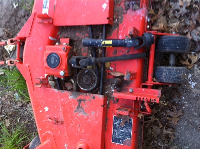

Thanks Trafficman, that was it! Marked and ready for the next time...

I'll be honest, I still could not see the keyway on the male shaft, and it was relatively clean of grease had to do the tooth by tooth turn method recommended. Perfect idea to mark with a punch also! I thought for sure I had done something wrong... :ashamed:
   / MMM Connection Issue #9
I did the same thing, then noticed a 'cut out' spline (male) that matches a 'valley filled' spline (female) after I was filthy from trying all the positions. Then I remembered... U joint shafts are not constant speed, and need to be
'phased'. If you look, the inner and outer crosses will be aligned (to their mates at the other end) when assembled correctly (the only way possible). So, there were really only 2 possibilities to try (now that yours is marked...).
