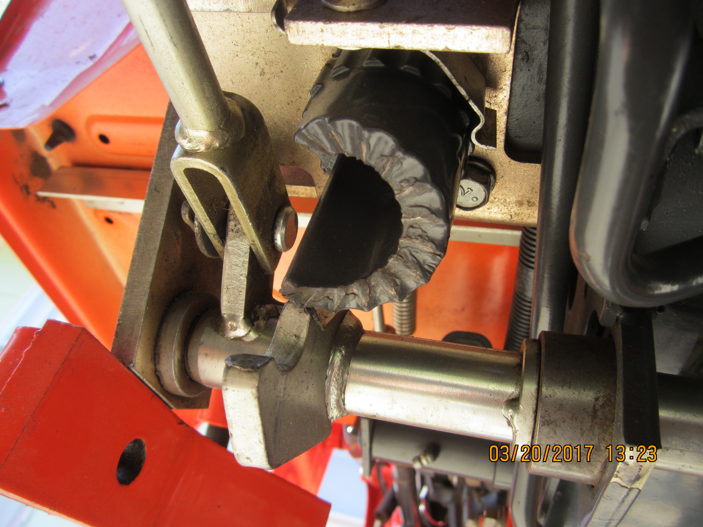

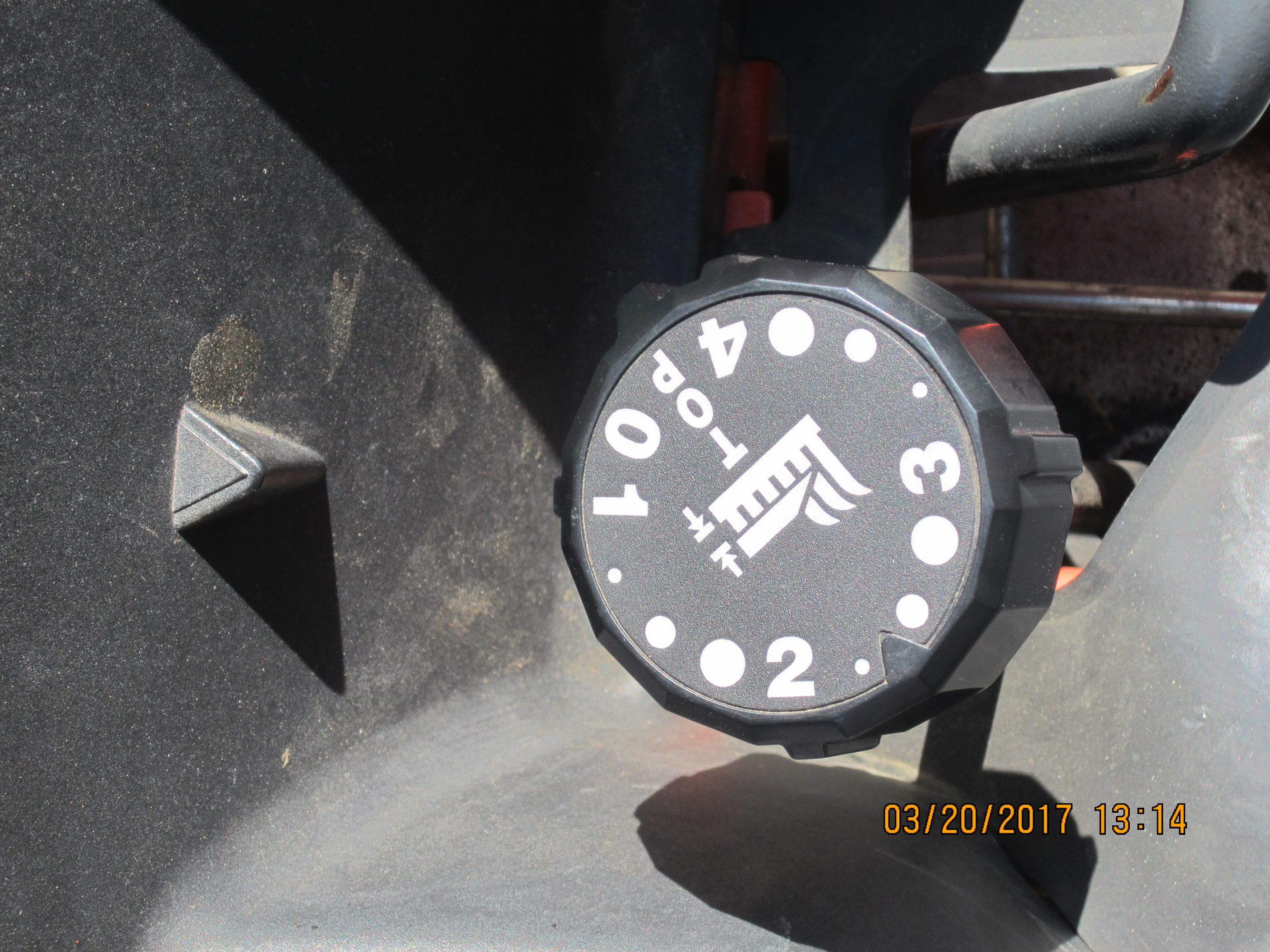

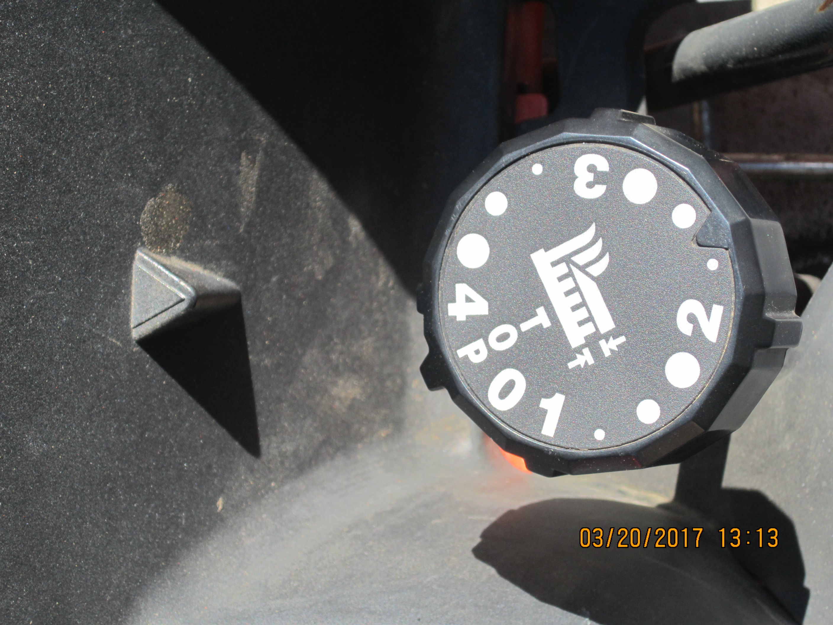

My Kubota B2620 MMM cutting height adjustment knob will not hold the setting. The past few years it looses height now and then. I figured it was just a sudden bump that threw it off, and just reset it.
But at the start of this season it will not stay up at all. I can set the height all the way up to #4, but as soon as i let the hydraulics down it spins the whole knob around and drops to #1 which would scalp the grass. It will not stay on any setting except the transport position.

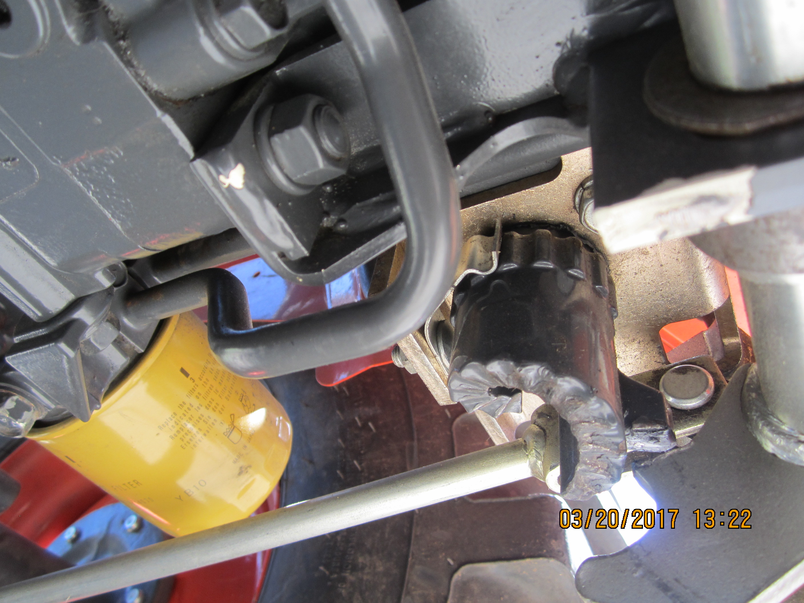

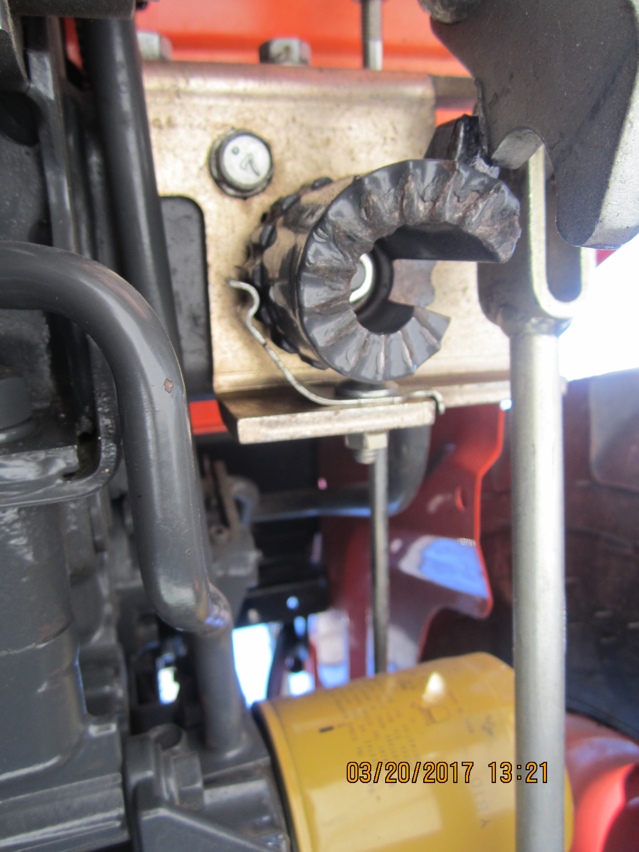

I took the apparatus apart this afternoon and can't see any obvious defect. Having reassembled it, I found that it worked okay for a few minutes, but then went back to the original problem. Maybe the cam teeth are worn out is all I can guess. Neither the Kubota Parts manual or the owners manual are of any help. Any help would be appreciated. 013.JPG014.JPG015.JPG016.JPG017.JPG

Quite strange. Never heard of this issue before. Normally the BX's have the full weight of the deck hanging on that cam and you cannot adjust the "drops down to point" to allow deck height adjustment unless you have the deck fully raised so it is resting on the hydraulics, not the cam. So most people I know have had the reverse of your problem -- they can't turn the knob (with weight on it) and typically break the knob trying. I see the cam is bolted on with a single nut in the middle of it. Might that nut be loose, allowing the cam to rotate too easily ? That does not seem likely since your knob is spinning when you lower the hydraulics. A puzzle for sure.

I had a very similar issue with my BX-24.
The issue is the plate where the adjuster knob goes through becomes worn and the shaft has play in it even with the bolt (on the underside) is completely tight. When the deck bounces, it causes the shaft to move and will cause the stop to jump out of the cam.
The fix is to add a washer (or something to pad out the plate). I added mine on the topside so it did not affect the mowing height and still allowed me to lock the deck in the top position. After the addition of the washer, it is possible to tighten the bolt too much and you will not be able to turn the adjustment knob and the adjuster shaft should be ridged.
This link can provide additional information.
http://www.zbcreations.com/b2620/B20 Series Loss of Deck Setting.pdf

I installed it last mowing season any the issue went away. Also, added some blue loctite to the nut inside the cam to make sure it would not loosen. The document suggest replacing the factory nut with a nyloc nut but finding the correct size to fit inside the cam proved very difficult.

Eric K..............you saved my day. Thanks for the reference. By putting a good size washer on top of the cam, the problem was solved. But I did buy a new cam ($45). Next time I'm under there I'll add that blue Lcctite. The dial is a little tight right now, but I'll follow that as the season moves along. Thanks again.
