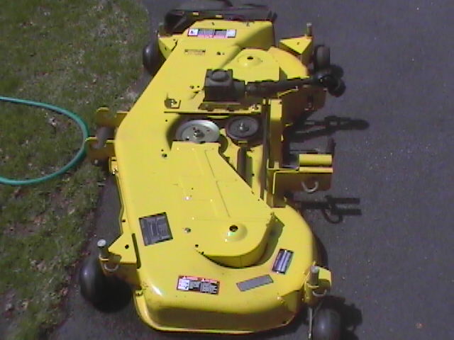

Here are some of the pics before I did a slight refurb.

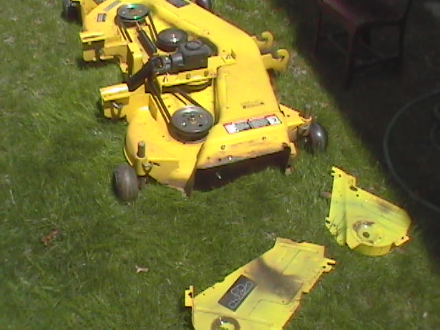

   / MMM Mounting trouble - Help
#9
Here it is after the mulch kit has been installed and the new belt has been installed.
Terry, I have a torque wrench so the torquing of the bolts should be fine. I had to slightly rearrrange the mulch kit so it would not make contact with the blade, that worked and so everything is ready for the other parts.
