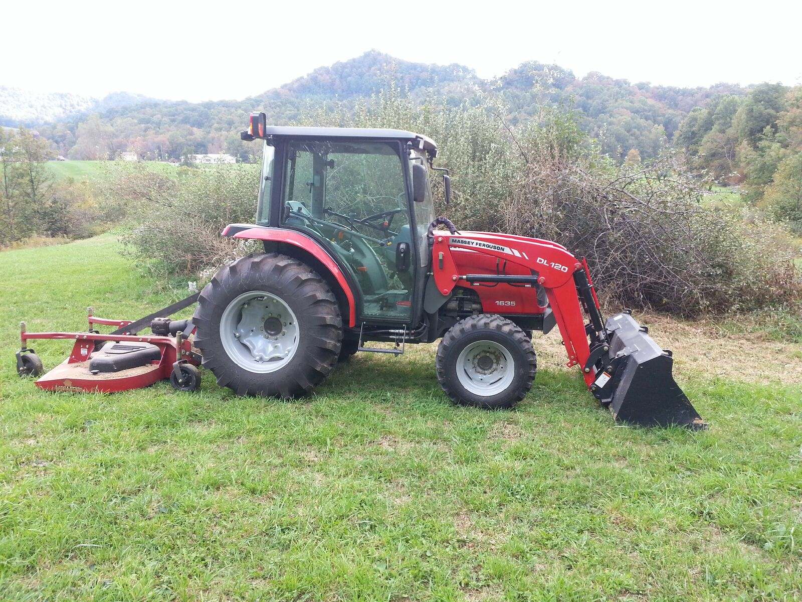

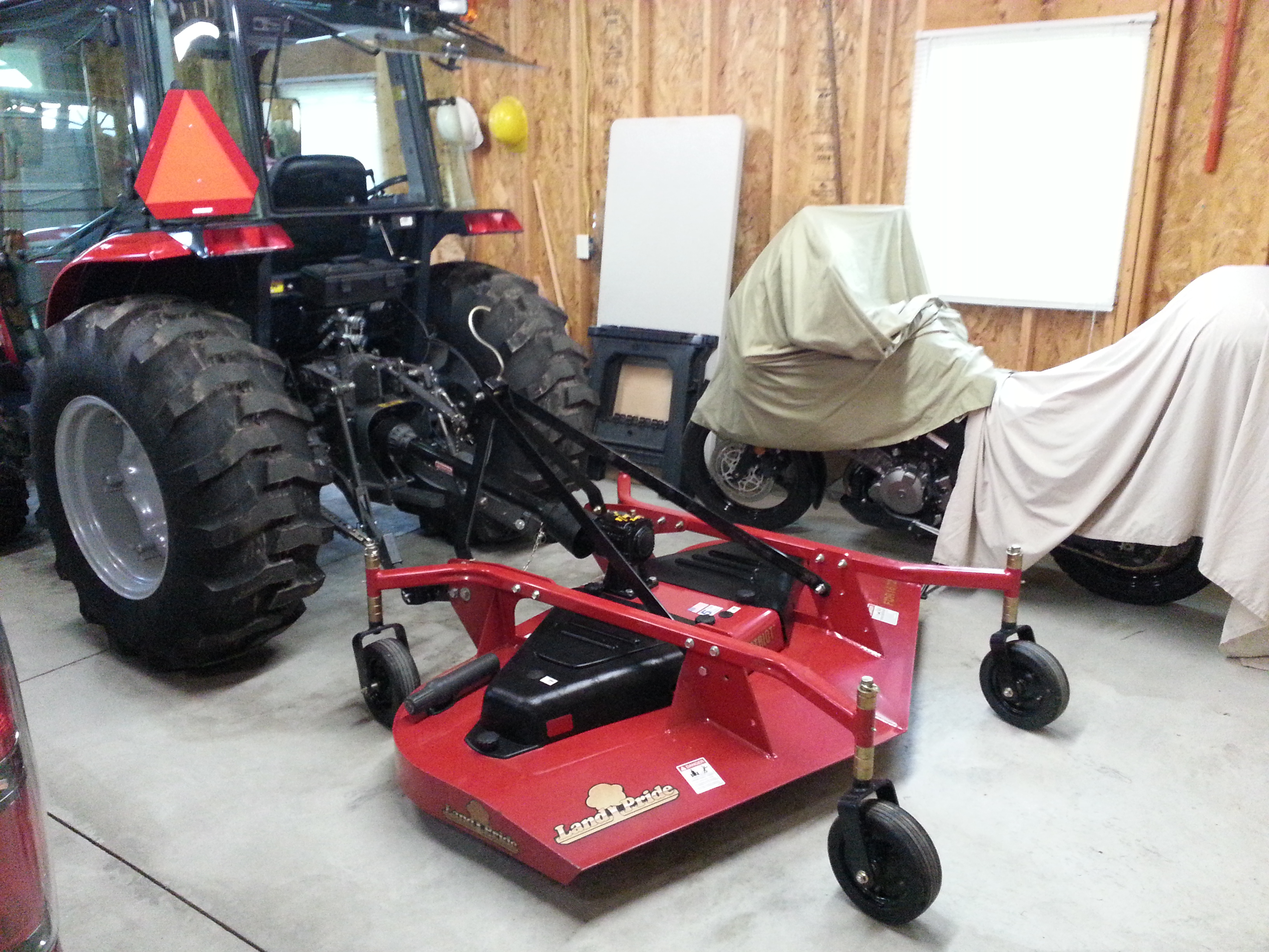

I've had both. Rear finish is my final choice. Easy to service, don't need mid-pto, can go much wider, many more brands and options available (side/rear discharge), and easier to hookup when the time comes. Only negative is storage when not in use.
   / mmm or rear finish mower #3
Rear Finish Mower :thumbsup:
