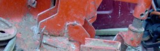

Got a $30. Kabota 60" mmm deck for a B7100 tractor an have realized I can not easily bellymount it on my Kabota L185 equivalent (gray market). can anyone with experience send me a photo of a conparable conversion to rear mount?
I should be able to switch gearbox 180 degrees. an have deck faceing forward correctly. ? Make rear wheels pivot or not.
all comments appreciated. Carl

Hi Carl,
Mid mounts often run at 2000 RPM vs the 540 rear.
Not sure about the Kubota.
Good luck,
Curt

Not sure how your PTO works, but on my B7500 the PTO speed is selectable.
Both my RFM's have all four wheels attached so they can swivel 360 degrees. Otherwise they will scrub when you turn..........chim

Kabota has a 4 speed PTO so hopefully I will be O.K.
thanks for the advice about the pivoting 4 wheels.
Now waiting on order of penetrating oil by Kono to get one of the wheel mounts unrusted. I tried a snap-on gear puller to push it out of the sleeve an puller deformed the sleeve an spindle did not even move. Just havin fun thou..Carl
