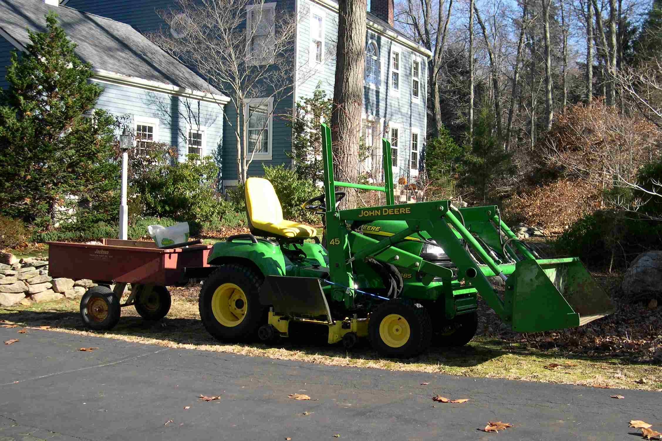

Had a JD X485 with a 45 loader before getting my BX. The X series should put out about 1,000 psi +/- 50psi, so the first thing I'd check is if your tractor is putting out the specified psi. You can do that with a gauge plugged into one of the loader quick connects. I picked up this gauge from Aux Hydraulics to test mine www.Aux-Hyd.com . Look under Products/tools.
After checking my PSI, I decided to shim my relief valve to increase max pressure to about 1,200 psi. Did a lot of research and decided it was not much of a risk as some owners shimmed their pressure up to 1,600 or 1,800 psi.
If you're interested in increasing your psi, I can post some links to other sites with info on how to do it.
