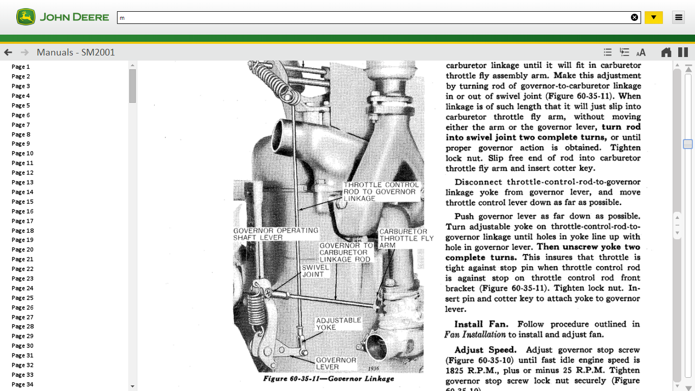

Thanks . It helped but I still can't get it to work. The gov seems to be over travelling and it rattles untill I pull it in a bit. Is there a pic somewhere of the linkages in that area. I'd like to check and make sure I didn't mix anything up but it doesn't look possible. Where can I find info on setting up these linkages?
   / Model m governor closes throttle under load #6
Might be an idea to find a service manual. If you keep the tractor, I'm sure it will come in handy down the road.
   / Model m governor closes throttle under load #7
Here is the image from the technical manual.
