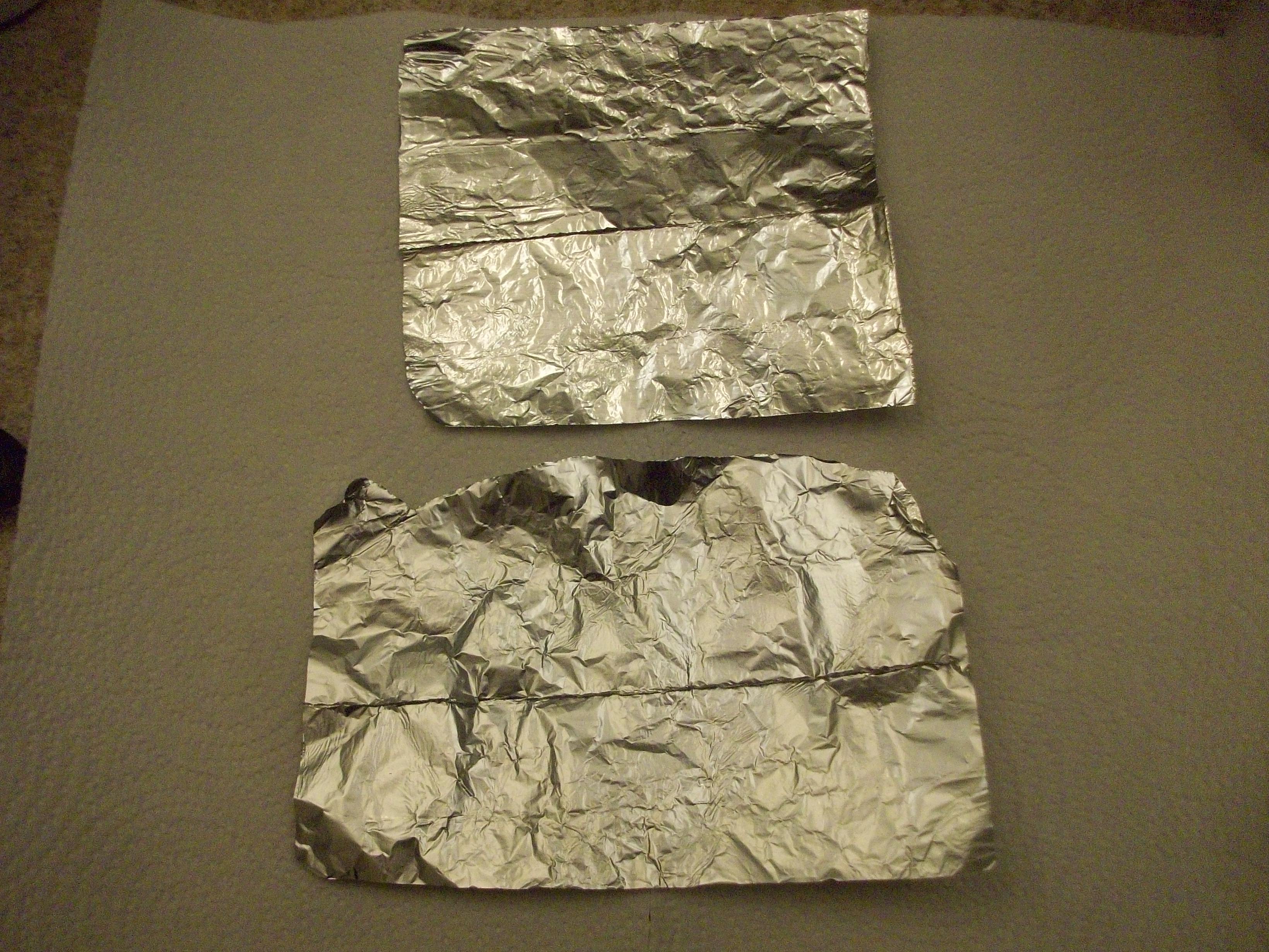

Not many new Affordable AC/DC stick / tig machines that can match it's welding power. 300 amps all modes @ 60% duty cycle.
Can also weld thin materials to -even aluminum foil.

Great for making TIN FOIL HATS. I had no idea a welder would do that!
