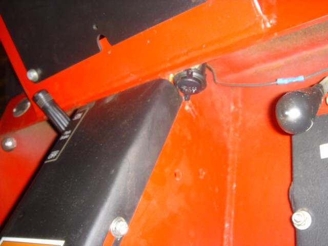

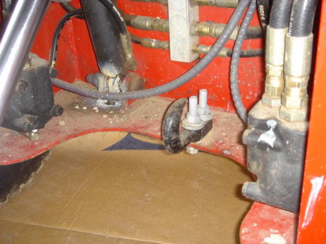

I added a mirror on the ROPS as well as a fire extinguisher. I also implemented some mods that I learnt here on TBN - I built a trailer hitch (thank you Fourteen), put a tow hook on the front (thank you MossRoad), and installed a 12v power outlet under the dash for my rotating beacon this winter.

A pic of the tow hook

And a pic of the 12v outlet
