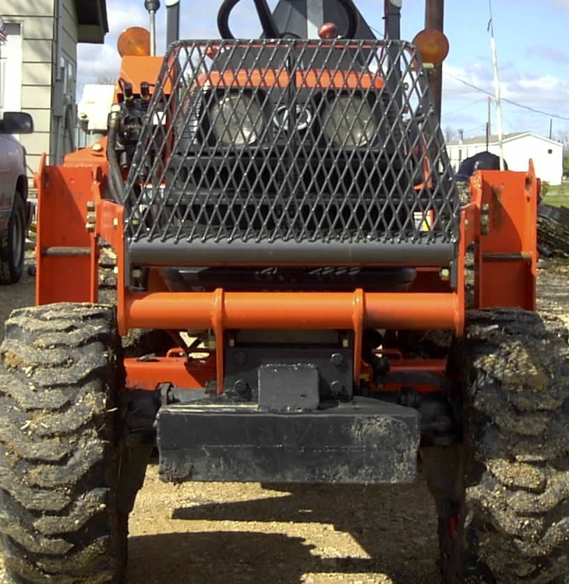

Here is a picture of a front weight i made out of square tubing and filled with lead. Also in the picture you can see how i modified the factory brush guard.I added a 2" id pipe filled with lead and a piece of expanded metal. Between the lead in the front weight and in the guard I have added about 160lbs. This allow me to have the FEL on or off and not have to worry about the front end coming off the ground.

Great idea /w3tcompact/icons/clever.gif now you have given me an idea. /w3tcompact/icons/wink.gif
