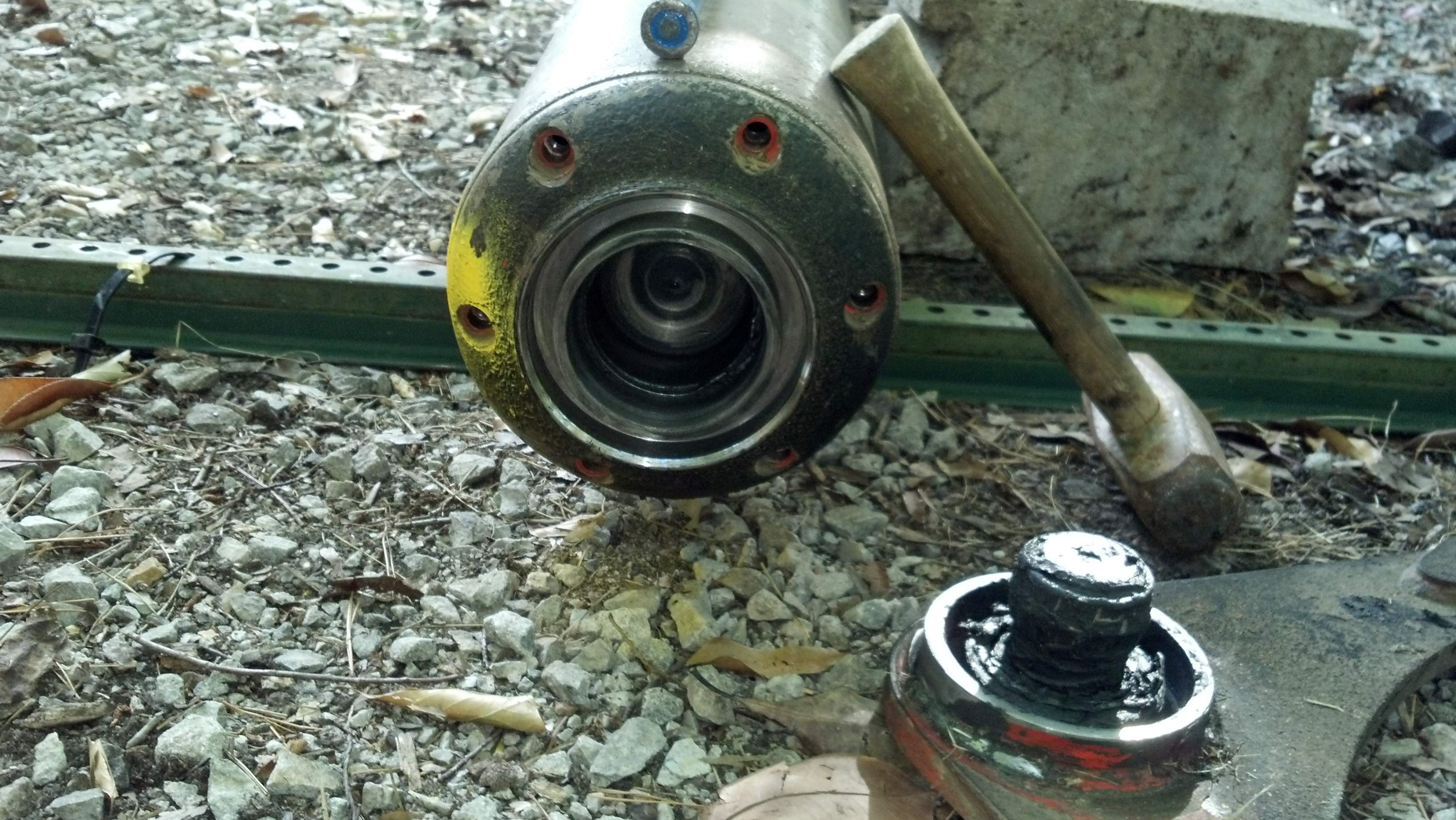

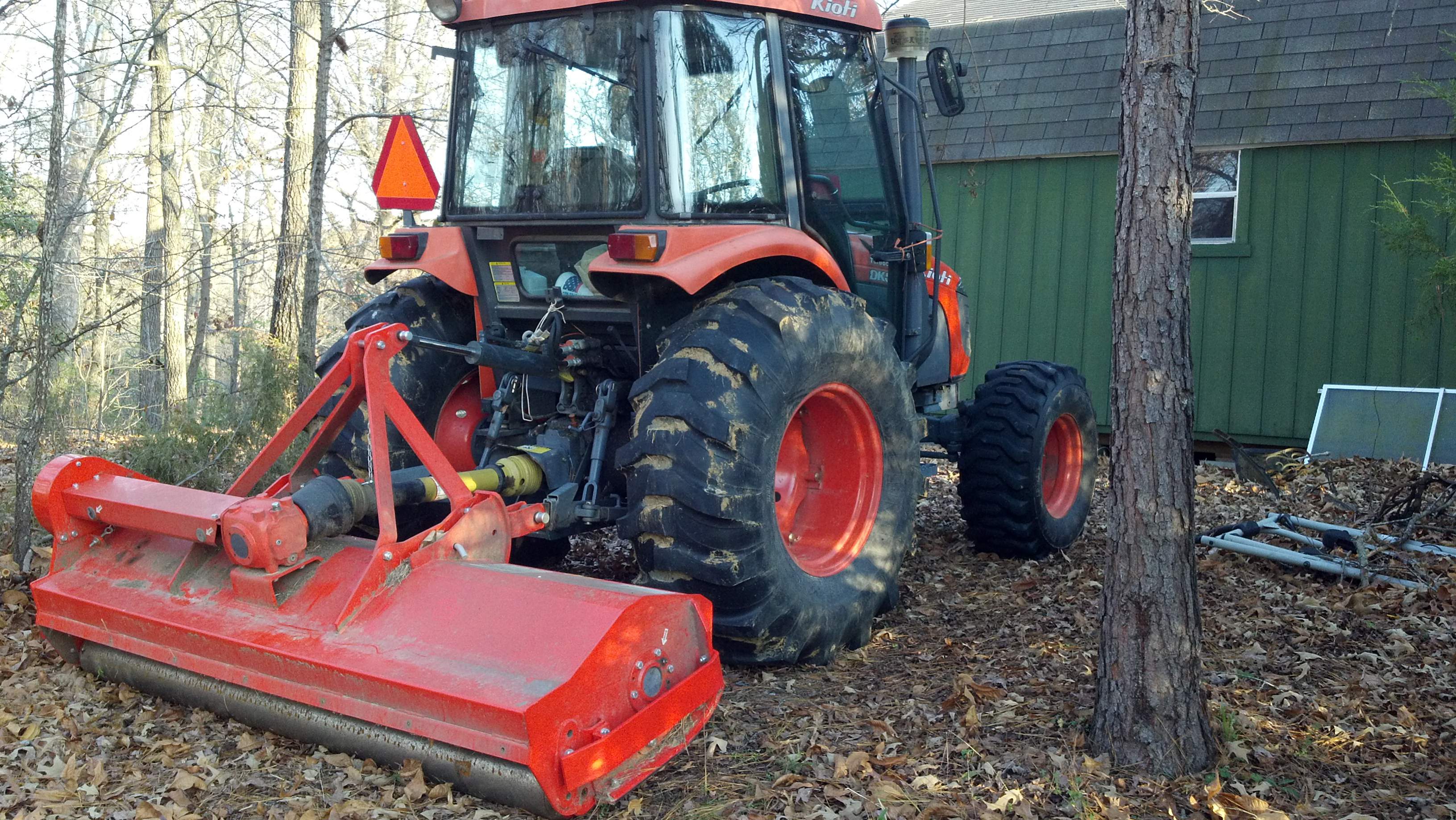

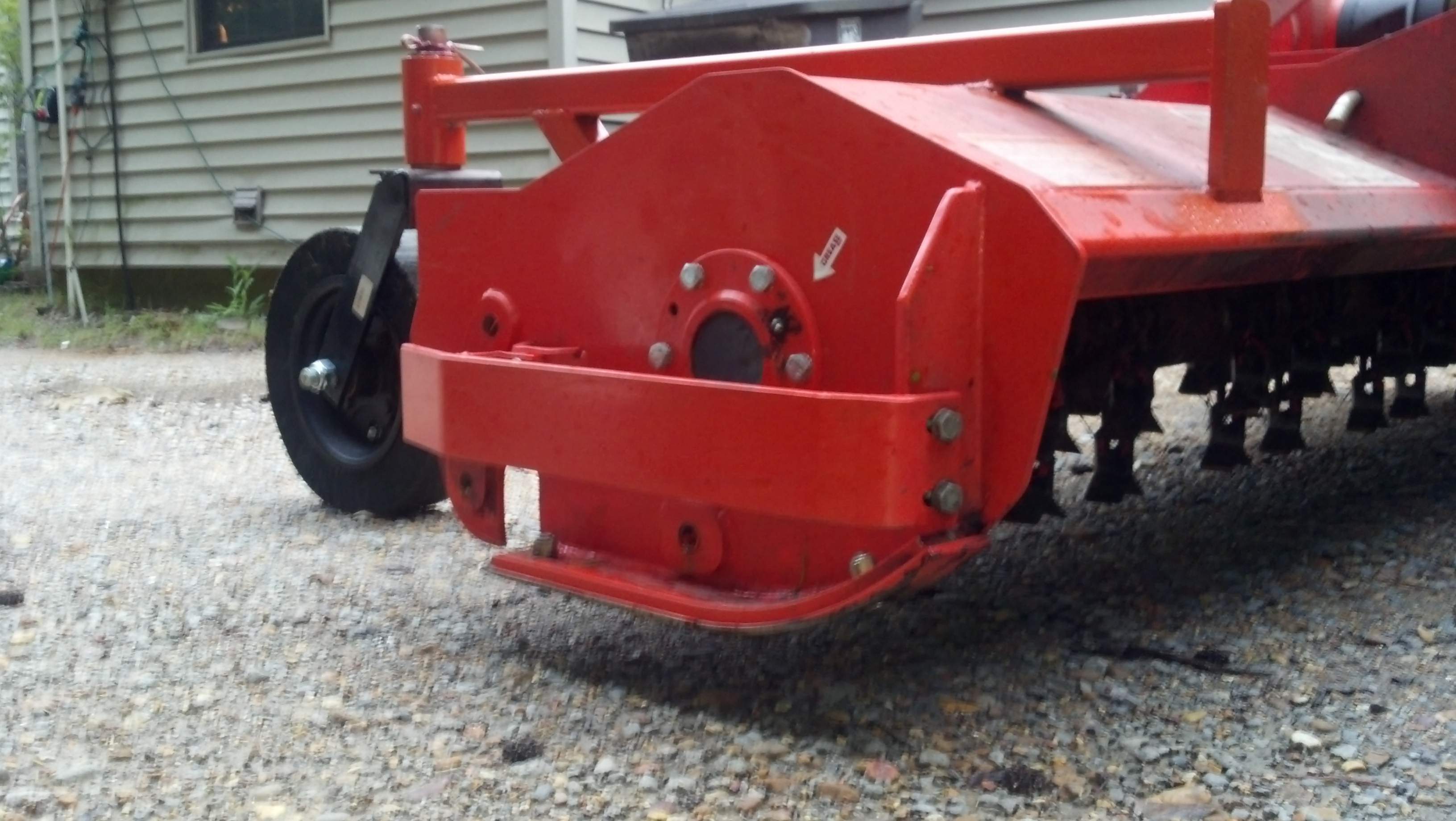

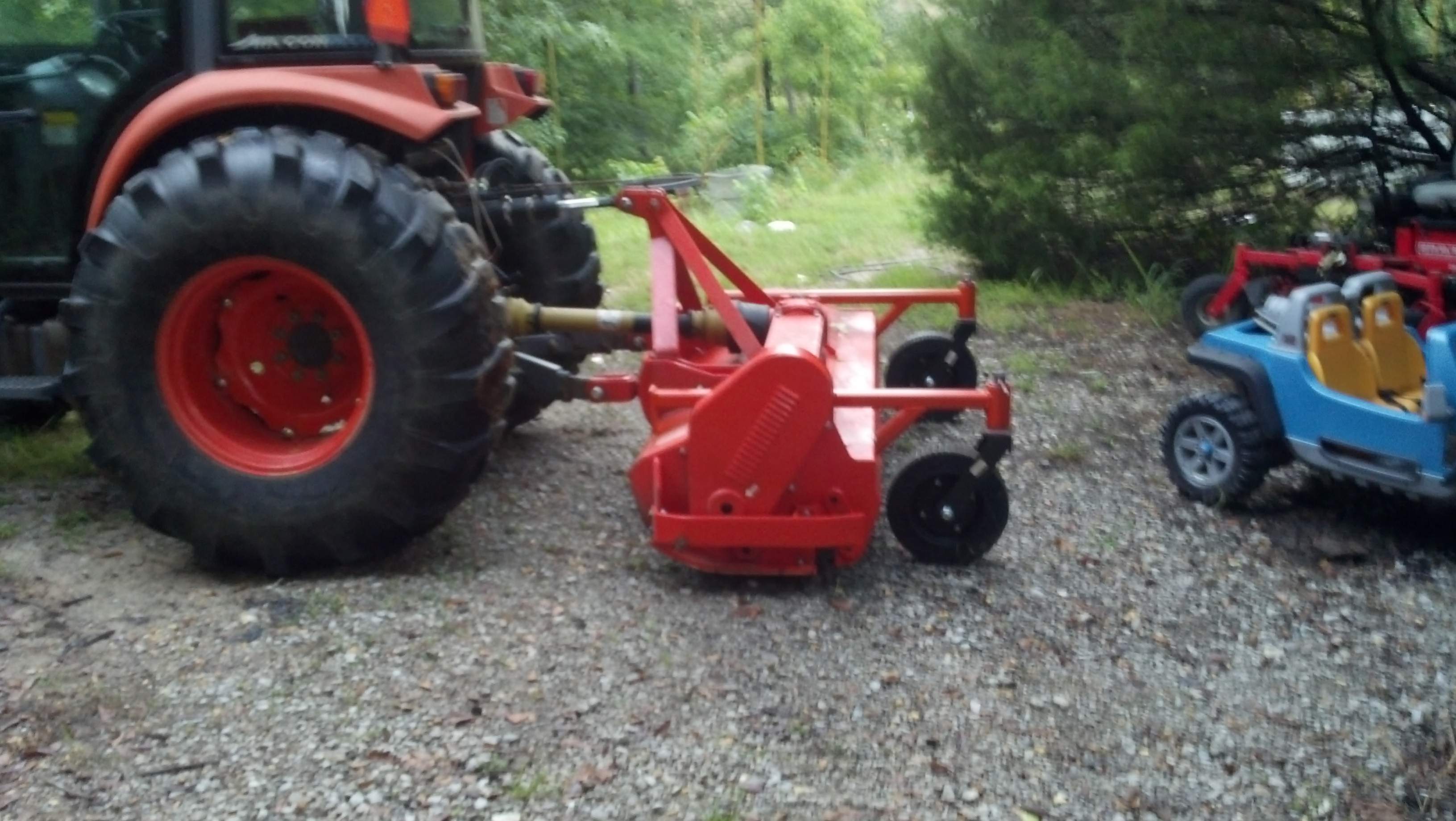

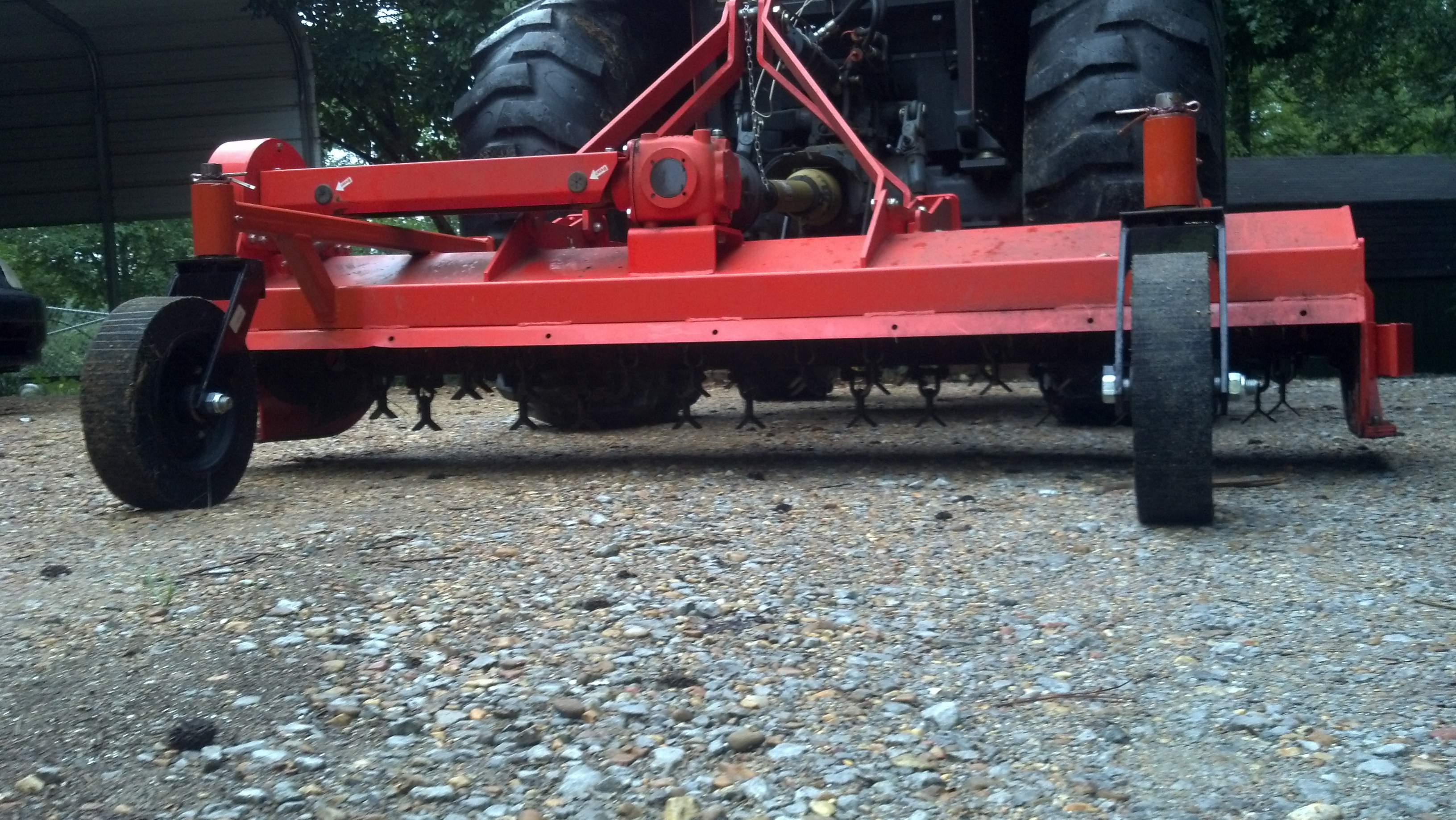

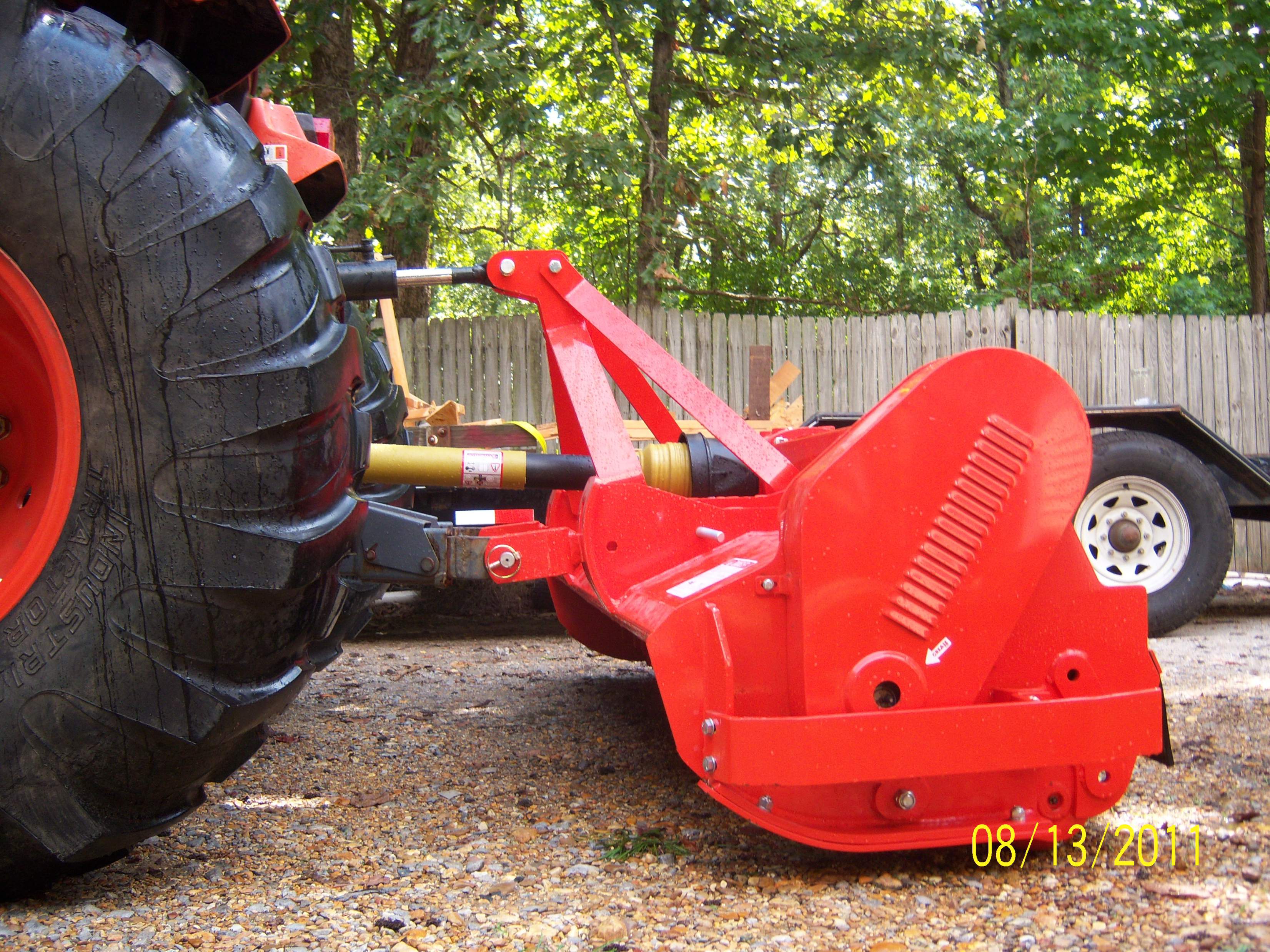

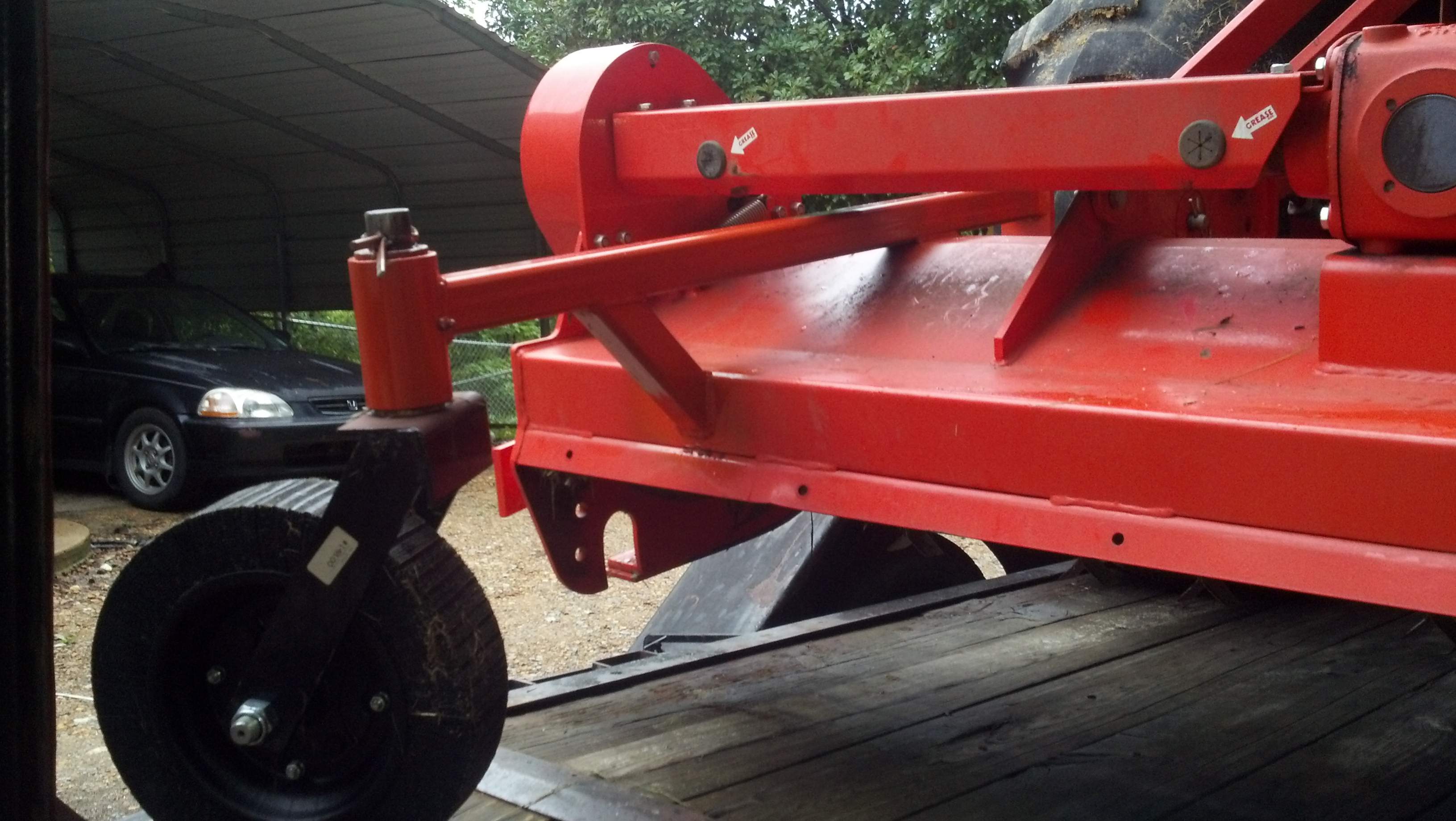

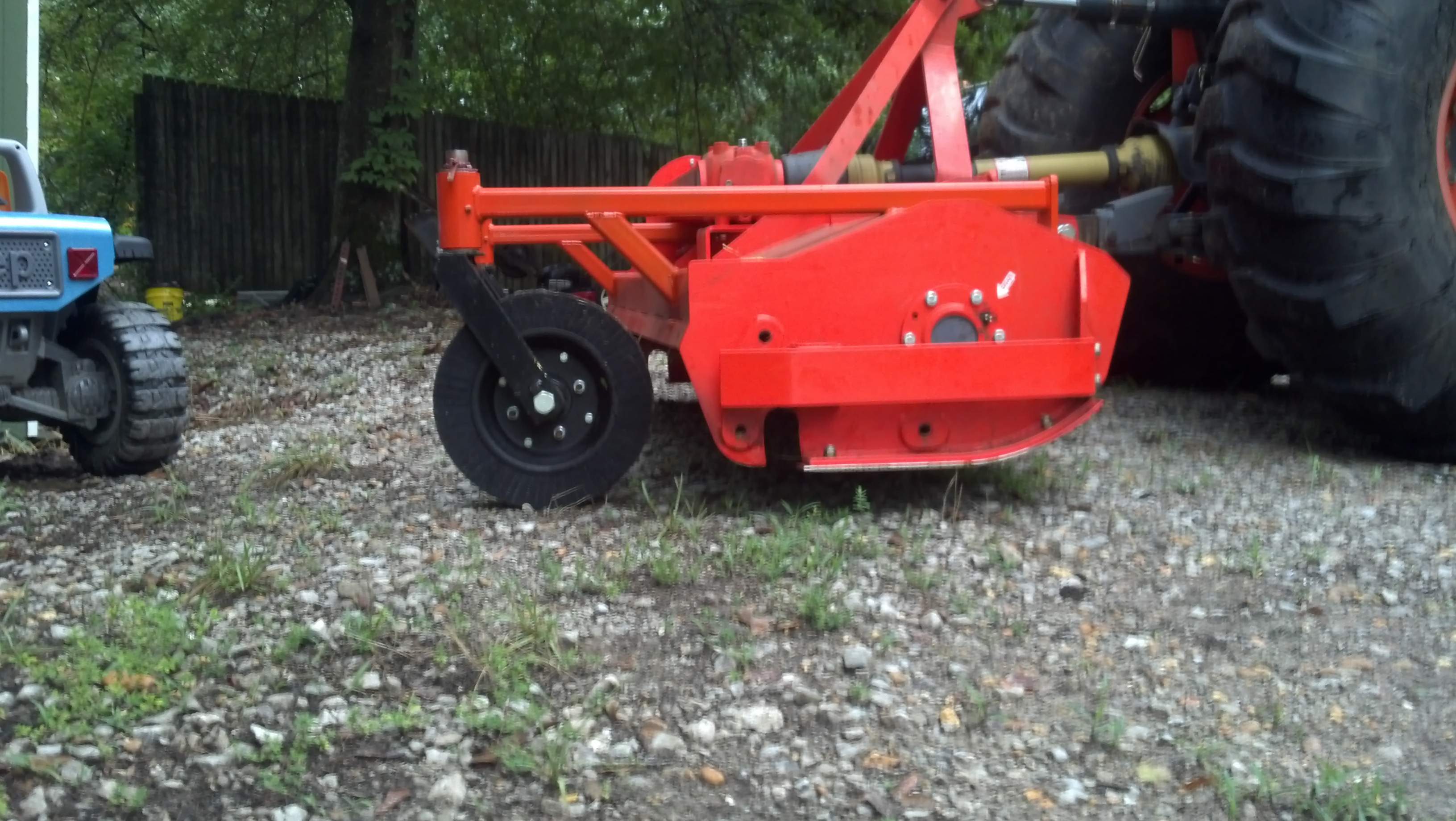

My flail mower is now a year old and it has already had a barring go out in the right side roller, I figured that if the amount of greese ive put threw these barrings isnt going to keep going at least a couple years i might find a better more reliable set up rather than repairing the roller barrings every six months. and this is what ive decided to do.
before and after pictures.

I'm surprised a bearing would fail on the roller, they turn pretty slow after all. Could be it was just a bad bearing. My flail is probably five years old and still has all original bearings.
I am curious where you got the wheel arrangement from. I have thought of putting something similar on my snowblower to keep it out of the gravel early in the season.

In most cases flail rollers barrings will last years. but im using mine to make a living and it get used sometimes 5-8 hours a day . the side that goes out is the side that i trim the bottom of ditches with and in the spring time the ditches are wet and i think water and dirt are gitting in.
I could have just replaced the bad barring but i was wanting to change to wheels ever since i started using the flail mower this just gave me the excuse , now that the roller is gone i can now mow going backwards and it also discharges out the back without being stoped by the roller.
i left everything to ware i can still put the roller back on if i need to and remove the wheels, but for now its never mowed better in tall grass.
I just when to a tractor supply comp. and bought replacement bush hog tail wheels and forks and went to measuring and welding.

We don't have a Tractor Supply anywhere near where I live but that's a good idea for wheels. I thought about putting sockets on the snowblower then just taking two wheels off my finish mower. Won't ever be using those two attachments the same day.
Do you find your flail throws debris a lot farther without the roller? One of the things I like about the flail is that it doesn't throw things very far.
   / Modified flail mower
for me the most important thing is the flail mower doesnt throw things out the sides and back at my tractor, my 6 foot rotory cutter broke my window out on the second day of moweing thats when i decided to get the flail. my flail mower rotates the same direction as the tractor rolles and the roller definatly caused problems with the discharge to the point it would choke down the flails. now the discharge is strait out the back. I gues i could re attatch the rubber deflecter strip that came with the flail mower if i find the need to control the discharge
