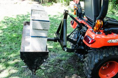

   / Modify Pull-behind aerator to 3PH Aerator? #5
I have a Brinly tow-behind aerator and a disc harrow, also Brinly, that I've converted to use with a 3pt 2" receiver. I had used both behind my JD lawn tractor. Cut a piece of 2x2x1/4 to length, drilled a couple holes and mounted the aerator to the 2x2 and then the disc harrow to another piece of 2x2.
Added threaded rod to the aerator and disc harrow to hold down the cement block weights.
So far this set up works very well for me with my Kubota BX2370.

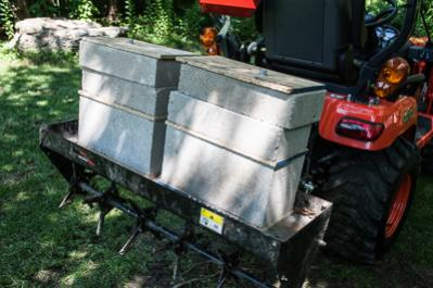

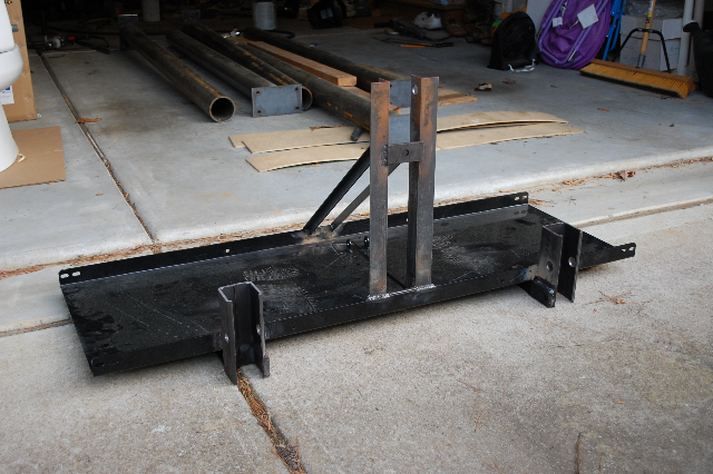

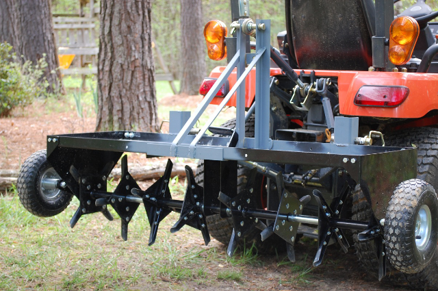

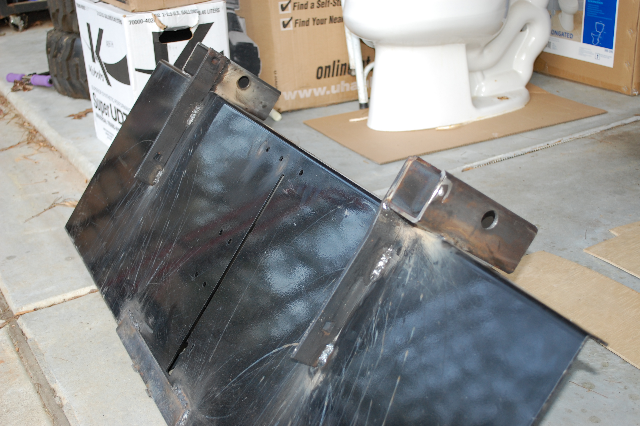

   / Modify Pull-behind aerator to 3PH Aerator? #10
I converted a cheap pull-behind aerator to 3PT using some scrap steel and my beginner welding skills. I made a couple of concrete weights that fit in the tray to help weigh it down. It works real nice.
