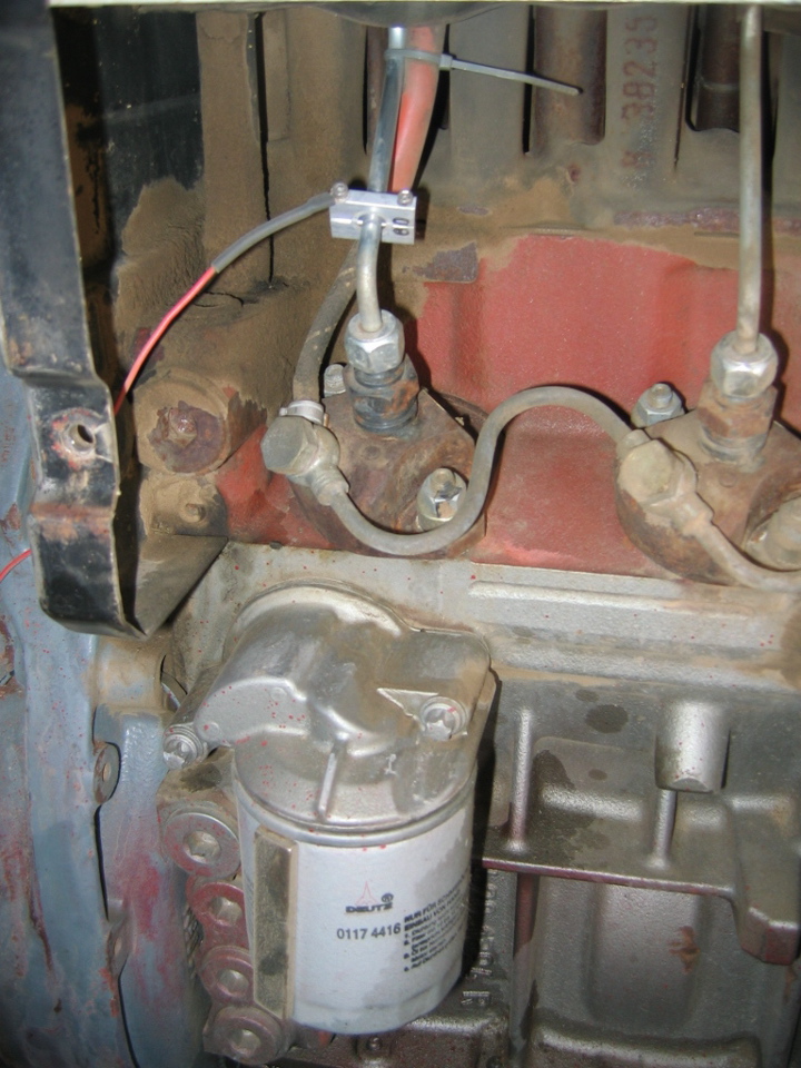

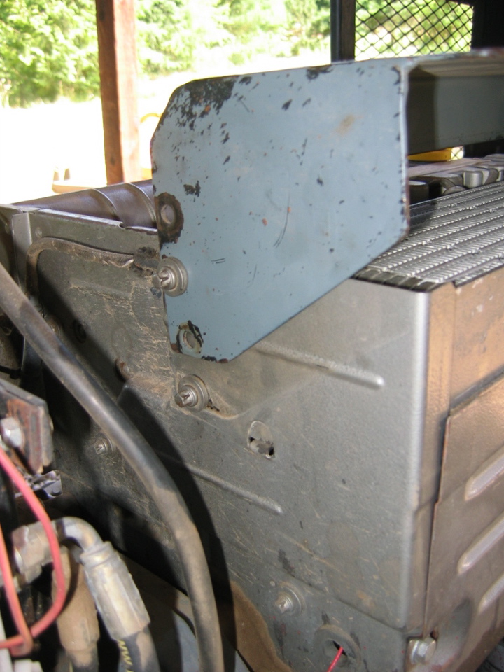

First up was to open up the oil cooling baffel. It is Part 1 of a 2 part idea. From what I understand you do not want to restrict the outflow of air from the cooling. PT's 1850 engine is heavily restricted. The opening being just half the surface area. At first I was going to cut up some tin and make a whole new baffel, but then I saw Alta's mod and it gave me an idea. In my head opening the sides allows the air to stay in the engine compartment. Also, I cannot weld yet (have welder, just no real ability). So I drilled a hole 1.5" down the side plate, and then took a peice of 1/2" gas pipe and cut a 1.5" spacer.. 2 bolts and $3.00 later....
Part 2 of the idea is figuring a quick way to open the bottom plate to allow cleaning. Also, I have noticed some air blowing up by the injectors, I figure if I plug those holes up I should force more air through the cooler...

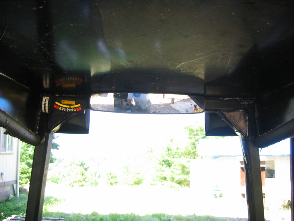

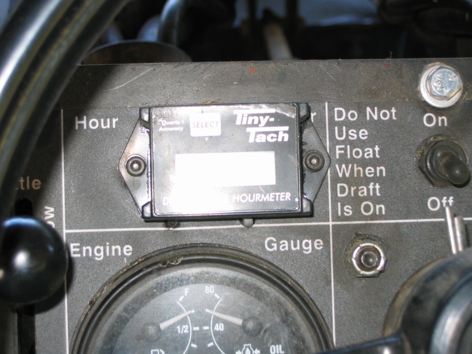

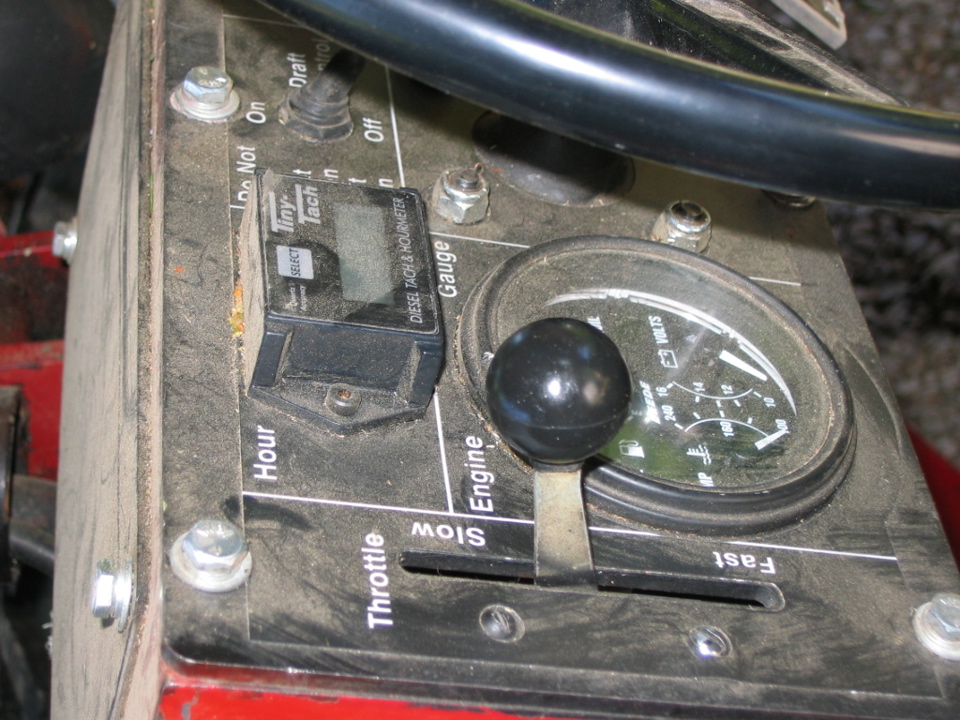

Next was the Tiny Tach. $65.00. On the 1850 I nearly did not have enough cable so order 3 extra feet...
I did a poor job of finish work on the installation. I could not cut the dash plate good enough, so I surface mounted it. It works quite nicely and now I can guage the power I am at much more precisely. Also it has 3 timers so I know for sure when to do my 8 and 50 hour maintenance...

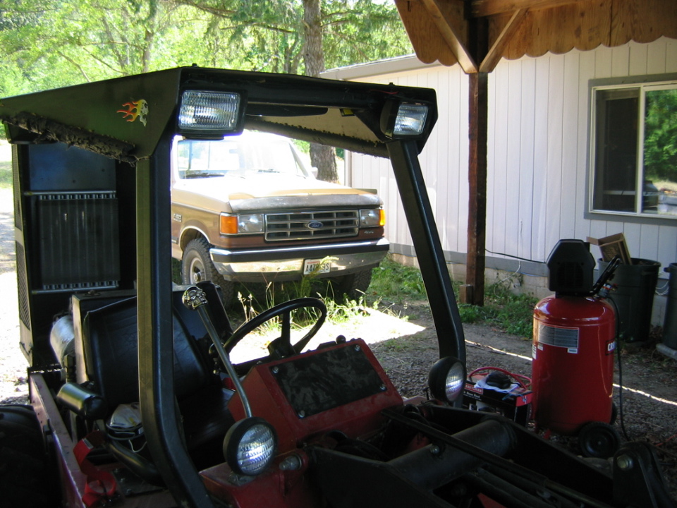

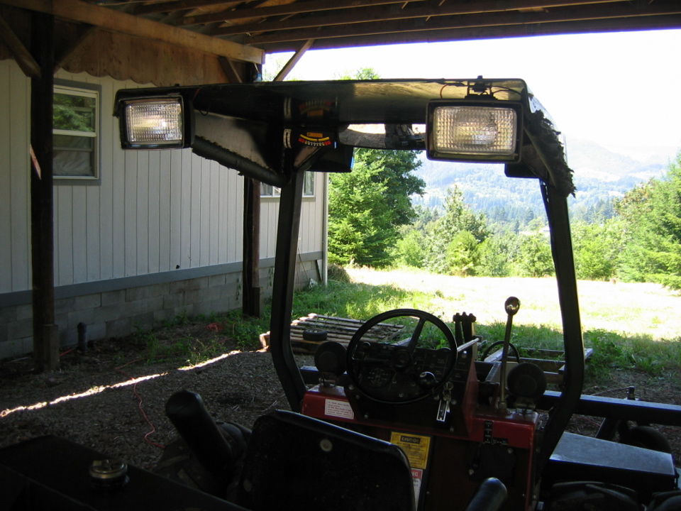

Mirrors and Lights. Mirror was out of JC Whitney and I just drilled two small holes through the roof (not the rops) to install... It is kind of hard to look at it instead of turning around but I am sure I will start using it more. Lights were cheapies from Gemplers. I think if I where to do it again I would go Ksimolos way, I think these pull too many amps and there are more efficient lights to be had...

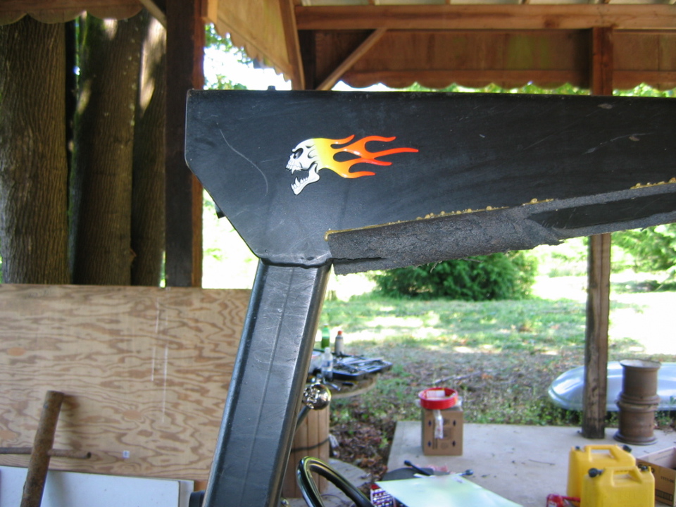

Neighbor scarers. One of those I just had too's. Notice my foam head bumpers? They are completely trashed after just one week.
I just have to figure out a cup holder. Anyone know where I can get those old style basket ones that swing around? My current holder does not work on the slopes...
Careful with those bolts. They are all that holds the oil cooler metal-to-metal seal to the engine. I found out via an inadvertant oil change.
   / Mods, Round 1
I had remembered hearing of your tale before.. So I did not bump the thing when I removed it, and the 1/2" pipe works as a great hold down (so far, have yet to drive it without the steering).

Raising the defelector over the engine oil cooler will help, it made a difference on mine.
Whats the PN of that Tiny Tach?

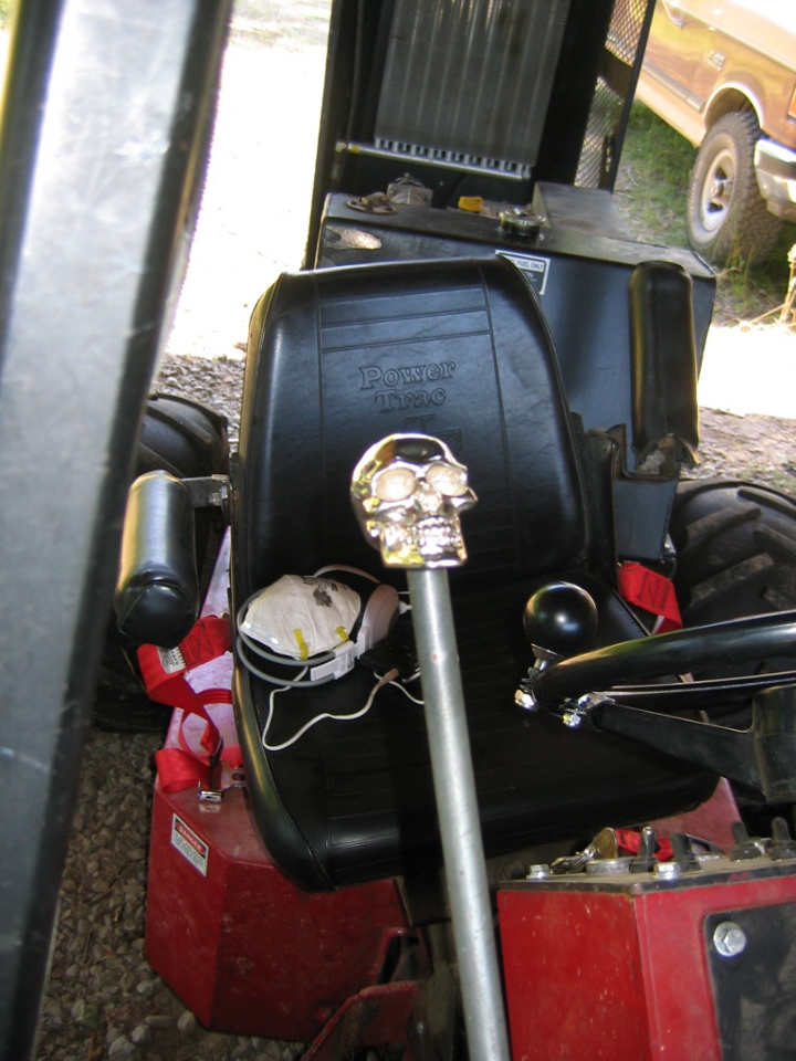

I love the skull on the hyd joy stick, reminds me of the drill outfit in the movie "Armageddon".

Dropped my temp by at least 20 degrees. I am going to fill up some of the cracks with aluminum foil (where the injector lines run out) as there is a lot of air lost there...
You will totally love the tiny tach....
