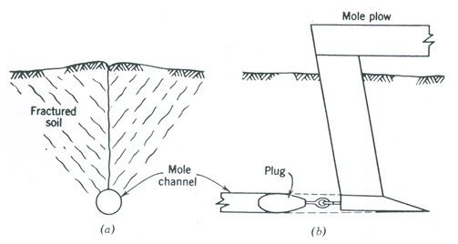

I need to drain some pasture areas, and had basically decided I needed to buck up and put in some drainage tile. In my efforts to learn more about it, I kept seeing the term 'mole plough' tossed around. I thought this was simply an odd term for a subsoiler... but I found out I was completely wrong.

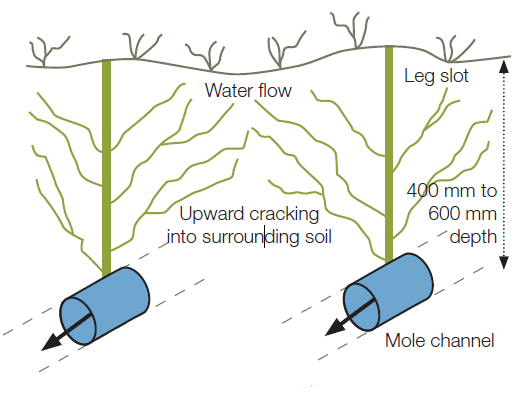

Apparently, the term is specifically related to an implement which is very similar in appearance to a single or double shank subsoiler, however, the use of it and its function are very different. Whereas a subsoiler is designed to break up hard pan to allow water and root infiltration, MOLE PLOUGHS are designed to break up the soil a little, but to a GREATER DEGREE, they are designed to create a 'dirt pipe' through which water will 'run'. (This is my understanding of the basis... so "you in the know" tell me if I am wrong.
Basically, you have a thin, sharp and long shank onto which is welded a 'torpedo' shaped end rather than lifting tooth. Behind which, a larger 'bullet/expander' is attached which slides through the hole, EXPANDING and SLICKING the sides, in an effort to create an underground waterway. Basically mimicking Drainage tile, without the pipe.

The ones I've seen were a bullet-shaped piece pulled behind a subsoiler-style shank.

My dad used one on our farm in NZ many years ago. We had some wet paddocks and a creek that ran through the middle of the property.
He put the plow in at the creek and drove up the paddock. He did that every 20 feet or so. We used to watch the water flowing out the bottom at the creek so they did work well. The mole on the end also had a pinned link that could flex and it widened the hole slightly more.
