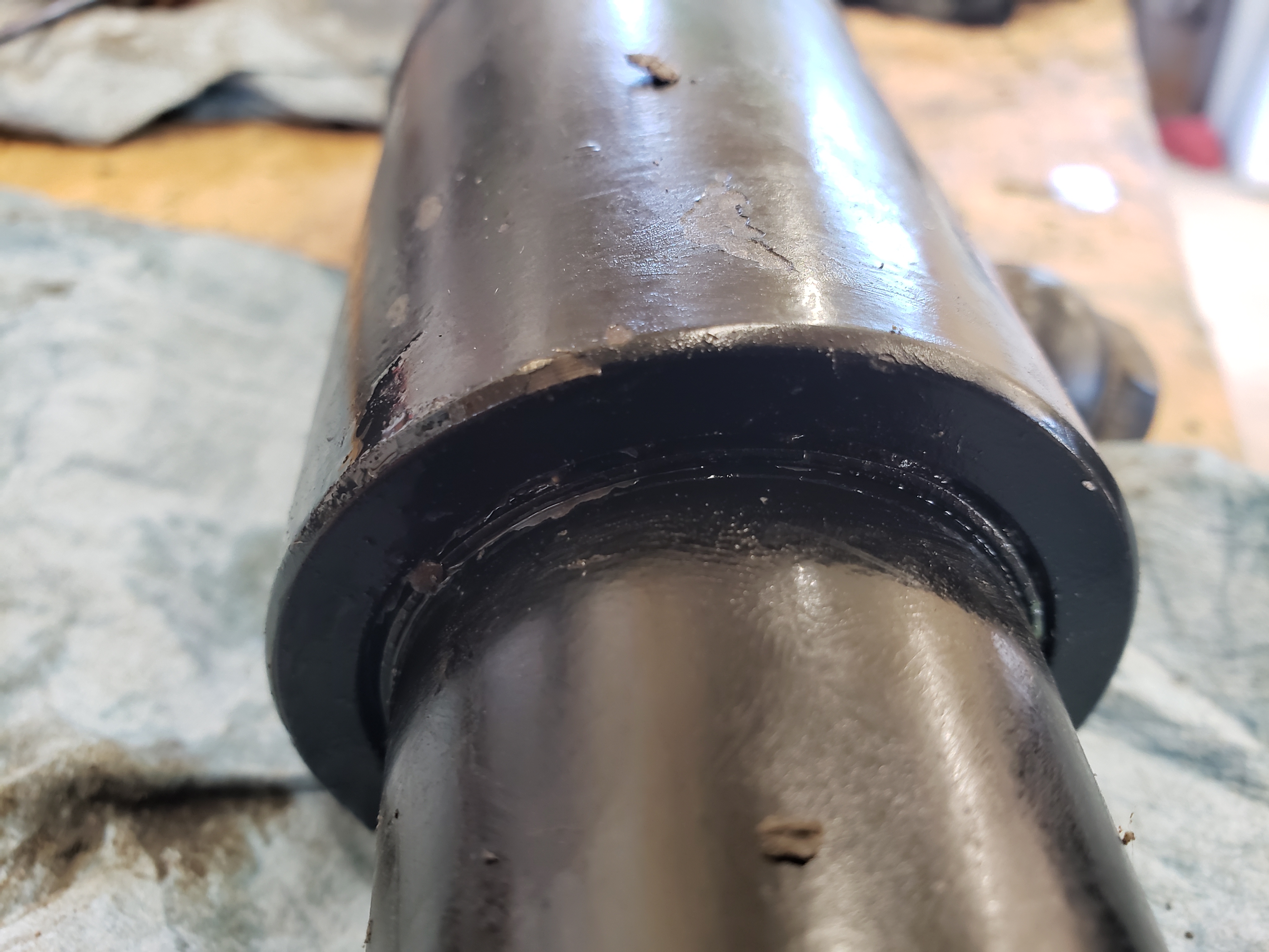

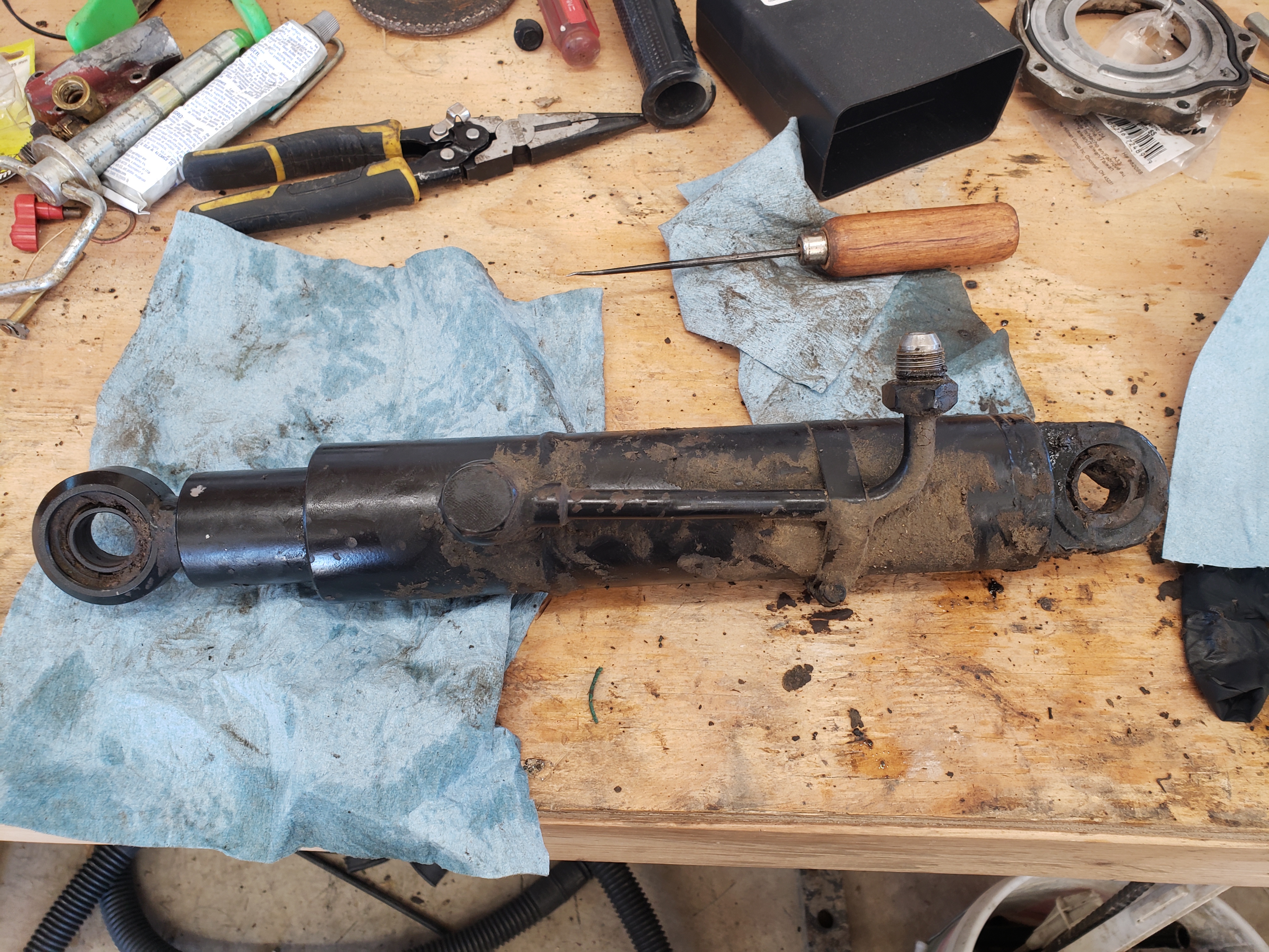

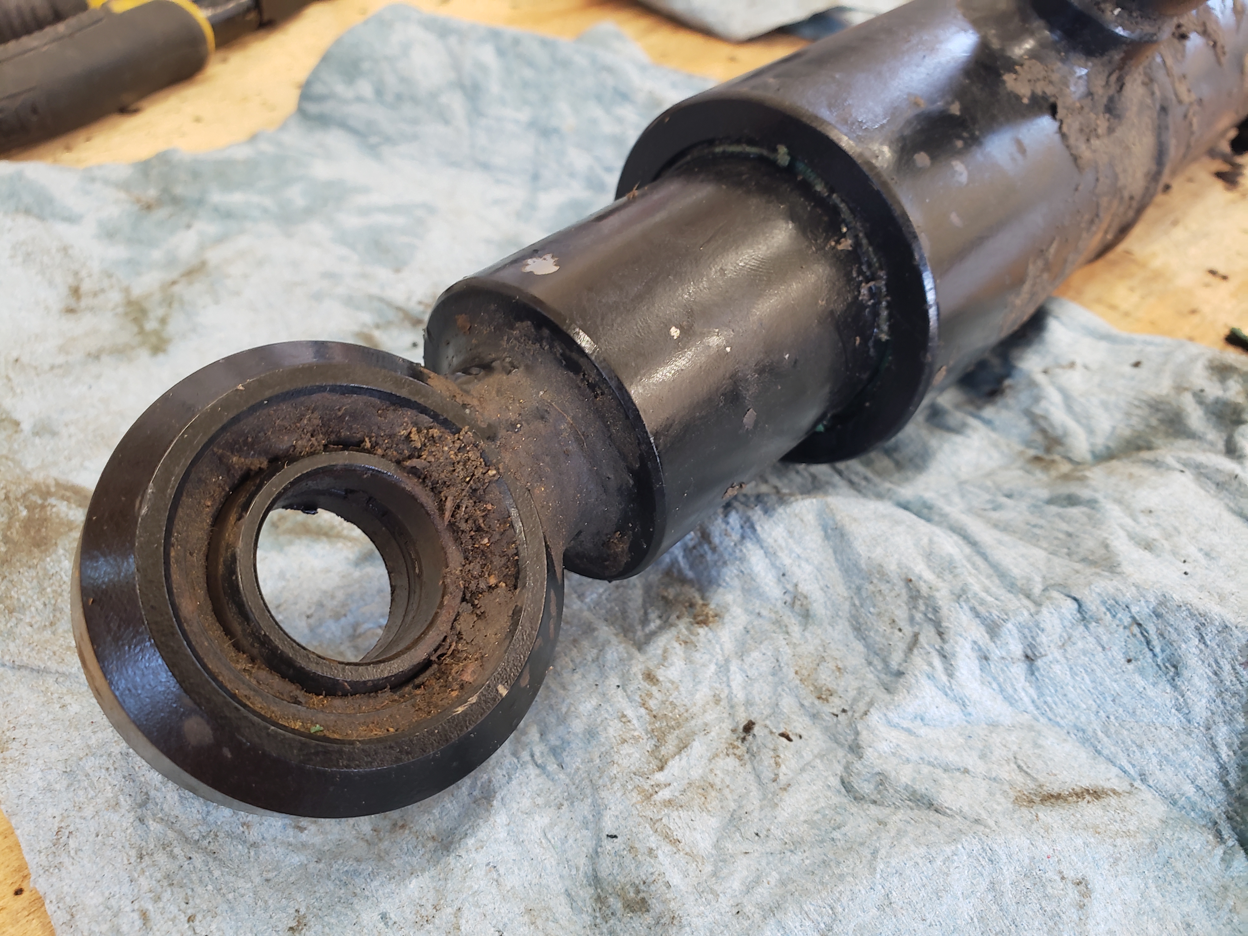

I have a steering cylinder that is leaking on my Montana 4340. I can't figure out how to disassemble it so I can replace the seals. Everything I can find online about rebuilding cylinders they have a head that screws off. This cylinder appears the be one solid piece that doesn't come apart. Would someone be able to point me in the right direction? Thanks!

Take off that hose with the bango fitting and you will see a snap ring on the end of the cylinder. Remove that while it’s in the bore and then it will come apart.
When I did mine I never could figure out a way to assemble it with the snap ring so I left it off and let the steering stops keep it from ejecting the cylinder
