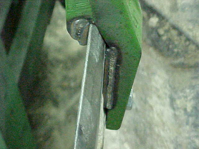

Well this all started when I was talking to my father on the phone the other day and found out he had a set of teeth for a bucket on one of the John Deere tractors he no longer owned. I of course got my hands on them as soon as possible to find out if they would work on my Westendorf TA26, 72" bucket.
There were 9 teeth in all and they were for a bolt on application.

I found that the teeth were for a bucket with about a 1" thick cutting blade. Since my cutting blade is 1/2" thick, my solution was to weld 2 - 1/4" thick spacers to each tooth, 1 over the blade and one under the blade instead of attaching them to a long piece of steel, thereby making a tooth bar. This was simpler as I did not have to angle cut the steel bar to match the angle already on the bucket.
Since the spacers were the same width as the tooth, there was no grinding required and the bolt on feature is retained.
