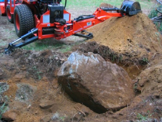

OK, this is what happens when Buttercup goes out with the girls and leaves me home with nothing to do and a full tank of fuel. Years ago my dad told me those rocks in the garden out back are too big to pull out. He was right. I got into the same bind about a month ago but I can't stop once I start digging.
The hoe - a Woods BH6500 can pull out rocks bigger than the FEL (LA352) can lift and then what do you do with the rock when you pull it out? Last time around I drilled the rocks and used a plug & feathers. It worked but was a pain in the neck and I don't know if I have an extension cord long enough to reach out back.
Hmm. . . . I could dig another hole and bury it but that kind of defeats the purpose of digging it up. I'll probably plug & feather these also.
I guess the real problem will be tomorrow when Buttercup sees the hole & spoil piles. /forums/images/graemlins/cool.gif
Check out how I put the bucket on top of the spoil pile like I saw the guy digging a foundation down the street. I have no idea what purpose this serves but it looks cool. I just pretend like I know what I am doing my neighbors think that I do. I have 30 hours so far. /forums/images/graemlins/grin.gif

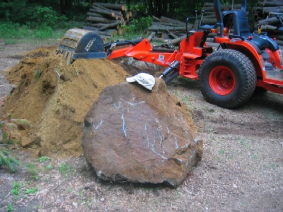

Oh, ahd here is the rock I pulled out of the hole while digging for the rock I wanted to pull out. My hat is on top of the rock for scale.

Skidmark,
how do you like the feeling when the bucket teeth skid along the rock, pretty good isn't it, like finger nails on a blackboard. When the stones are too big to pickup with the loader bucket you can usually flip them over and over. It takes a while but with patience you can put the stone where you want it. A skid plate works good too if you want to drag them. If you have bucket hooks you can loop a chain around the stone and I'm told this helps tremendously to stop it from sliding out of the bucket. I'm still working on getting hooks so I use the flip method.

Not much strain on the tractor except when I used the hoe, just stopped dead in its tracks when I tried to use the FEL.
I'll try and drag the small rock with a $20 tow strap I bought at Wal-Mart and maybe try to flip the big one.
