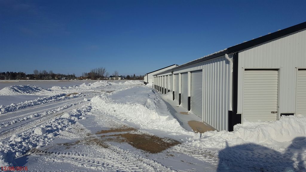

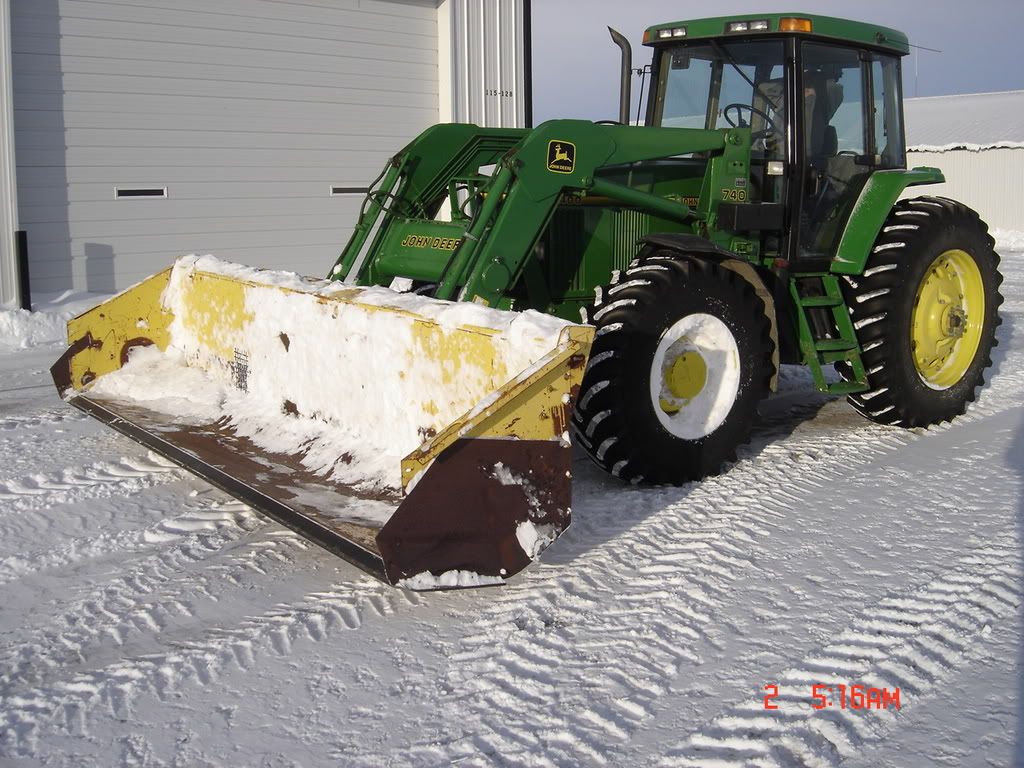

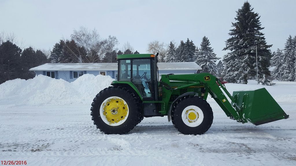

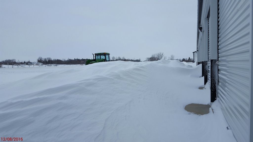

First, thanks for all the suggestions so far. Some have asked my application. I move snow at my self-storage business. My yard is 6 acres with 11 buildings that are widely spaced. I use my JD 2520 with front mount to get real close to buildings but the blower should be higher to handle large drifts and snow that ridges up next to buildings when I use my big tractor (JD 7400). With my JD 2520 I can really get close to the buildings and doors as I have great visibility and great speed control with the hydro but it sure would be nice to have a bigger tractor/blower and nicer cab. My big tractor is JD 7400 (100 Hp). I use it with both a 8' snow bucket for deep and hard drifts and I also have a 13' bucket for lighter snow. I move lots of snow after big storms. A few pics are attached. In the summer I mow about another 5 acres with a Woods RDX 90" finish mower. The ground is quite rough so I like a tractor with big tires. I can use the JD 7400 but would use a more intermediate size if I could find one that accepts a front mount snowblower. The Lorenz and Erskine PTO/hydraulic drive suggested are options but not as clean as a the one on my JD 2520. Any new suggestions will be appreciated.

I really like my 13' snow bucket. It is the best attachment I have ever built. Some still spills off the ends but it pushes a ton out front. Under certain conditions, I feel it moves 4x more snow than my 8' bucket. I also like being able to make my piles much higher than I could with a snow pusher.

The biggest gain is in the width. It promotes for a large volume of snow to push out in front without a significant amount spilling off the sides or over the top. Also, I have gotten real good at timing my lift at the pile to push that volume of snow up on top of the pile to reduce "pile spread".
