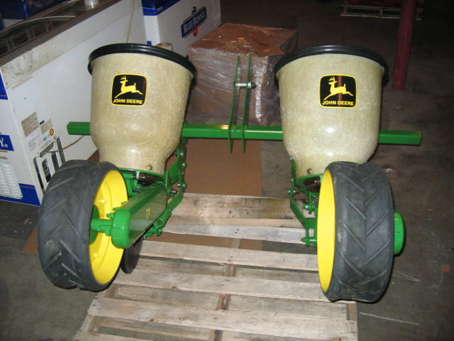

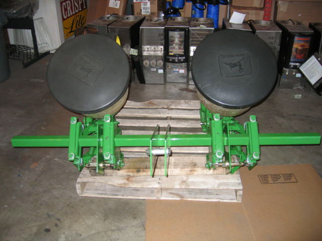

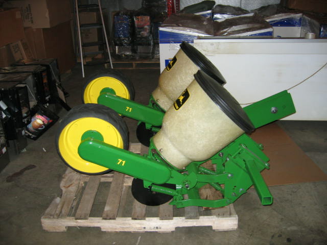

Dig around on Ebay for a while, you are bound to find a JD 71 Flexi planter in one or two row configuration. I paid about $800 for mine (with shipping) a couple years ago. Mine is a 2 row unit, mounted to a Cat 1 3pt tool bar, with the larger fiberglass seed hoppers.
  • 71 adjustable tool bar:hitch.jpg
