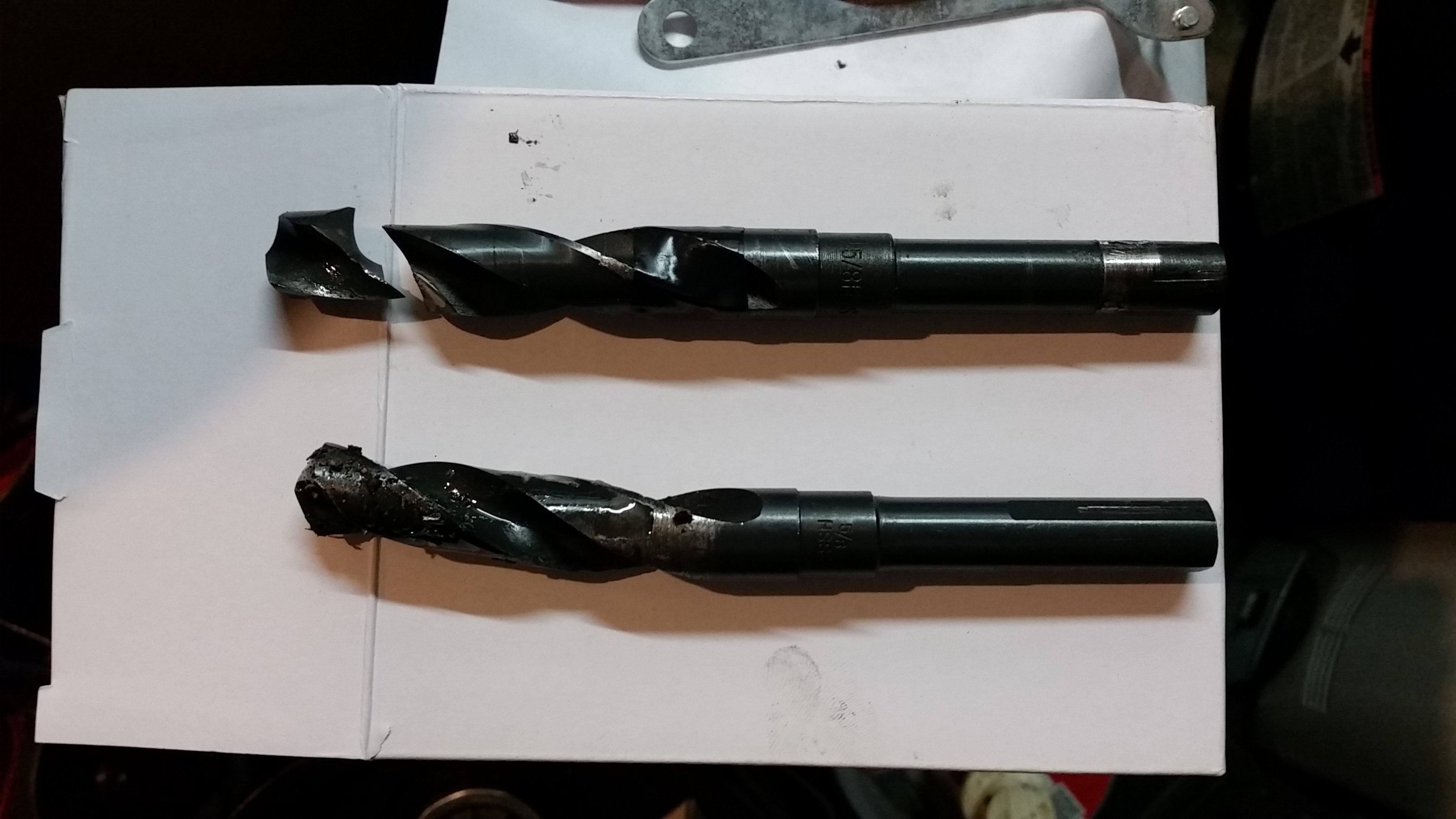

Next bright idea was to take my super high torque low speed drill and open the holes up (that don't perfectly line up - some of you know what's coming next) with a 5/8" bit.
I get maybe a little over an inch in and the bit binds and I get it jammed. I try reversing it and the bit breaks off in the hole :shocked: I sat there just staring at it wondering how in the world I was going to get that out with visions of having to remove all of the painful stuff I mentioned above.
So I researched methods others have used to remove big broke drill bits from blind holes and was about to attempt one when I went back out and looked at it again. There was a sharp shard of the broken bit that actually stuck out of the hole just a bit. I grabbed it and noticed I could wiggle it. At first I thought it was just a small part of what broke off but then I noticed the whole thing was connected and moved a bit. Starting to get happier! I got my welpers (mig welding pliers) and reached in there on either side of the flutes and was able to grab it and wiggle it out!
I had a spare 5/8" bit so I lubed up the hole and the bit with cutting fluid and decided to tempt fate again. When it caught again, this time it bent the drill bit! Defeated, I gave up for the night.
Next day I go to one of our local suppliers and buy a US made bottoming tap and US made 5/8" HSS bit. That evening I ran the taper tap in one more time just to make sure the drilling I did didn't hose something up. Next I ran the bottoming tap to finish tapping all the way down the hole. After cleaning the hole up I decided one more time to run the new bolt in and to my surprise it cleared the sides of the hole and ran all the way in. The previous night of drilling opened the hole deep enough so the bolt would clear. What a relief!!! I didn't even care that I didn't get to use my new shiny $20 US made drill bit!

Here's a pic of my destroyed drill bits:

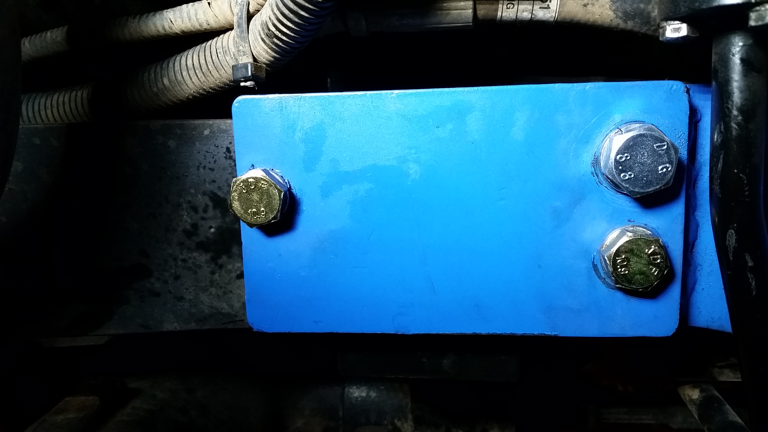

Loader reinforcing plate bolts (one of us is not like the other one):
The original bolt is a M12 1.75 thread pitch. New bolt is M14 2.0 pitch. The new M14 is 8.8 grade and if memory serves me right can be torqued to 134ft. lbs.. My plan was just to tighten to the original bolt spec in an attempt to have the same clamping force as before. My Mechanical Engineer friend said the greater surface area and 2.0 thread pitch will have more clamping force at the same torque than the old bolt but we didn't do the math to determine what it would be ... he said it would be in the ball park and close enough.
So the pucker factor was quite high at times but it all ended well.

I hate when things break in a hole like that. I've removed bolts by welding a nut to what is left. I wonder if that's possible with a drill bit.
   / More loader mount bolt drama
Actually that was my first thought ... to weld a rod to it and try to wiggle it out.
It sounded like the best method I read about was find two old drill bits with a diameter that would fit in the hole where the flutes are ... two of them, one on each side.
Then cut the flutes off and use as pins. Either clamp something to both pins and try to rotate or get two people with a punch and attempt to peck on the pins at the same time in oposite directions. I can't see how that would work in this situation since it's a tight space but several folks said that's how they go about it.
Several mentioned a carbide spade bit that was capable of drilling through the broke drill bit. Since the hole is my engine block, that method sounded real scary!
   / More loader mount bolt drama #4
I think I'd try burning it out before trying to drill a drill, yikes. Glad you were able to wiggle it out.
