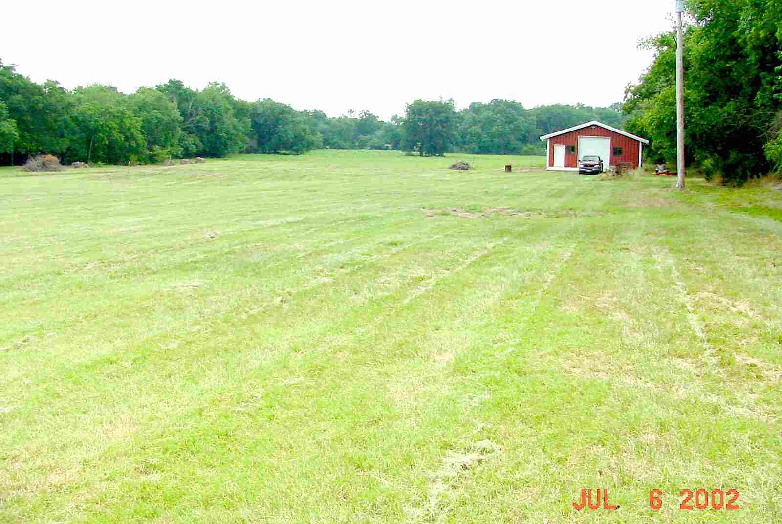

   / More Mower Questions #10
Here's some pictures I have also posted before as well. But it gives one an idea of what they can do.
Rotary Cutter set at about 8": Pic 1 | Pic 2
