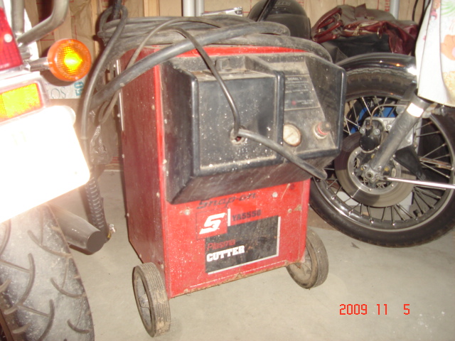

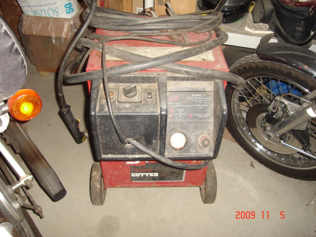

The thing is, when I offered $300 for the wire feed, the seller threw in a plasma cutter that needs some work. I've seen it operate, briefly, but a switch somewhere in the circuit must be having some problems, because it became very intermittent, then stopped altogether. It had, in all fairness, been sitting for at least a couple of years and was filthy and neglected. It's a Snap-On YA 5550, 230V.
The question: is it worth it for me to fix --or get fixed-- this plasma cutter AND run a 230V feed to my garage (I don't have one now), or would it be better to trade it in on a newer or new 120V unit?
I have very little knowledge about plasma cutters other than their theory of operation, but I sure like they way they can cut metal, and this could open a lot of new potential for me to be able to build things. I have no idea how much is this Snap-On unit is worth, though it seems that similar ones go for anywhere from 1,000-2,000 dollars- any ideas/suggestions?

"I've seen it operate, briefly, but a switch somewhere in the circuit must be having some problems, because it became very intermittent, then stopped altogether. It had, in all fairness, been sitting for at least a couple of years and was filthy and neglected. It's a Snap-On YA 5550, 230V."
It may not be this simple, but what the heck...
When I first used my Pro-Cut 55 and was playing cutting various items, mine did the same thing. The warning light came on, and wouldn't do anything.
Finally noticed a little blob of spatter near the orifice in the tip. Took my knife, and scraped it off. Turned the machine back on, and we were good to go..!!
You might take a look, and try... Who knows..??
I used mine Wednesday to cut some 3/16" stainless steel... OMG.., I love that thing..!!
   / More welder questions #5
Irvingj, Plasma cutters are worth their weight in $20's. The problen you are experiencing may be in the cutting tip. My hyper-therm has a set of contactors in the tip. My unit, I unscrew the tip and usually replace the contactor. Sometimes you can clean them with a wire wheel and they will work for a time. Not sure how yours is configured. Be sure and NOTE HOW THE TIP CAME APART. Also, clean air is a must. I have a motor-guard toilet paper roll filter in the air line. It keeps out moisture and small particles of dirt and oil. Use a dedicated air line to the unit to prevent a dirty air line from being hooked up and contaminating the unit. Best of luck. Dave
   / More welder questions #6
You might want to check that the work is grounded directly to the machine. I mean have the ground clamp directly on the material being cut. If you ground to the table & clamp the work to the table you might get spatters and intermittant cuts >> bad ground.
We had a similar problem one day and spent hours checking everything on the machine. After exhausting all possabilities, we moved the ground and it worked like a champ......

Since I don't have a 230V circuit available, what I thought I'd do was to go through the machine, generally cleaning things --which always seems to be a good place to start, IMO-- then check the tip carefully. I did learn that the tips are considered "consumables" and need to be replaced from time to time, so that part of the machine sounds like a good place to concentrate my efforts.
Once I've gone through it, to the best of my limited ability at this time, I plan to truck it back to Norm's shop (who had it before) and hook it up to see if it works.

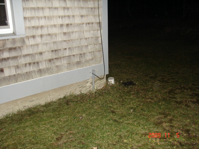

If it does, I'm not sure just how I'll proceed-- I do have an air compressor, but it's not filtered/dried, nor do I have a 230V outlet handy. I'd have to run a 60-amp service to the garage, but that would entail running a #6 line from my breaker box all the way to the far side of the house and then from there to the garage. I have a 1-1/2" underground PVC tube going to the gargage, but that's got a #10 30-amp line in it already. It might be a trick to snake a #6 three-wire through it as well!

If you rewire your shop, you could pull 3 each #8 or #6 wires using the #10 wire as a puller. 2 hots and 1 neutral. No ground needed. Then you would have 30 to 50 amps service 220v. Put in a sub panel for your 110-220 breakers. Add a ground rod at the sub panel and your in. Compressors, table saws etc, cost 1/2$ to run on 220v and run better. You would be surprised how much you will use a plasma once you have it. Someday you will want to cut 1/s" or larger and kick yourself if you get rid of the big unit. Good luck Dave
   / More welder questions #9

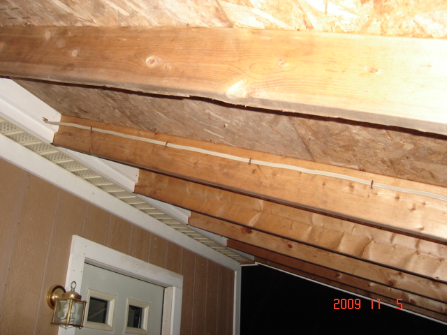

may depend on how far the garage is from the house. Less than 100' may have to pulll ground wire as well, should check local regs with the inspector. 1-1/2" conduit should be adequate to pull any reasonable amount of wiring, think about what else you might wish to do
Thanks! Moeh1, it's not too far... coming out of the base of the house, line goes into a PVC 90 degree access box, then down into the ground, about 12" under. Makes a 90 with a PVC elbow, then only about 15' underground to another PVC ell, where it comes up through the slab for the garage. From there, 8' up the post, out of the PVC, and "free-run" across the lean-to roof and into the garage. My small 120V panel is about 4' below entry point in the garage. Altogether maybe 35' once it leaves the house.
