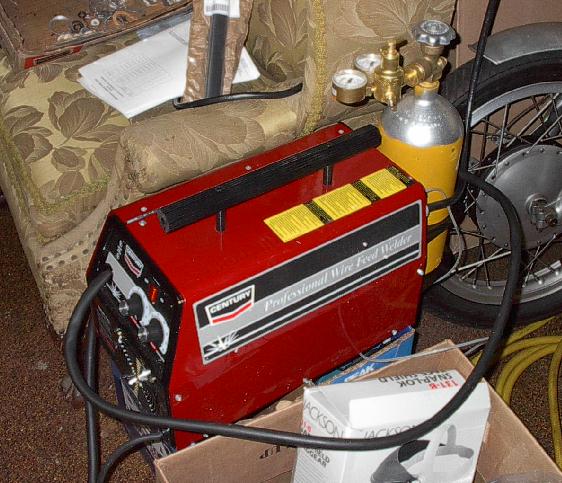

what are others opinion on the type of welders would work best for making light duty 3 pt tools. stick, wire feed, mig, arc etc. What is the smallest size and price range a person could get by with once the correct welder is determined. I am going to take a welding class this spring and of course I don't have money to buy a welder right now I would just like to see if welding is possible for me and if I even like it.
   / More welder questions #2
Stick would be cheapest, MIG (wirefeed) would be easiest. TIG is considerbly more money and takes a fair amount of skill to use. Stick AC buzzboxes (tombstones) are dime a dozen and can lay a decent bead down. 220V welders have a lot more capacity and duty cycle, you can weld thicker for longer. If yu're interested in a nearly new MIG welder let me know, I've got a Century 175GS I'd like to get rid of. I'm in SE MI also.
