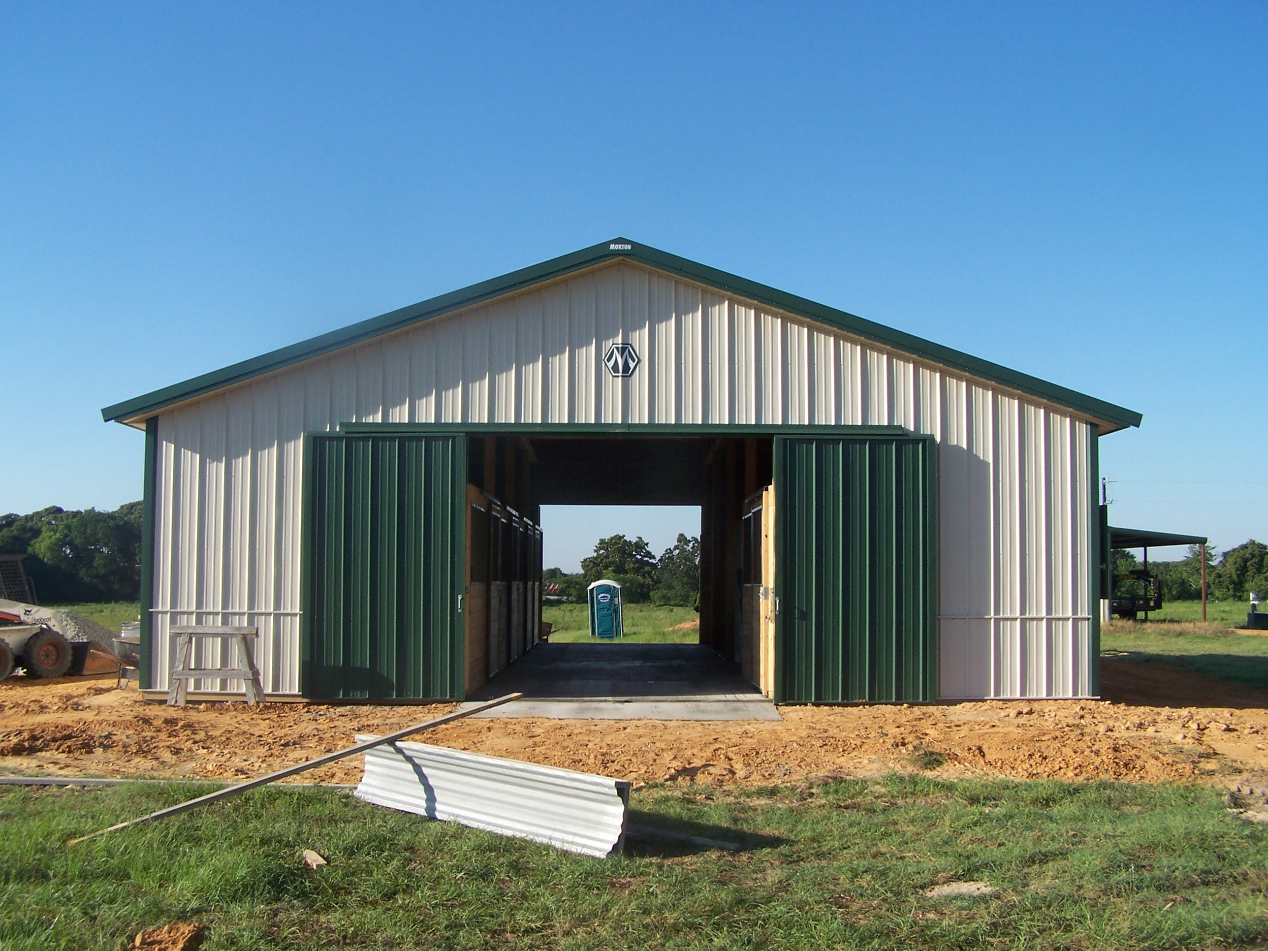

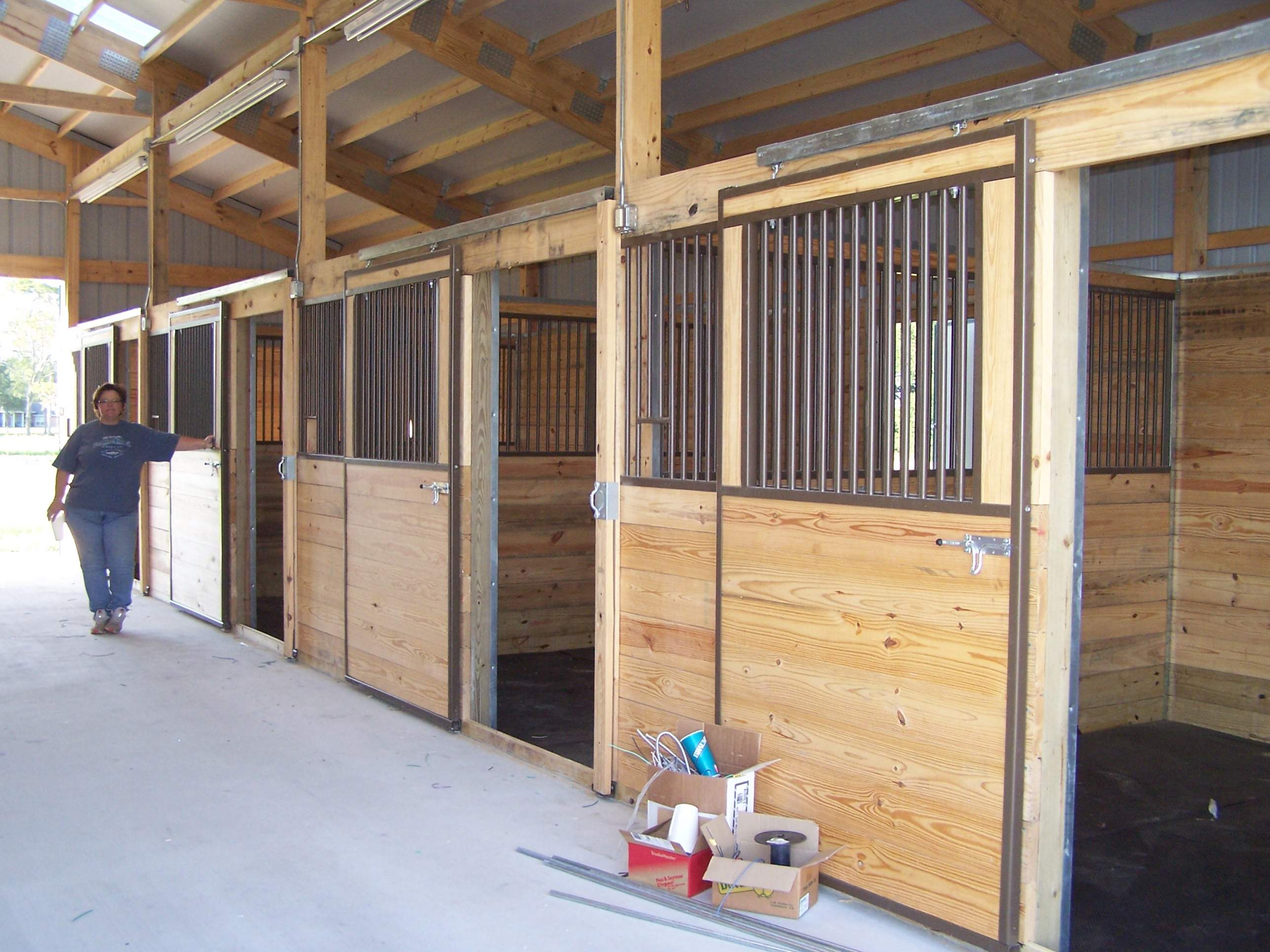

We had Morton build our stables and I highly recommend them. The Morton salesperson recommended I sub out the plumbing, electrical, septic, and HVAC myself to save money. Otherwise they would have used the companies I recommended and tacked on 20% to the cost. I appreciated his honesty. The crew foreman was great and worked with my subs on scheduling so there was no delays.
The Morton crew out of Waco was the most professional I have ever seen and I saw a lot as a fire marshal/building inspector for 22 years. They cleaned up the site every day, even using a roller magnet to pick up loose nails or bits of metal in the dirt that could have found its way into a horse hoof. No excessively loud music or bad language. They added 2"X8" supports for the lights so the electrician didn't have to do it. They used chains and boomers strung across side to side and top to bottom so the building was absolutely square before they put on the insulation and metal. We were building the house at the same time so there was already a porto-potty on site but they supplied their own so as to not inconvenience the other crews.
Ten years later we had Morton come back to change out 2 windows to full Dutch doors. The foreman was the same one that built it. While they were there they adjusted all the sliding doors and checked for anything that needed to be fixed, such as loose metal, without even asking.
We have never had a horse injured as a result the building construction. We have never had to do any repairs to the building other than normal maintenance such as light bulbs or HVAC work that we had subbed out to a local contractor.
