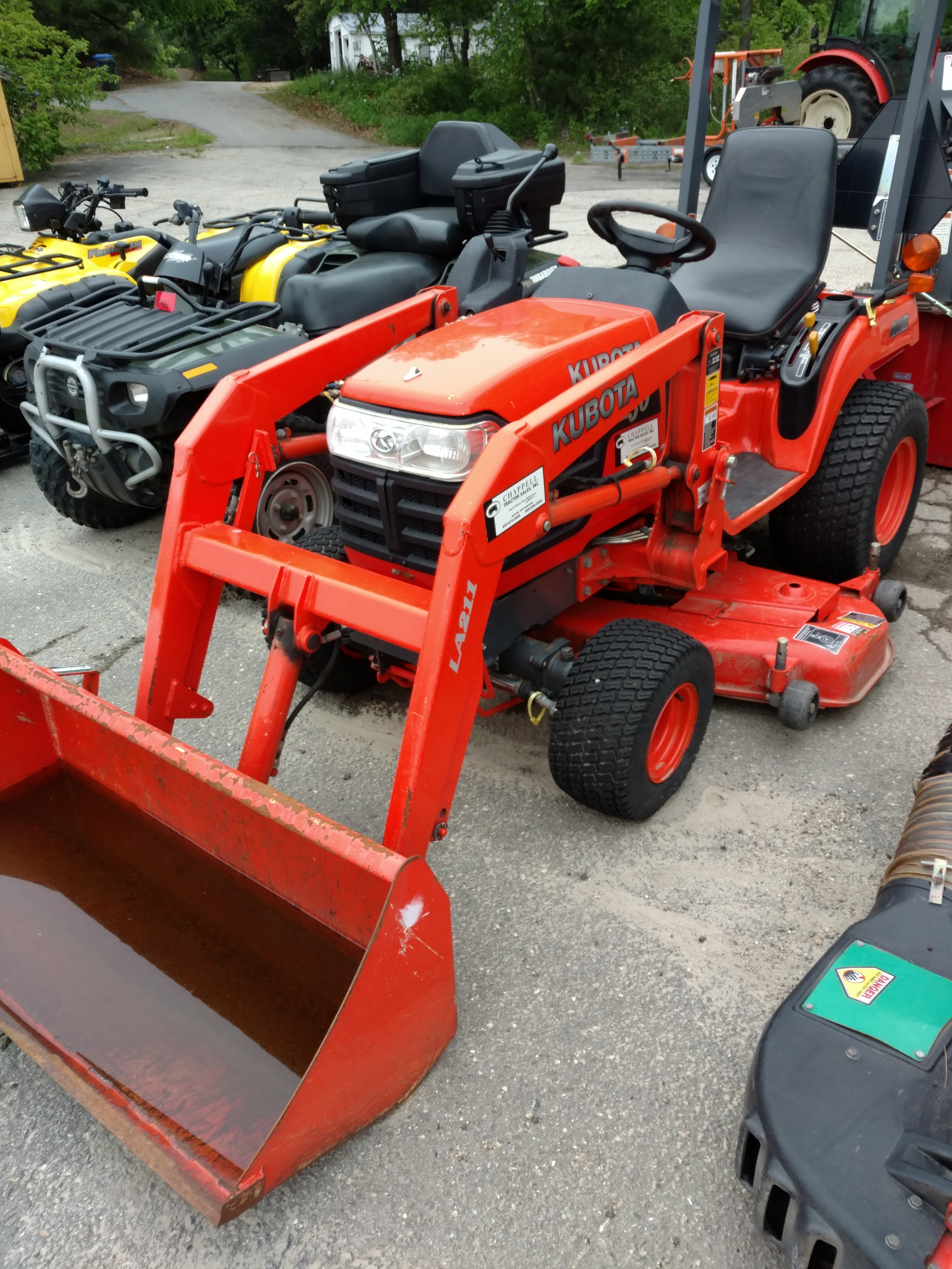

I now have my BX2230 with an LA211 and a 54" MMM with 519 hours and turf tires. Once Spring /Summer weather finally arrives later this week in NH, I'm going to perform a 300 hour service. Bought a filter kit online, Rotella T6 engine oil and Kubota Super UDT2. I plan on flush and fill the diffs also. Lube is done on the tractor, loader and mower, will have to check out the mower's gear oil.
My uses will be light loader work, finish mowing, brush cutting and snow plowing.
Next, if member owners of BX's could recommend any mods that would be very helpful. Based on forum research, I may start with a rear skid plate, Tach-N-Go QA or one of their competitors, a canopy and a QA Snowplow.
I post a couple of pictures from the dealer's lot. . Thank you folks!

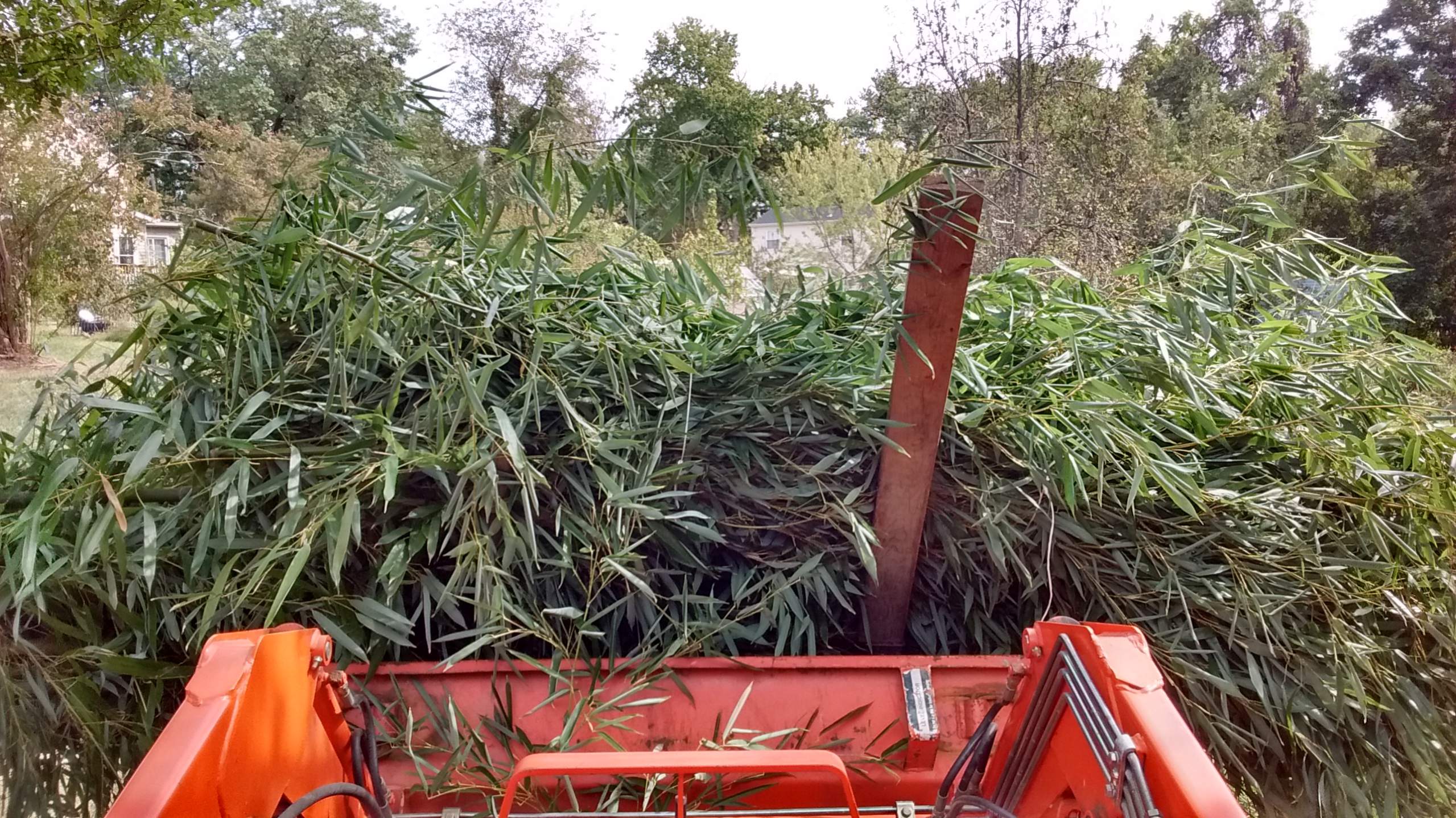

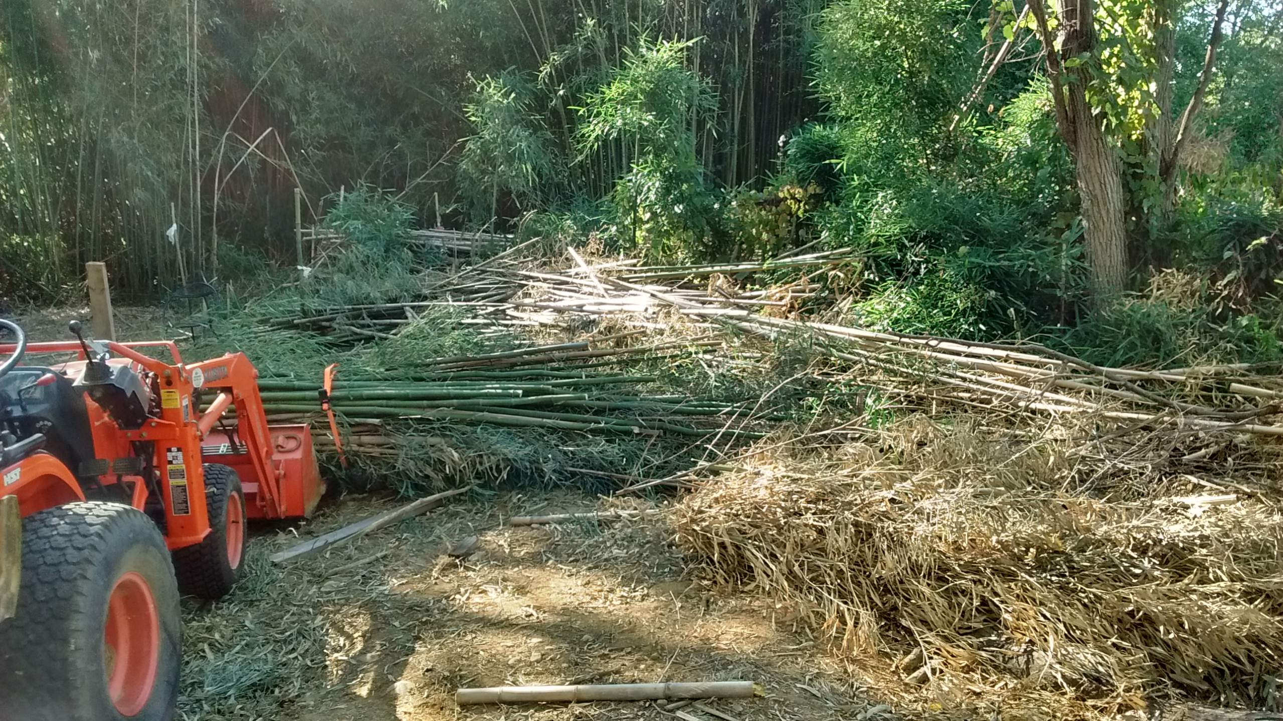

With a $149 pair of clamp on pallet forks and a chain or two I was able to get sort of a "poor man's grapple" which greatly assisted in clearing 1/4 acre of brush and bamboo.
447628-grapple-bucket-scut-img_20150923_154916169_hdr-jpg
447629-grapple-bucket-scut-img_20150924_114013550_hdr-jpg
Let's me carry a LOT of brush. (sorry if the pics are big, didn't show like that in prior thread)
