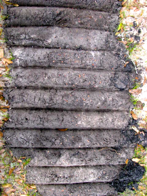

For sand based soil I think a broadcast spreader would be as good as a seed drill. For 80 acres I would consider a Cultipacker to roll in the seeds. A Cultipacker leaves 2" ridges pressed into the soil, which do final flattening of clods, prevent soil erosion until seeds germinate and improve seed germination through solid soil contact.

Photos #1 - #4 ETA Cultipacker

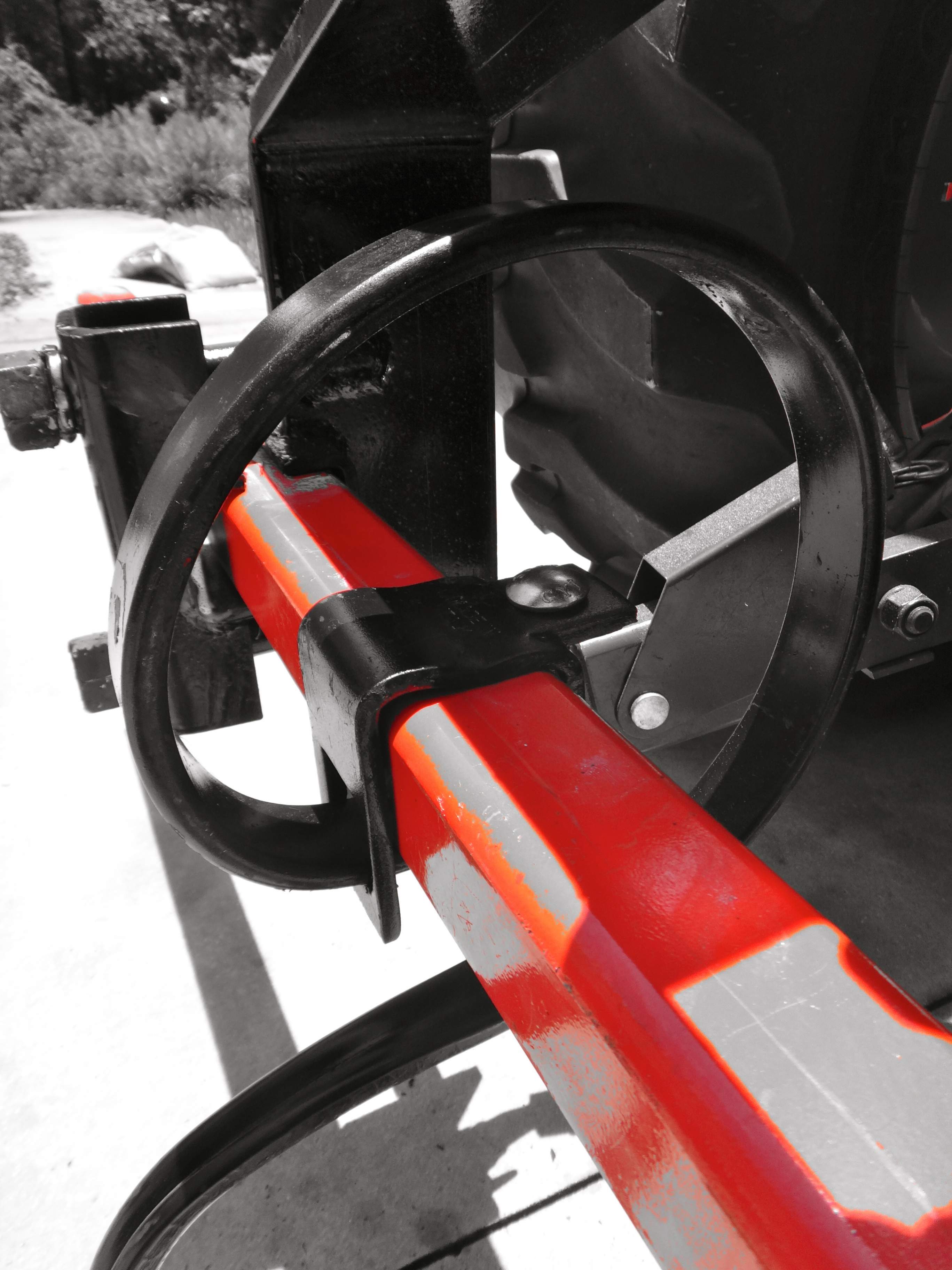

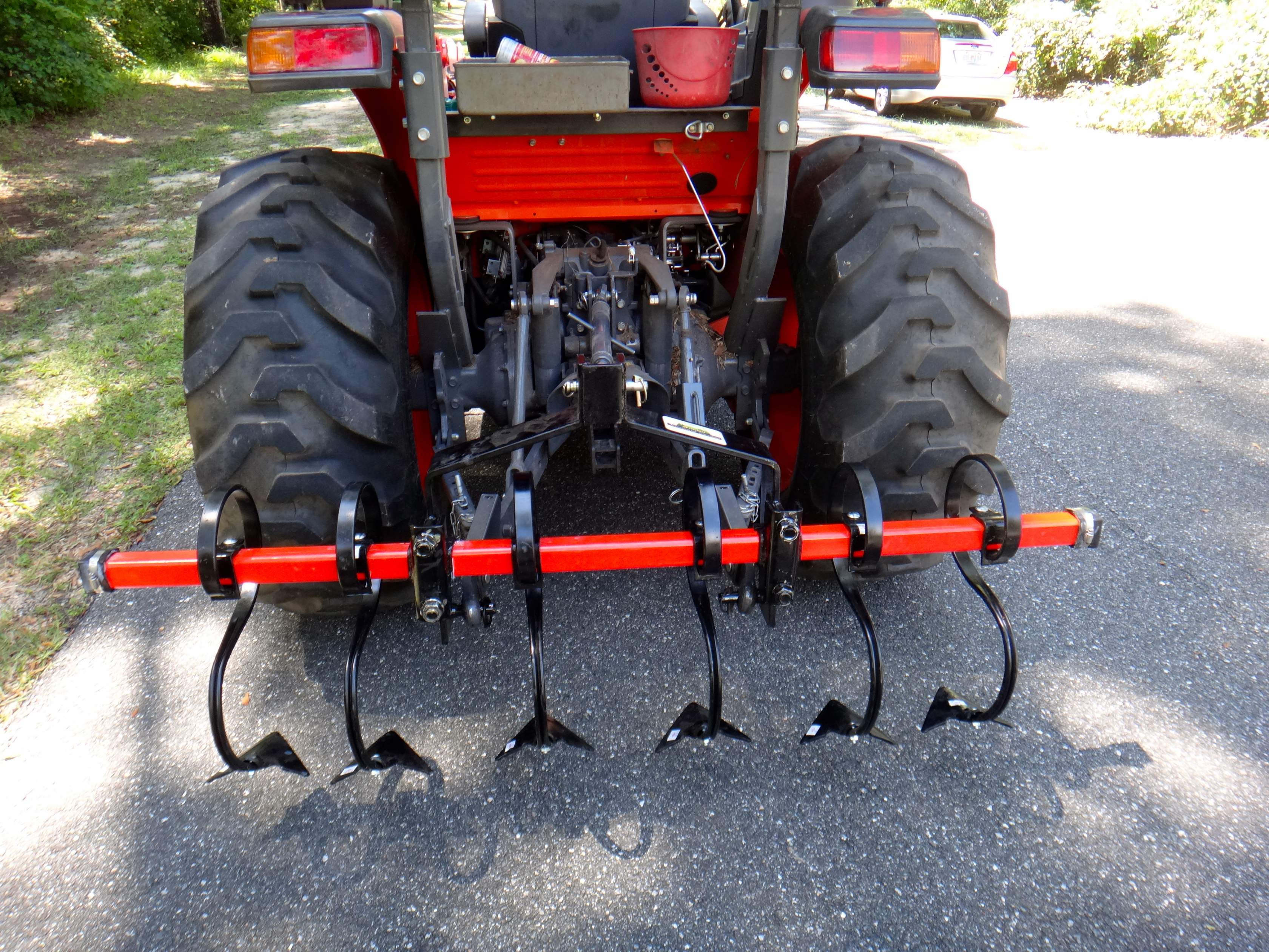

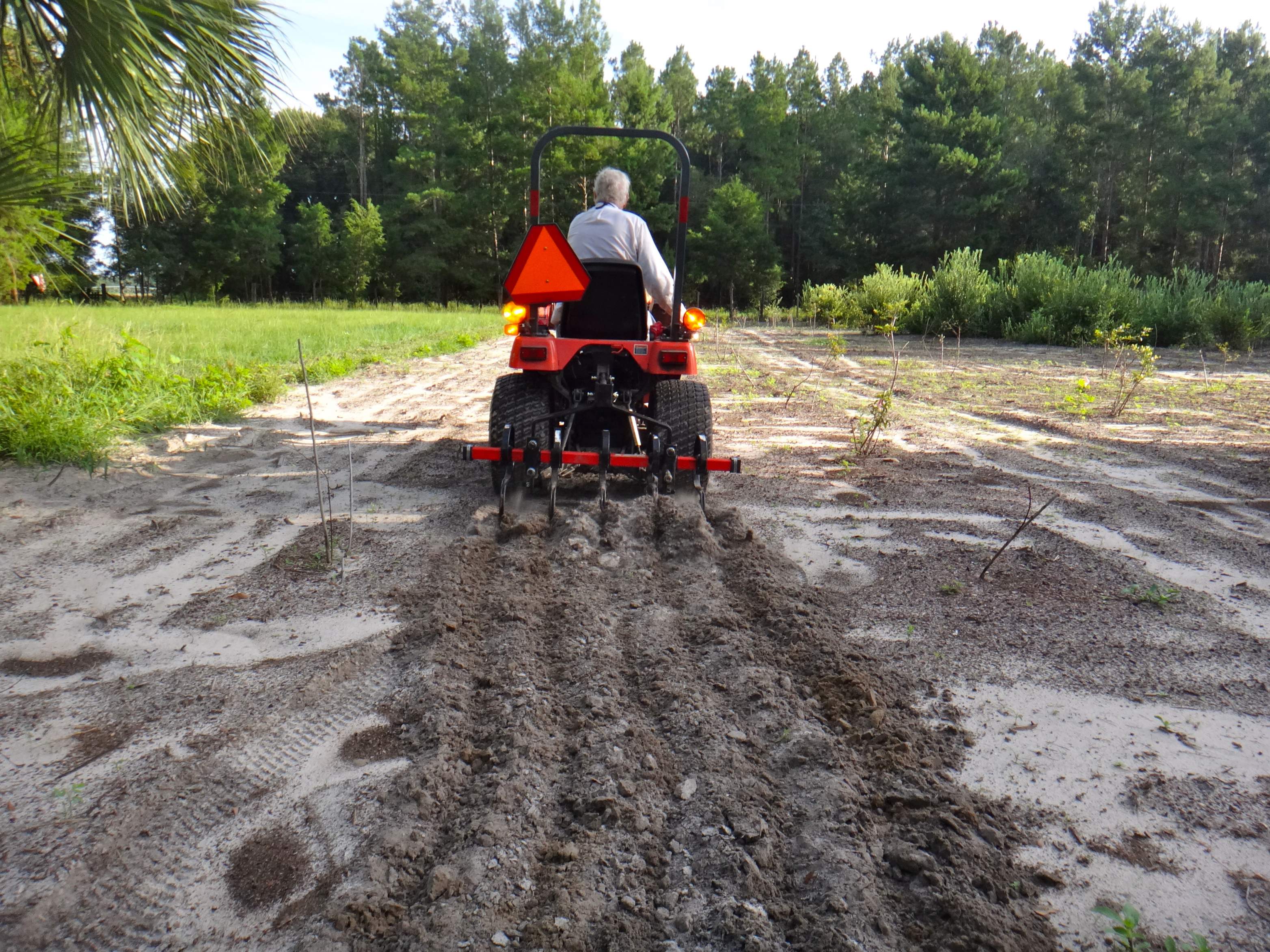

Photos #5 - #7 'Wunderbar' Modular Tool Bar Cultivator from Woodward Crossings, PA. (I have two.)
