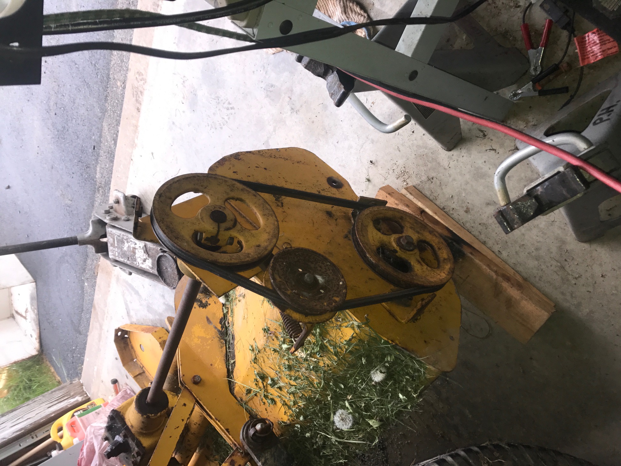

Attached are a few pictures of the mower I have.
with the PTO speed at 540 rpm I get a cutter speed of 750 rpm if I change the PTO speed to 742 rpm the cutter speed is 1000 rpm. this gives a ratio of about 1:1.4. I could change the bottom pulley to about half the diameter to get the cutter speed up to at least 2000. Is this what I should attempt?

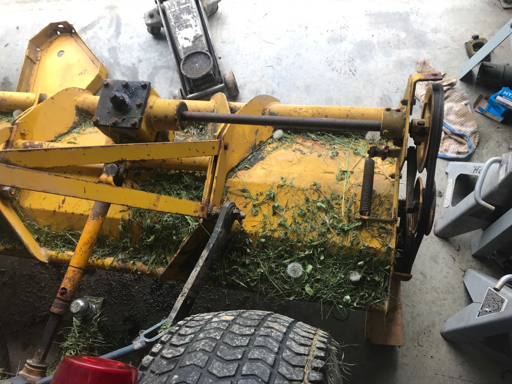

1. The rear rubber discharge flap to control the clippings as they exit the mower is gone.
2. the rear roller is gone
3. this mower should have side skids as the bolt holes are there in the side weldments.

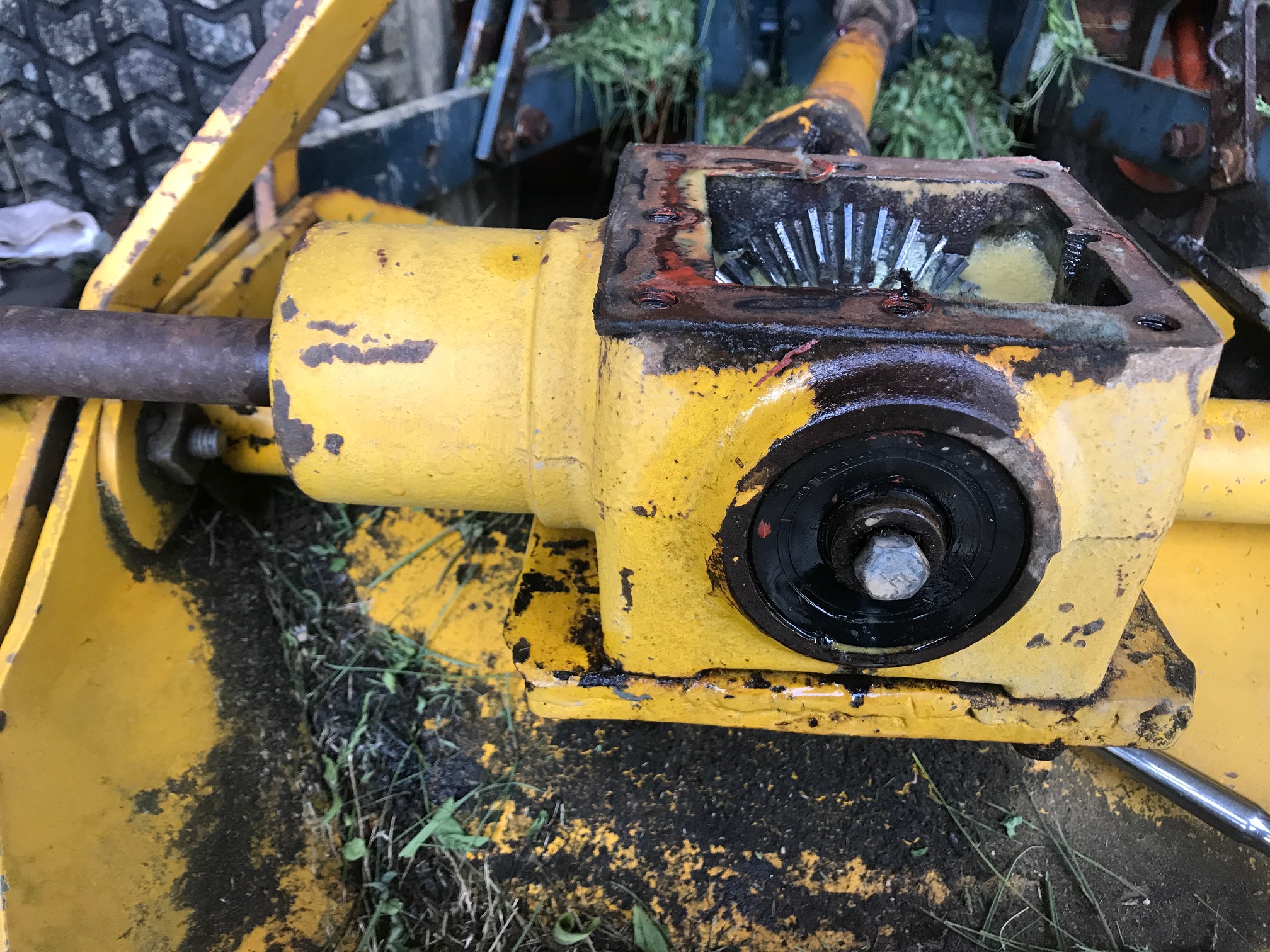

Please take a close up picture of the gearbox from the rear as this one has two output shafts and the shaft in the rear looks like it was broken off flush.

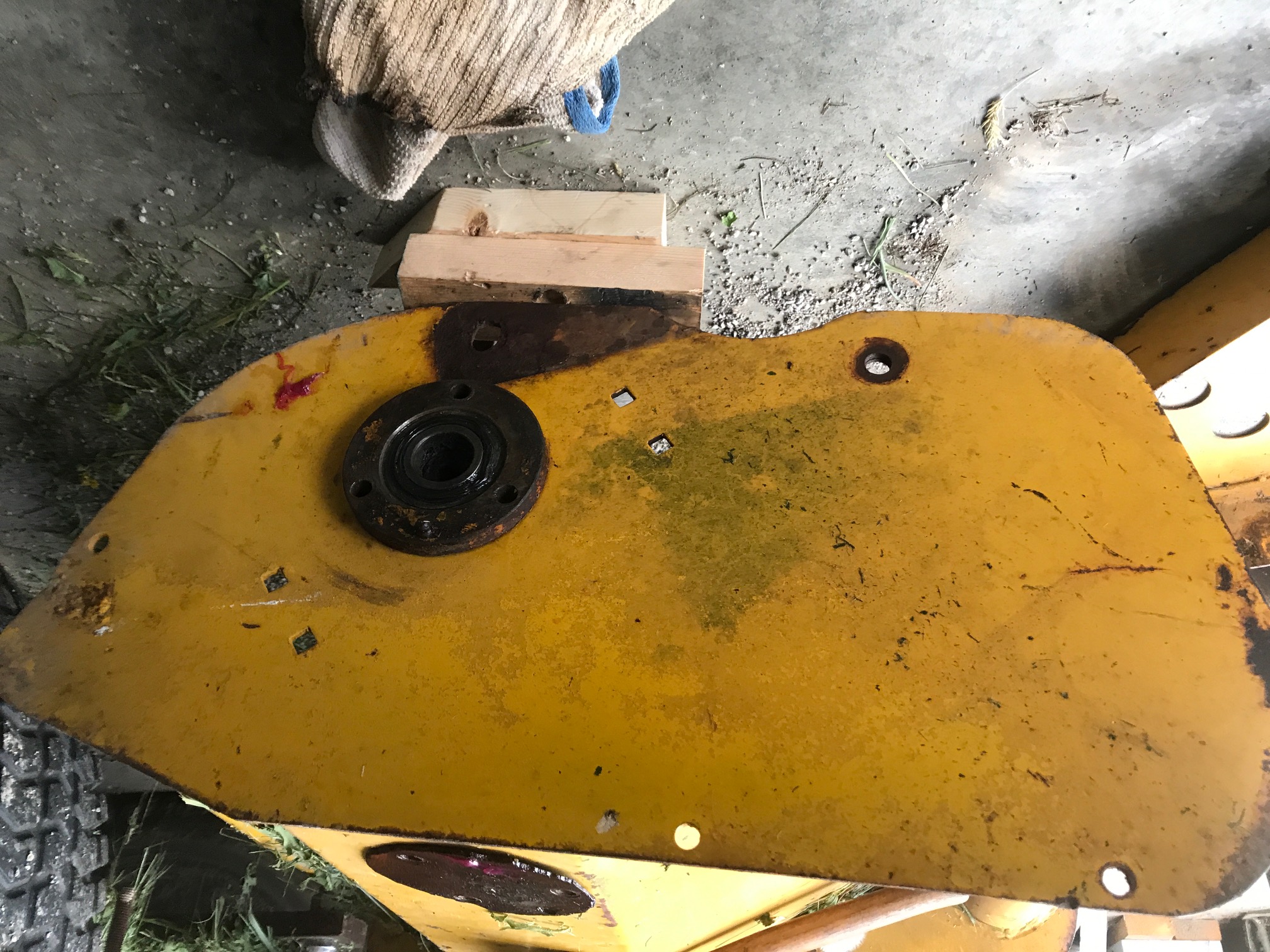

Please also post an image of the right side weldment of the mower and a close up of the bearing housing on that side please.

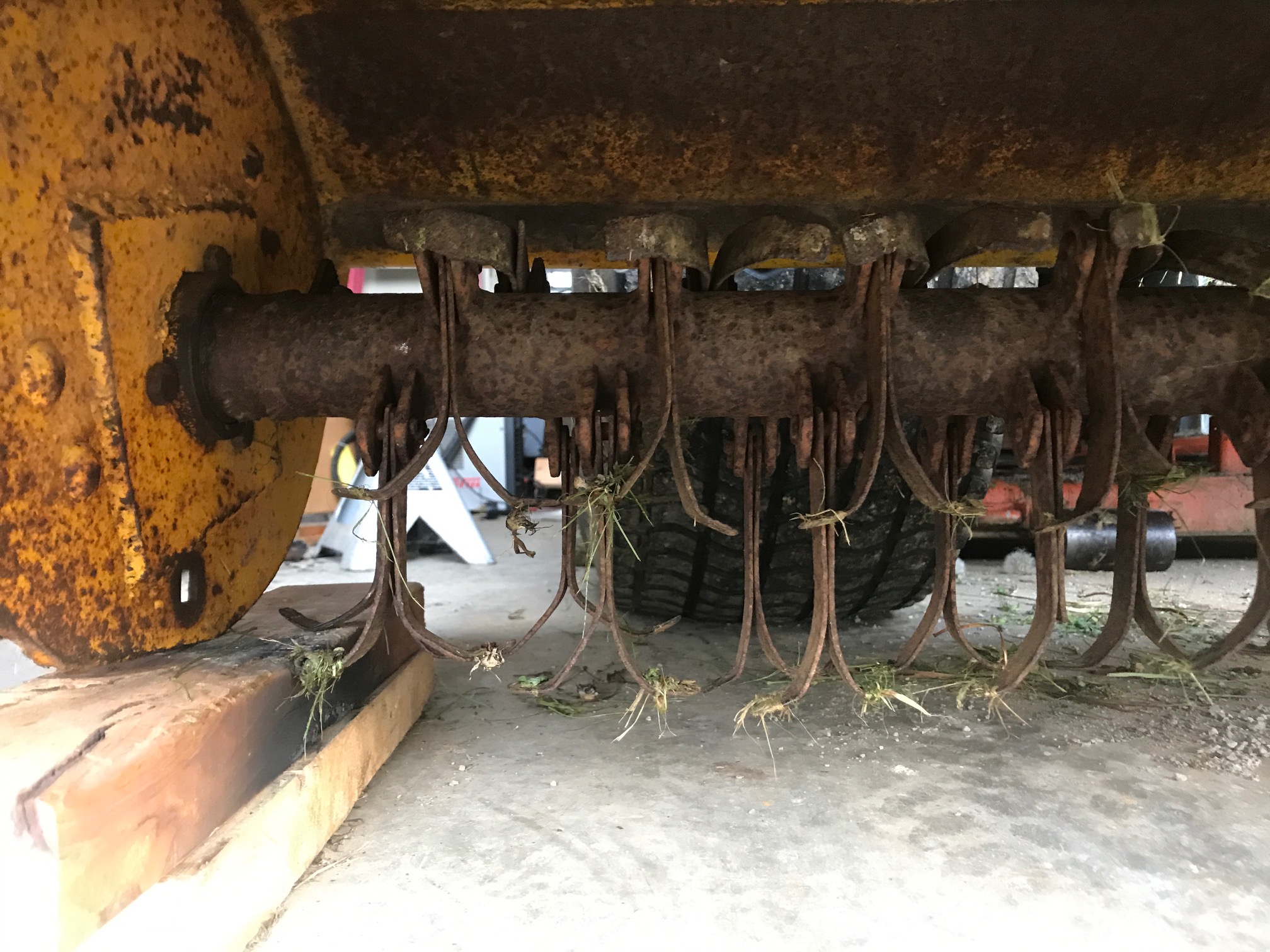

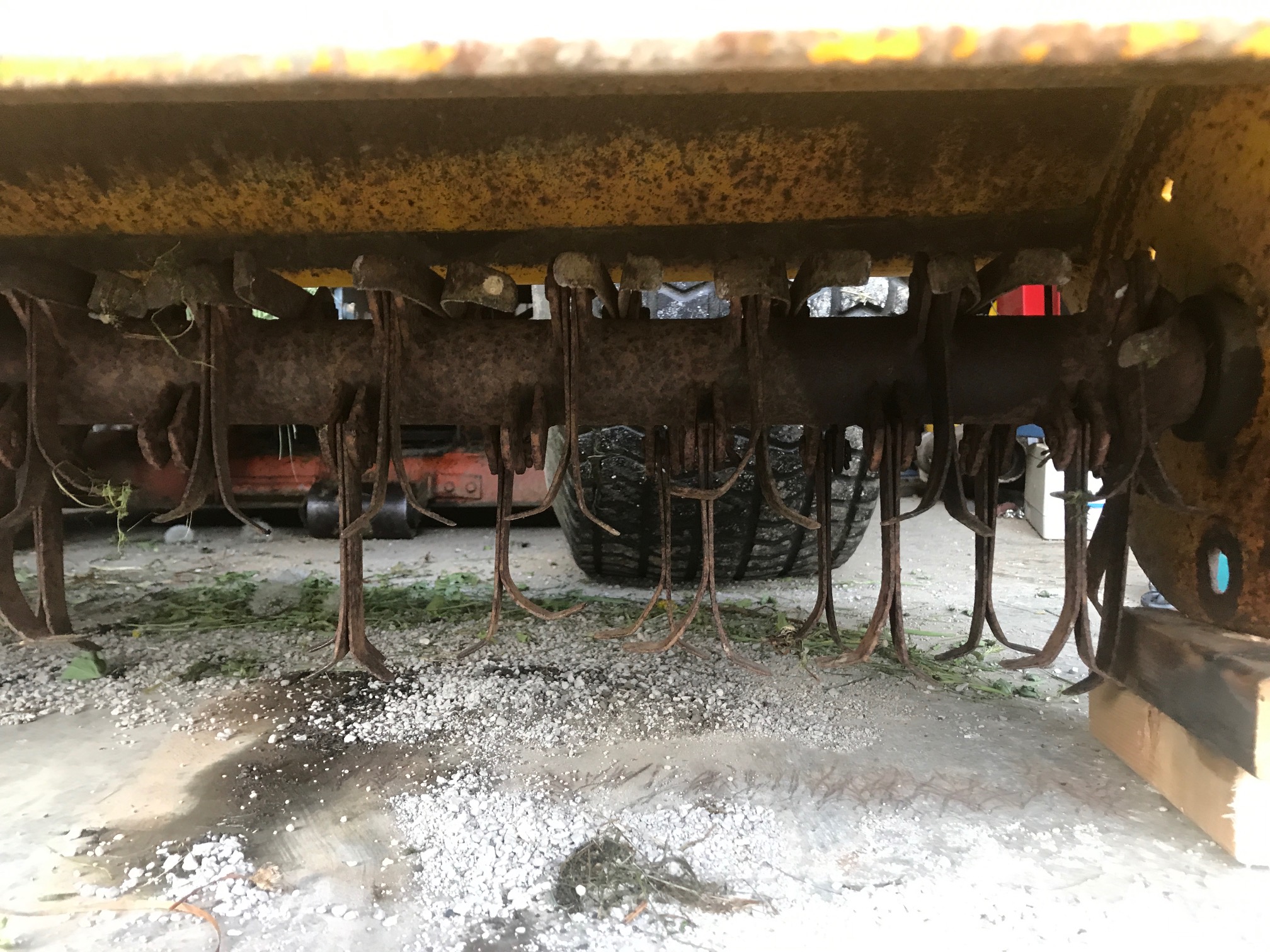

Please also post images of the flail mower rotor-rotate it so both sides are in two or three separate images and the images showing the condition of the knives and the knife hangers as well as you may need knife hangers if the knives are as sad as you say they are.
Also be sure to take pictures of both inner bearing housings-they are bolted to the the side
weldments of the flail mower.
You need parts and new driven pulley to replace the existing driven pulley on this mower.
Please call Flail Master and tell them you have "new to you" mott flail mower with equal size
drive and driven pulleys and make sure you tell them your mule has a multi-speed PTO system and what brand mule you have.
If the ID plate is still there all the better as you tell them what is on it.
You need a complete rear roller with the mounting arms and rear roller bearings, the rubber discharge flap and the strap iron and mounting bolts that go with it to secure the clippings discharge flap.

Thanks Lenoz for the information attached are a few pictures you requested.
The rear roller is at work one of the bearing was shot causing the significant damage to the shaft. I am turning a new shaft and have replacement bearing on order. I have the other parts you mentioned except for the rubber flap. I was going to cut a rubber flap out of some rubber i have.
The shaft on the gear box is not damaged. it looks like it is designed to be a left or right output by flipping the input shaft.
When I ordered the flails I also ordered a few weld on tabs to pin the flails to.

You need an oil seal on the open end of the gearbox. the oil seal number still looks to be identifiable too.
