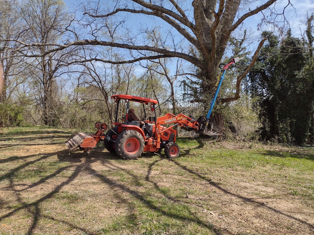

Here's what I did.
I purchased a hydraulic pole saw.
I plumbed it up, so it connects to the couplers for my grapple.
Manufabricated a bracket, and it fits on the end of my pallet forks.
Bing, bang, boom, I now have a pole saw I can operate from my tractor seat, and it reaches about 15' in the air.

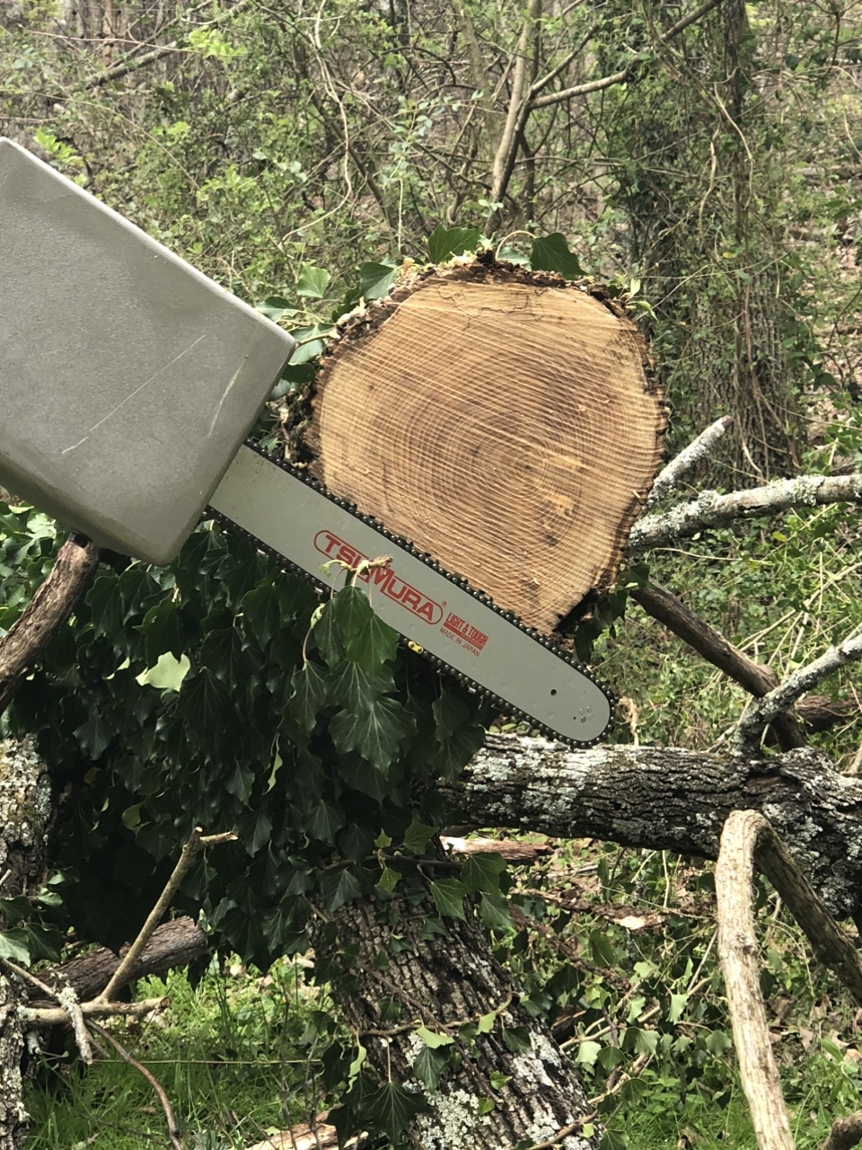

My homemade limb saw has allowed me to safely clear limbs and break down some large, blown downed trees from the safety of my tractor seat. Got miles of roads, trails and fence lines to keep me perpetually busy. Has been rewarding to see the progress. Shoulders appreciate not pulling on manual polesaw. My trees tend to be taller and bigger than what electric saws could handle. Relatively cheap to build, ~$500 for parts and reused steel.

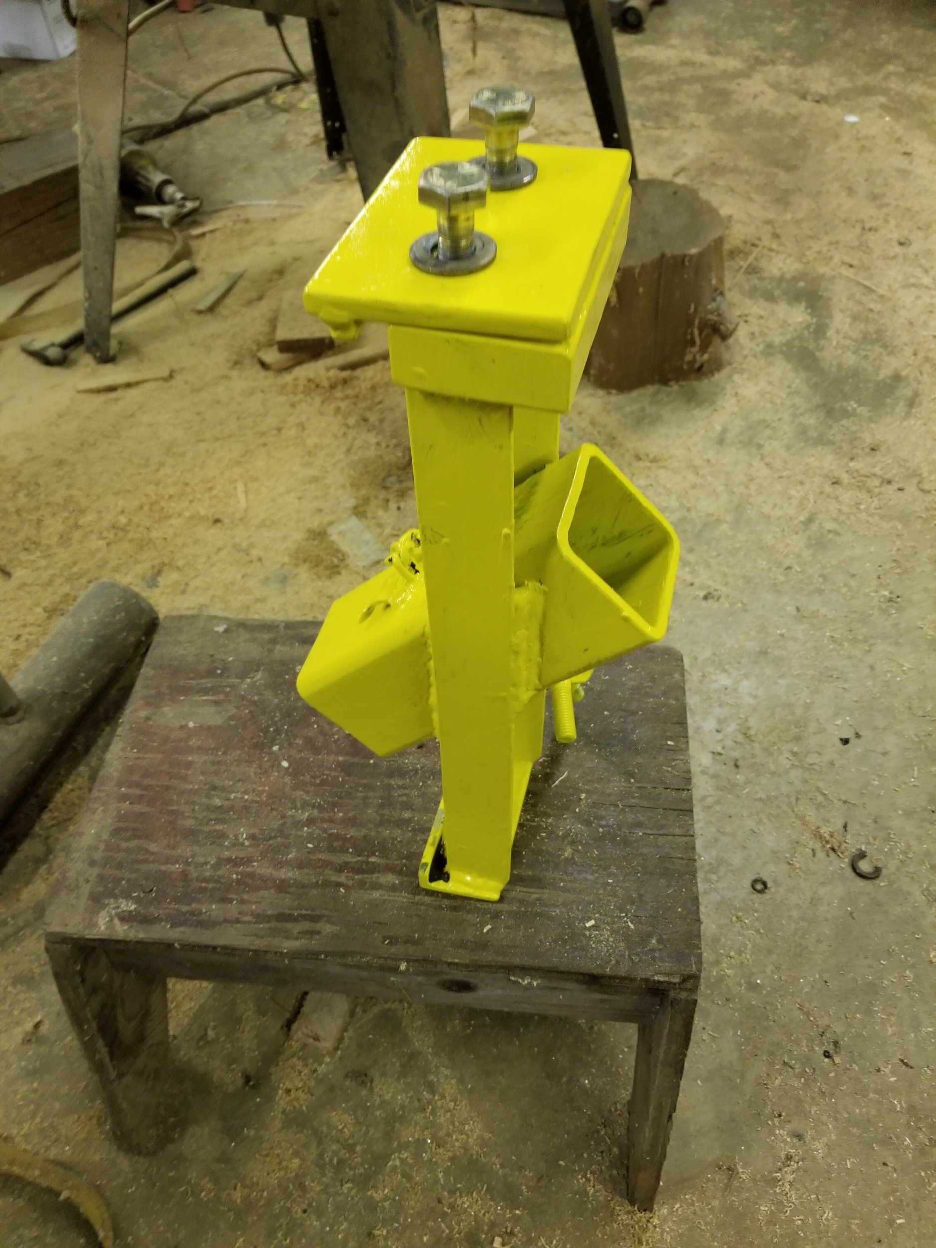

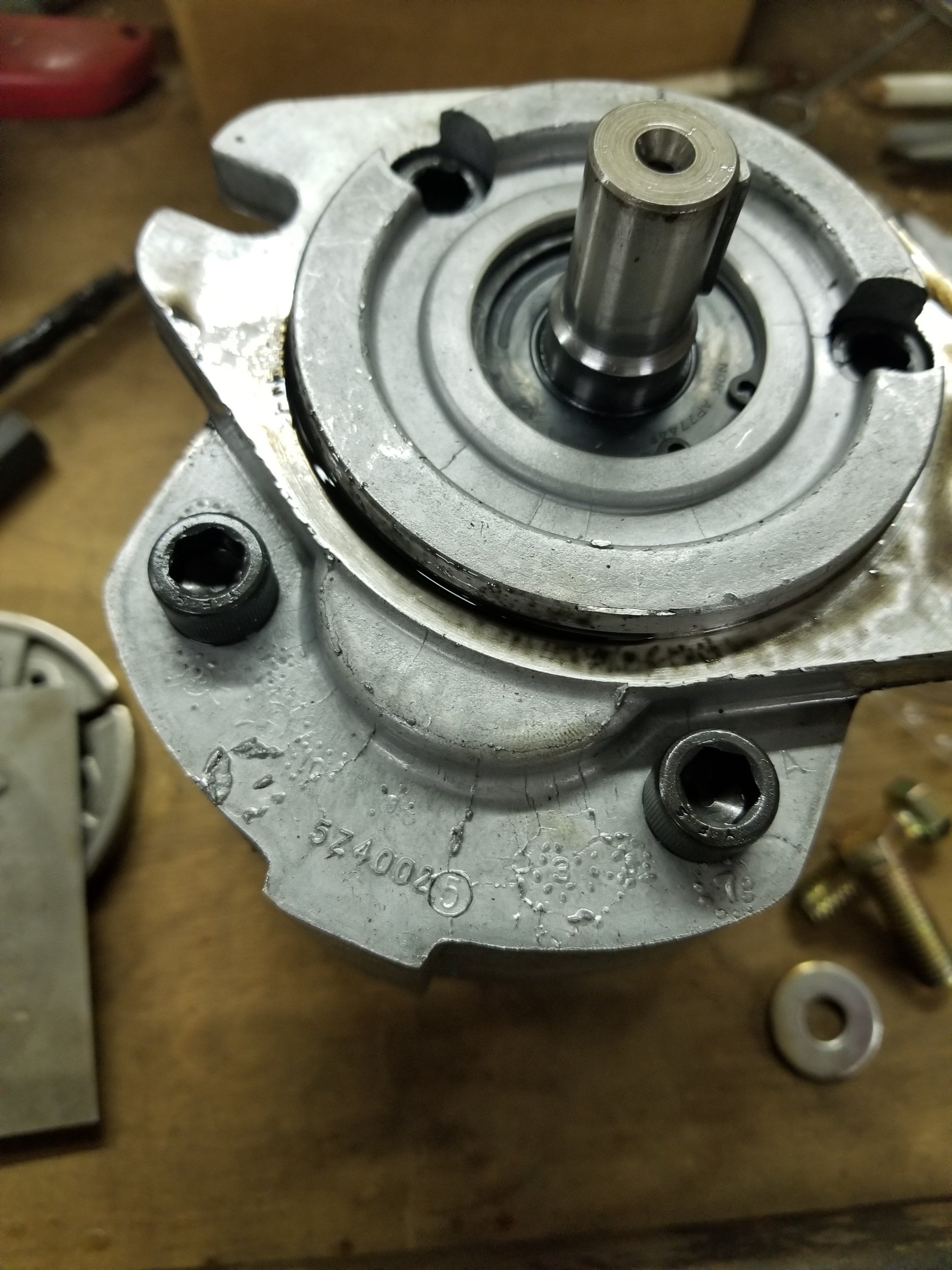

Thank you. I purchased a hydraulic motor from Hydraulics | www.surpluscenter.com. The motor is plenty strong - I most likely could have went with a smaller one - I tried to match the mas flow rate of my tractor hydraulics with the max flow rate for the motor so I would get the most horse power but I have plenty. The oiler is a needle valve adjusted down to very little output coming from the pressure line on the motor which means I use hydraulic fluid from the tractor to lube the chain. This is how the commercial builders do it so it's what I did. There is no noticeable drop in fluid level when I use the saw. I bought a stock drive sprocket for my chainsaw and modified the bore to fit the hydraulic motor. I didn't incorporate a tensioner because the commercial ones I saw on youtube didn't have one. They said the chain needed to be a little loose. But I have wished I had a tensioner as the chain gets loose and comes off sometimes. I also made a receiver that stays on my forks for attaching the saw.

Tractor hydraulic pole saw has saved me lots of time, $$$ and personal risk trimming back trees. Only regret didn’t do it sooner.
I’ve cut thru oak limbs and high down trees >20” diameter. Could break or tear off using the FEL. Keeps me out of the danger zone.
Saw works good on smaller tractor with only 7gpm flow.
HST is really a must. Maneuvering for best position and small moves it’s perfect.
My tractors have 4 post ROPS. Overhead protection anytime in the woods a good idea. Have yet to drop a limb on the tractor. Cuts enough in front of the tractor to drop limbs safely. Limbs can fall unpredictably.
Having the backhoe attachment on the back adds to the articulation to align cutting using an outrigger. I’m always on a slope usually.
Made a ssqa trailer mover attachment with two vertical receivers for the polesaw. Improved visibility, height, reduced top heavy weight with loader raised and gave better clearance going down wooded trails. Cut way down on my hand trimming.
A tool that takes a good dose of common sense, but so does the tractor.

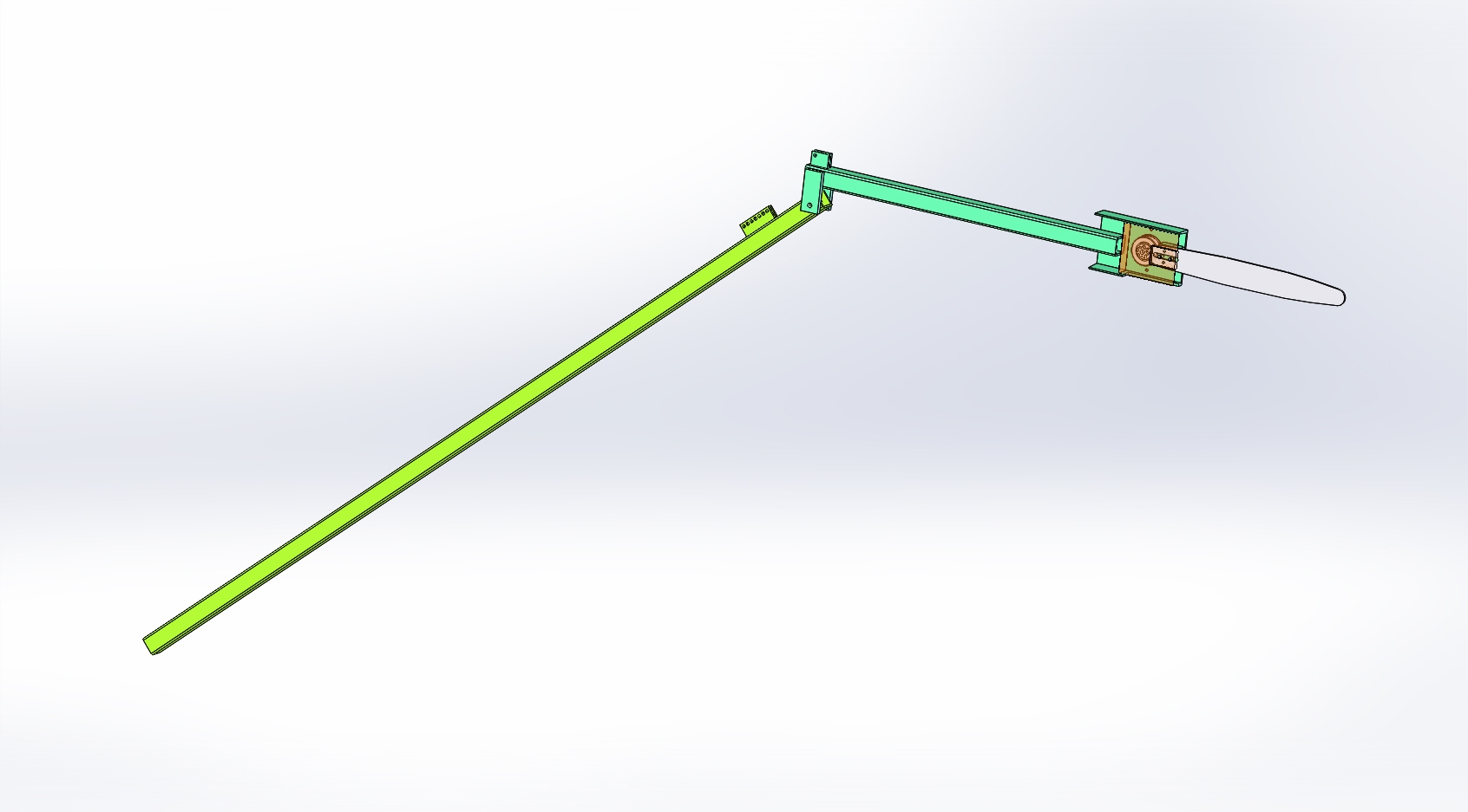

Did a fabrication story as I built the prototype. Materials, motor and design features. Some good and some could be improved. Didn’t have to worry about mass production cost or shipping completed product. All simple hand tools and simple mind. Selfishly used the forum document the project to help me remember.
Motor and hydraulic parts from Surplus Center. 5,000 rpm Parker motor. SWAG, scientific wild ass guess. Same motor type used by other manufacturers. Plenty of power but will stall if in a bind. Reverse gets you out of a bind.
