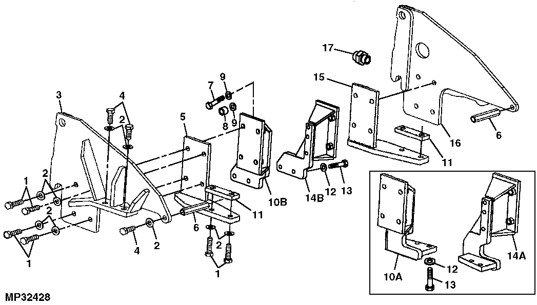

Could someone pls tell me whether a mount frame is needed for a 448 Backhoe on a 4x20 CUT ? I have a 4320 with Power Beyond and found a 448 Backhoe in good condition for sale but, I'm wondering what else may be needed to actually mount it.

I have a 3320 with a 447 hoe, and it requires adapter plates that bolt around each rear axle housing. The 448 hoe will also fit the 3x20 series but requires a different set of plates (I believe). From everything I have seen the 4x20 series uses adapter plates also.
   / Mount frame for 448 Backhoe on a 4320 CUT ? #3
This is the mounting kit needed. Part number LVB25568.
