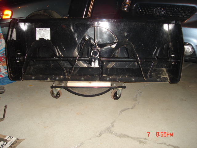

harrbca-- One other thing you might keep in mind:
After I get the blower partially slid onto the shoe, I use the hydraulics to raise it all the way up; that seems to make it a lot easier to jiggle it in the rest of the way. Don't forget to drop the little folding driveshaft support before sliding them together.
I also keep my blower on a rolling dolly, with a piece of wood under the front edge of the blower. That sets up the angle so it'll slide right on, with the shoe's height set somewhere in the middle.
Hope a new shoe takes care of your problem!
