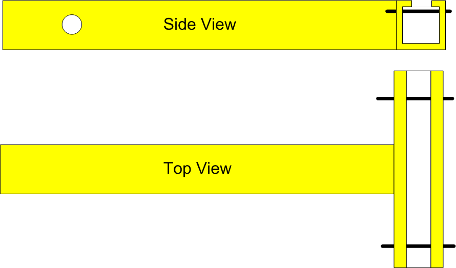

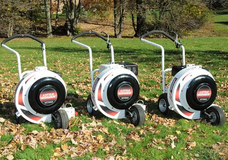

I used to work for a lawn care company and we had to blow off a bunch of paved paths that were up a fairly steep hill, we used a blower similar to one of the Little Wonder blowers shown below:
We had a golf cart and previously, someone would sit in the bed and hold the handle of the blower. The problem was that if you didn't hold it just right, the blower would start wobbling back and forth. That would usually end up with the blower on its side and once the guy didn't let go fast enough and he twisted his wrist.
The solution was a T shaped piece of 2"x2" 1/4" tube that went into the front receiver hitch and cradled the back axle of the blower. We then used a tension strap to hold the handle to the brush guard of the of the golf cart:
That would probbaly work on the front of your RTV.
Aaron Z
