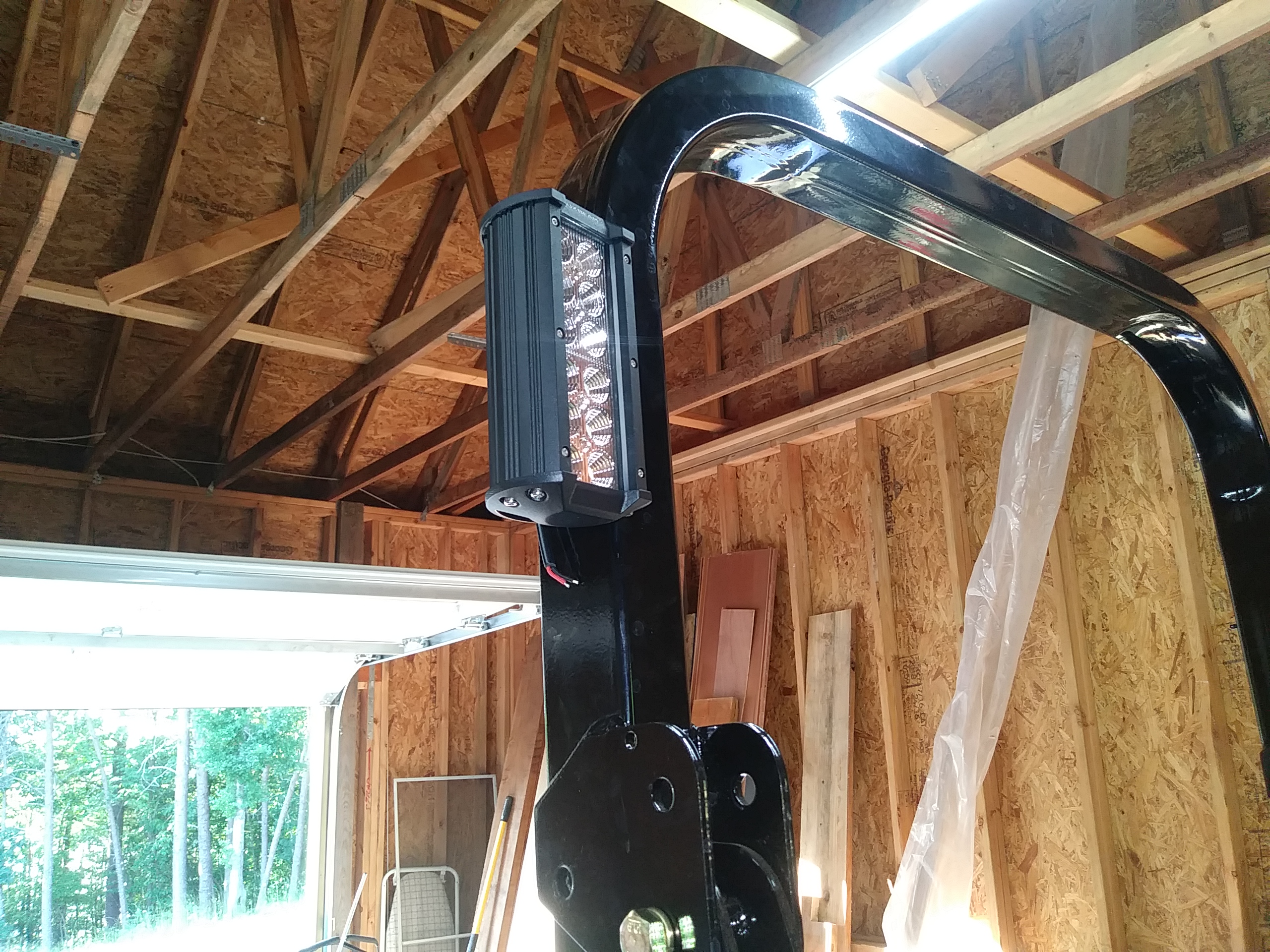

My first two adds are a rear work light and a horn. I had very good service from pod-style LEDs on a golf cart, decided I would use something similar for the rear work light. Ended up ordering a 36W "Auxbeam" brand LED pod from Amazon.

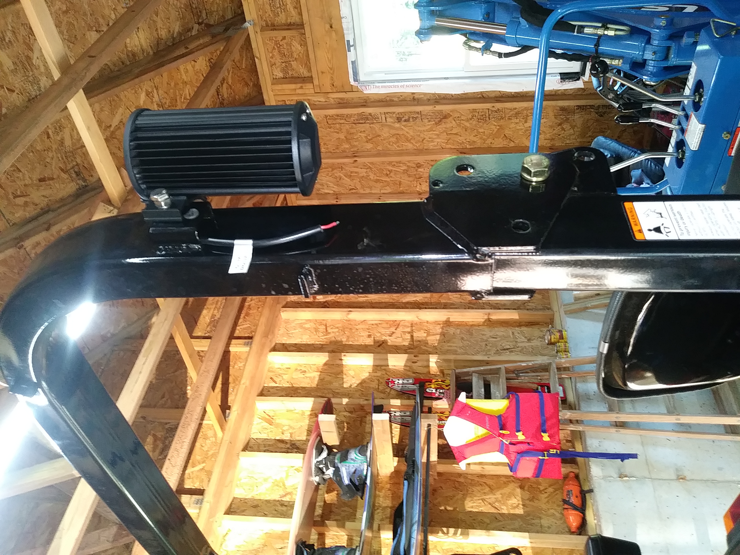

The MT225E has a threaded bracket welded to the ROPS on the left hand side. It looks like it's for a light. Figured I would start with that as a potential mounting spot. As it turns out, the Auxbeam fits like it was made for that bracket. The supplied bolts even matched the bracket's thread. Here's what it looks like:

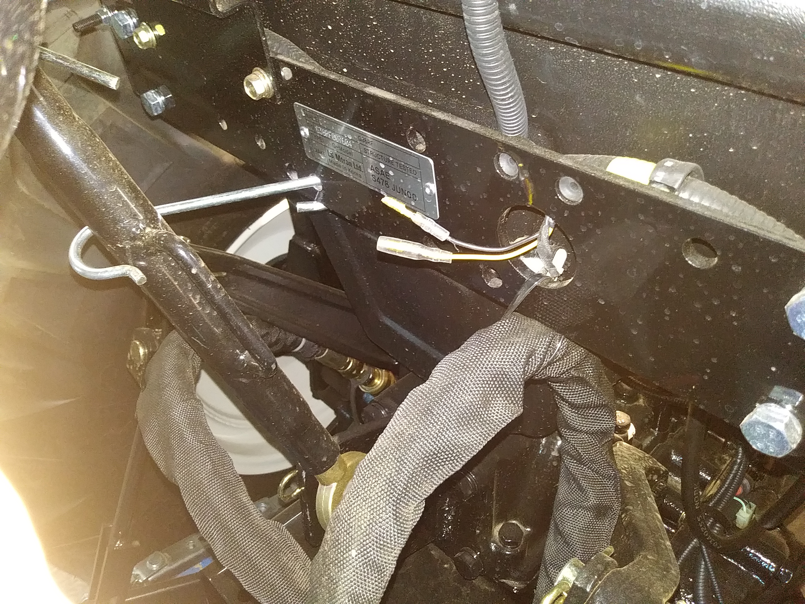

After deciding on that mounting position, I started looking at the fuse box. One of the fuses is labeled "Work Lamp." Huh? This tractor doesn't have a work lamp. Fuse box lid must be a shared component with a tractor that does, or maybe the work lamp is an option on this tractor. But there was a fuse in that position. Checked under the dash...there's a wire there, too. So the tractor is wired for a work lamp. Started looking at the area behind the fuel tank and there are two wires with bullet style connectors, but not connected to anything. Gotta be the wires for the work light. Well, this project just got easier!
Anyway, wanted to confirm from anyone here who might know: Are those unused wires for the work light? And if so, how are they switched? Does the work light have a switch on it?

The manufacturer uses one harness per model that accommodates all the options available. (Car makers do the same) There are probably connectors behind the dash were the switch would be placed.

No connector found for the work light, but strangely, there is a connector for a horn, which I don't believe is present. At least I have't seen it, if it's there. Maybe I need to short the terminals on that connector and see if the tractor honks?
The unused rear lead shown in my pic above gets power with the key. I wired the new light switch inline, after the fuse box, where a connector would have been. Have just a tad bit of fitting to snug up the switch in the dash cutout, and that rear work light is done. Works great, throws a ton of light. Will take some night pics and post them when I have a chance.

The work light positive wire from the fuse box is yellow with a red stripe. It's the same wire as the rear positive wire we're talking about. Not sure where the negative wire is grounded, but it doesn't really matter, for switch purposes. The fuse box leads have a big, automotive style connector; you can disconnect that and one other connector so the lower dash with the ignition switch can be removed entirely while you work. You can also unbolt the fuse box and the entire assembly, including the connector, comes out easily. I cut the yellow/red wire between the connector and the fuse box and wired my light switch leads there. Would have like to have done it further downstream of the connector, but those big, neat looms didn't have enough slack.
