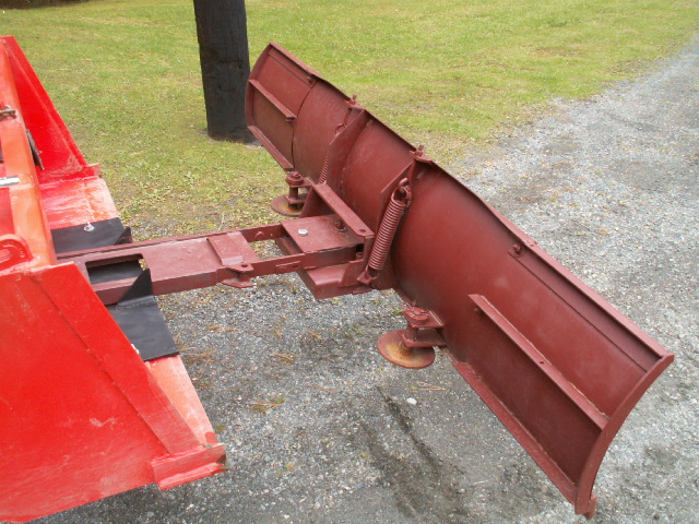

Not sure this will help but...pull one pin back away and ready for bucket use.

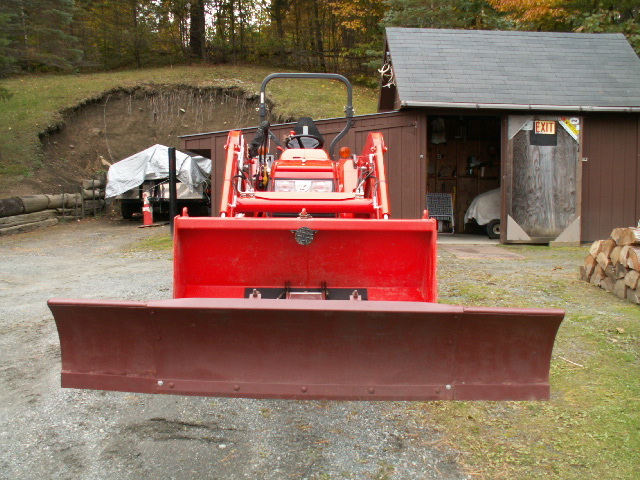

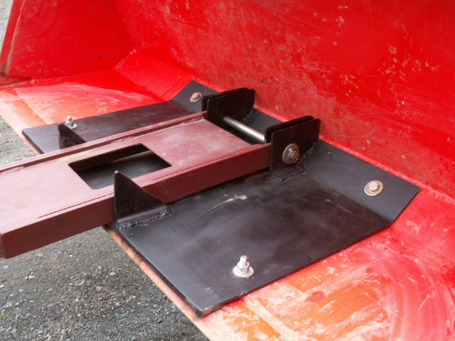

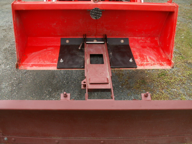

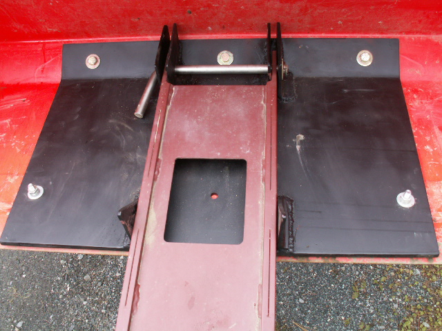

Old used blade rest I hot glue together,extended blade frame to match bolt in bucket push frame.
Man, adjustment,one pin hook up..works very well both deep or wet snow.
