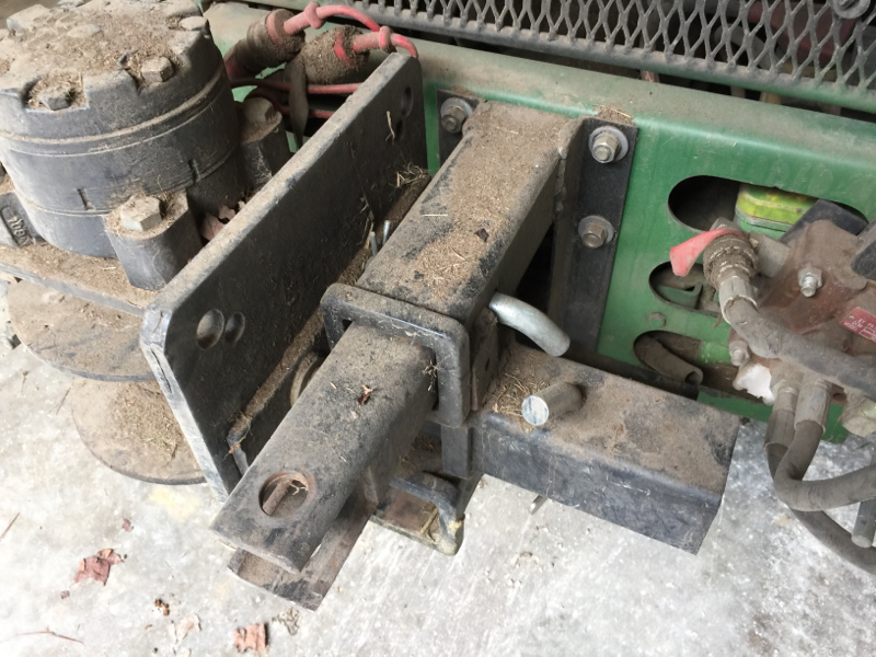

Looking to mount weight to the back end of my PT-422 to help keep it grounded when lifting with the bucket or forks. Have any of you did this before? Pictures please!

Several folks have put 2" receivers on the back of their 400 series Power Tracs. If I was going to add weight, I'd consider doing that. First, a 2" receiver can be really, really handy back there VS the pin hitch. You can make adapters for trailer towing, ball hitch, pin hitch, ring hitch, etc... Second, you could make a 2" adapter that goes straight back a foot, then weld on a section of barbell rod up vertically. Those are easily found at any junk store, goodwill, salvation army, etc... and then you can throw weights on the barbell and secure them with the barbell lock collar. Piece of cake! :laughing:
Anyhow, I'm reluctant to add any weight to the back of mine. I use the pucker as an indicator that I'm about to stress the machine. I wonder how much weight those center sections can actually take.

I've run loaded tires (winter-mix windshield washer fluid) on both my PT-425 and PT-1430. This small amount of additional weight on the rear makes a noticeable difference, and that weight is down low, not really changing the center of gravity for off-camber work. IMO, this is best alternative to add weight, and does not have additional things hanging off the machine for close-quarters work such as in the woods. The disadvantage is that it is a quasi-permanent mod, and you can't readily remove that weight when not needed. As far as I can tell, I haven't suffered adverse effects from loading the tires...
I also had a guy make me a rear weight/ballast/tool box for the 425 that would pin onto the rear pin hitch. I didn't use it a whole lot, because it would drag the ground when coming down off a steep slope onto the flatter ground at the bottom. I did use it considerably when moving the tons and tons of mulch from the lot clearing that I did, using the light material bucket hauling wet, heavy mulch. It was probably most useful for being able to haul chains, chainsaw, etc., into the woods. I'd often then remove it and set it aside while I worked...
